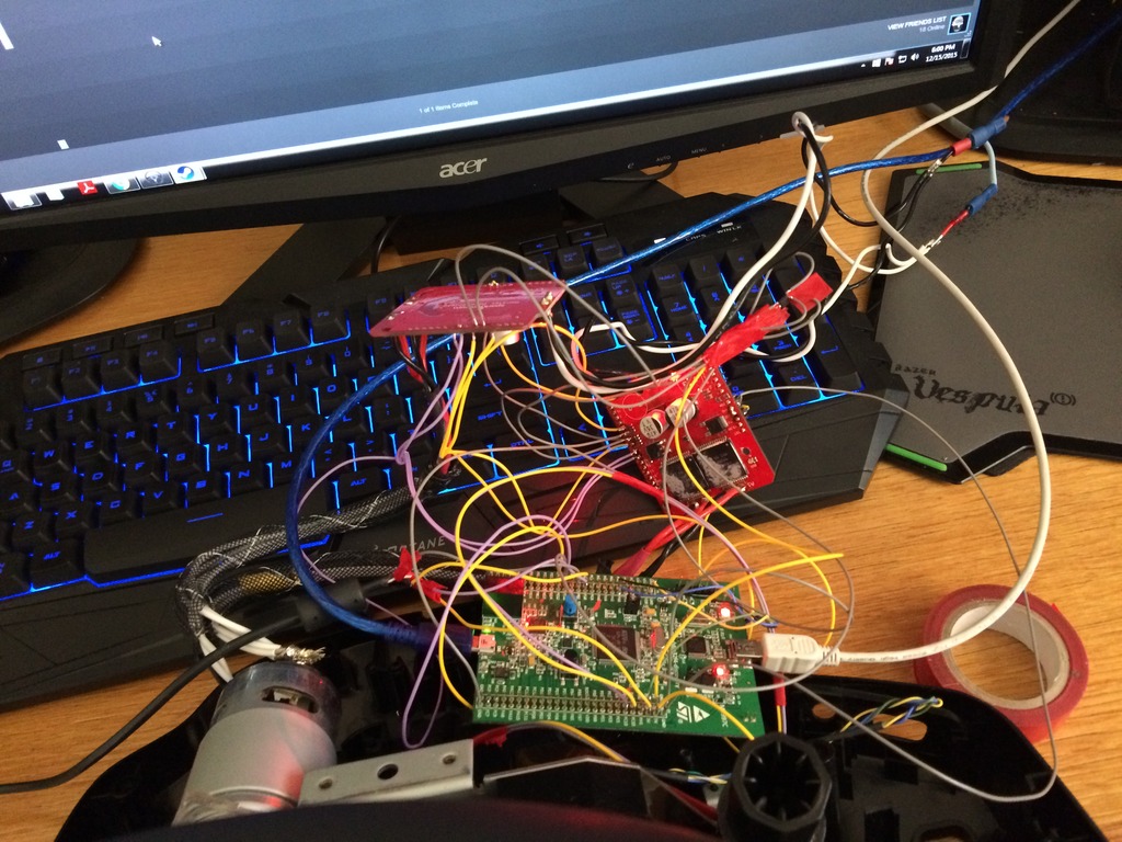

    Good news and bad news!
    I received the fanout buffers and connected all the PWM channels to the 2 MM.
    Bad news is that my wheel is now a rats nest and still over heats. The heating is no where near as bad and if I turn the power down I can manage a whole lap!
    One last thing to try would be a third MM as currently having two gives me 60A with the motor drawing on stall 57A (assumed). What I will try to do in the mean time is add the heat sinks and fans
    and see how effective they are. Also need to do a whole bunch of re-wiring to get things nice and neat again.
    Here is a video of 100% with two MM. I've turned down traction loss effects as it is just ridiculous and even still too powerful. You can see as I turn the corner I am really fighting the wheel. It is impossible to steer the wheel with one hand and try to video with the other. Eventually I will only run the FFB power at around 35% as this seems to be comfortable, responsive yet still powerful enough. 100% is just crazy with this size wheel.

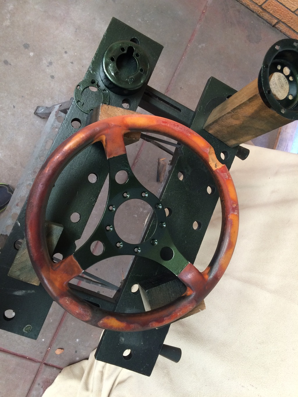

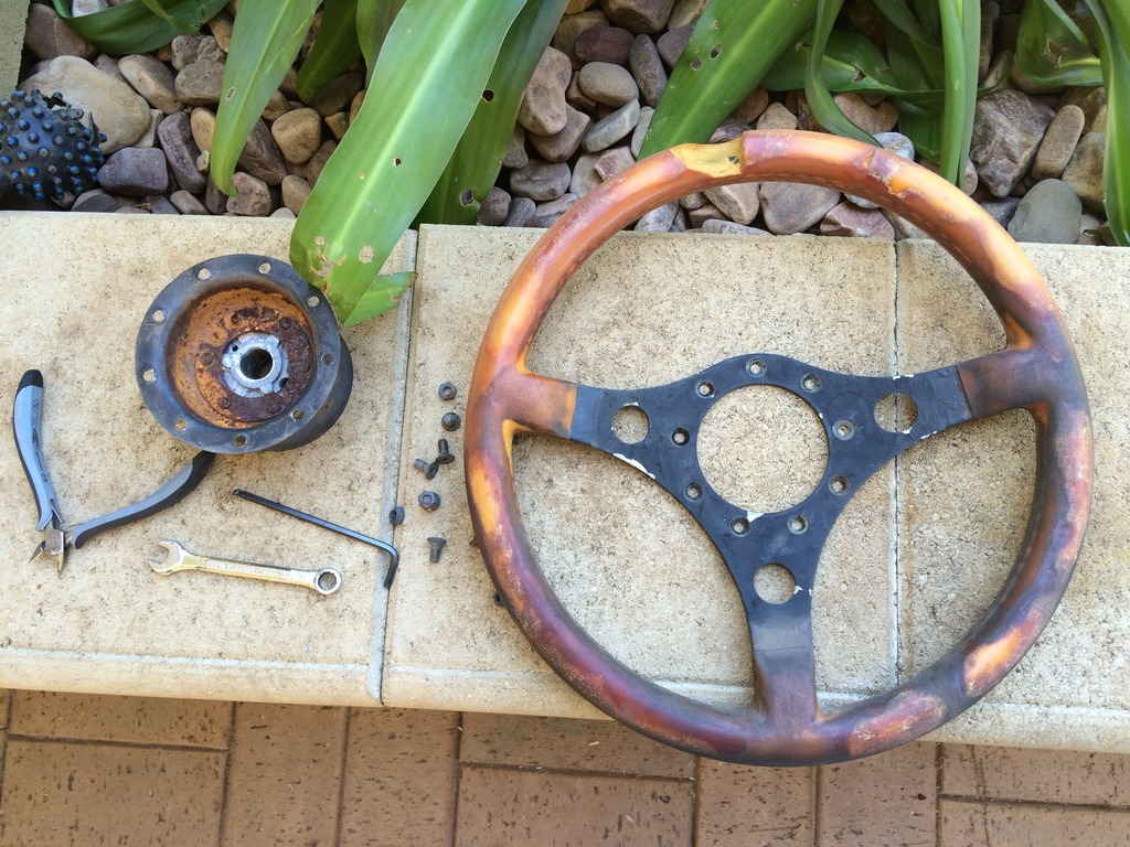

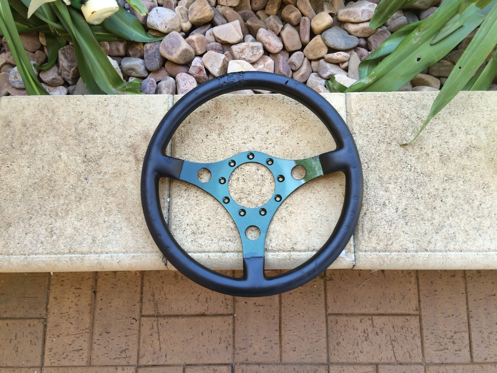

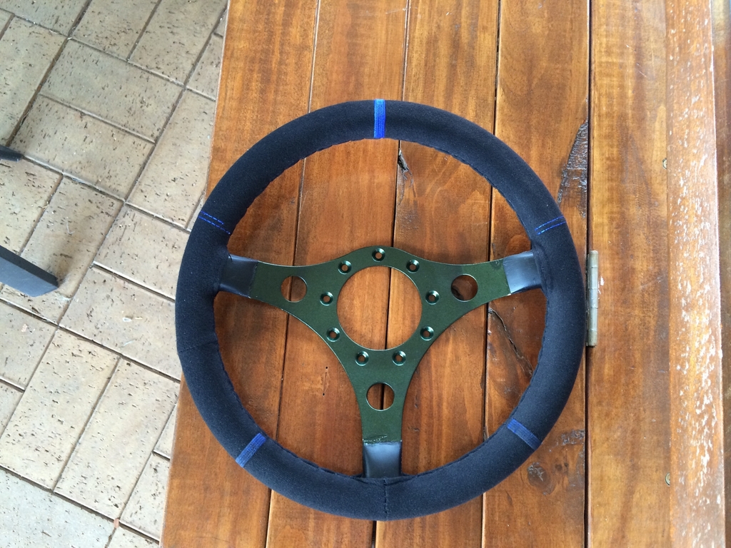

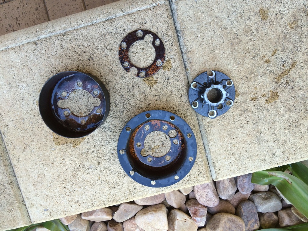

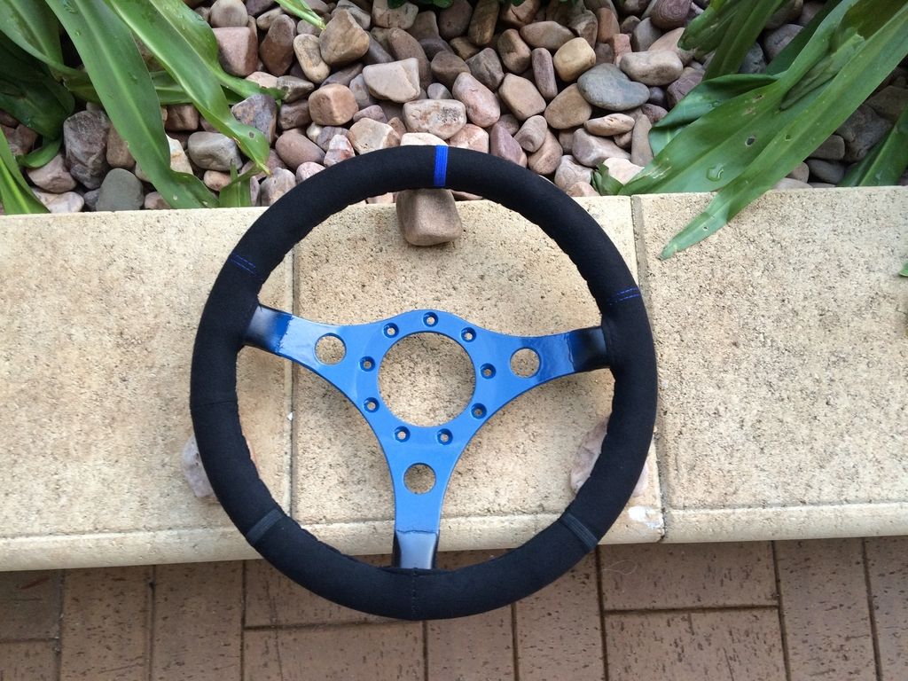

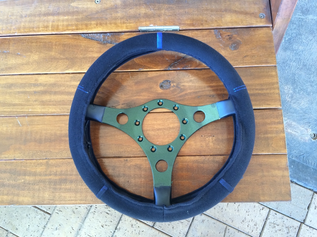

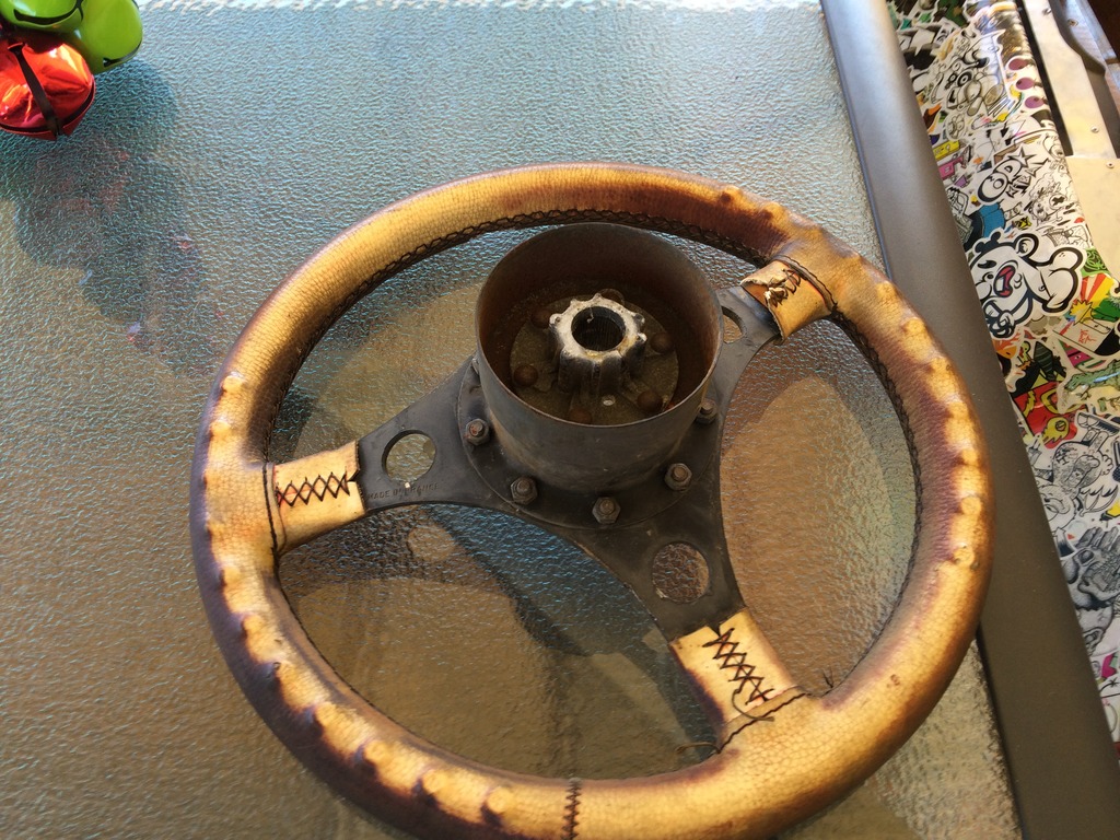

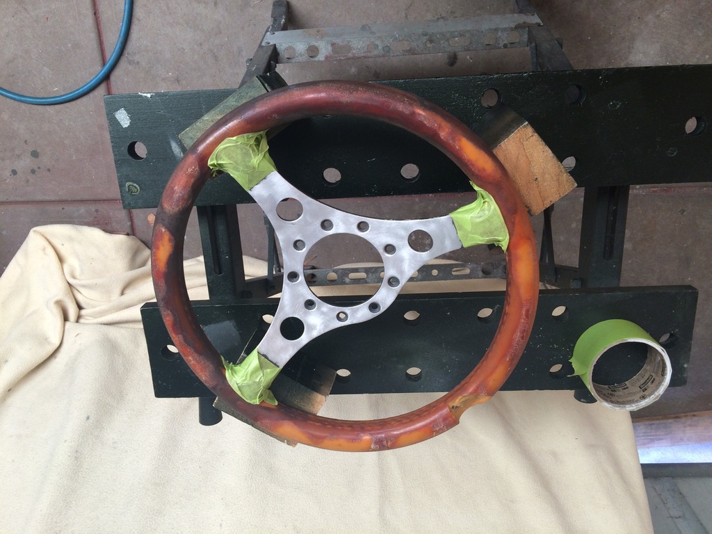

    A little bit of progress of the custom setup:
    Went down to the local wreckers to get some parts for my actual race car when I happened upon a Hillman Imp with a racing wheel attached.
    It is certainly is worse for wear but I got it for $15 including the boss!
    It's rusty and the leather/vinyl trim is degraded.
    Material taken off wheel and taken off of boss.
    Boss dismantled, sanded down.
    Wheel powder coat sanded off and prepped for spray.
    Wheel and boss kit sprayed. boss kit was rust/primer converted before spraying.
    I then decided to have a go at replacing the wheel cover. What I used was a 380mm wheel cover and re sized it down to 350mm to fit the wheel. I took out the rubber mebrane that the cover came with so that the new cover would mold to the wheels hand grips. I did this all by hand, first time hand sewing.
    I then decided that I like blue instead.
    Next I need to find a little bit more material to cover the rubber on the end of the spokes.
    • Like Like x 7

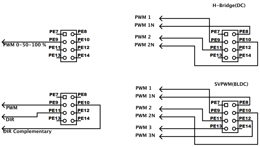

    For the MMos there are these modes listed:
    I am using the H-bridge (Dir/PWM) mode
    I have no idea how the other PWM modes are controlled.
    Also, speed is related to torque. So if you want to control torque you could run PWM at max (tied high) and then limit current to limit torque.
    In the end it would perform the same or similar as a PWM control.
