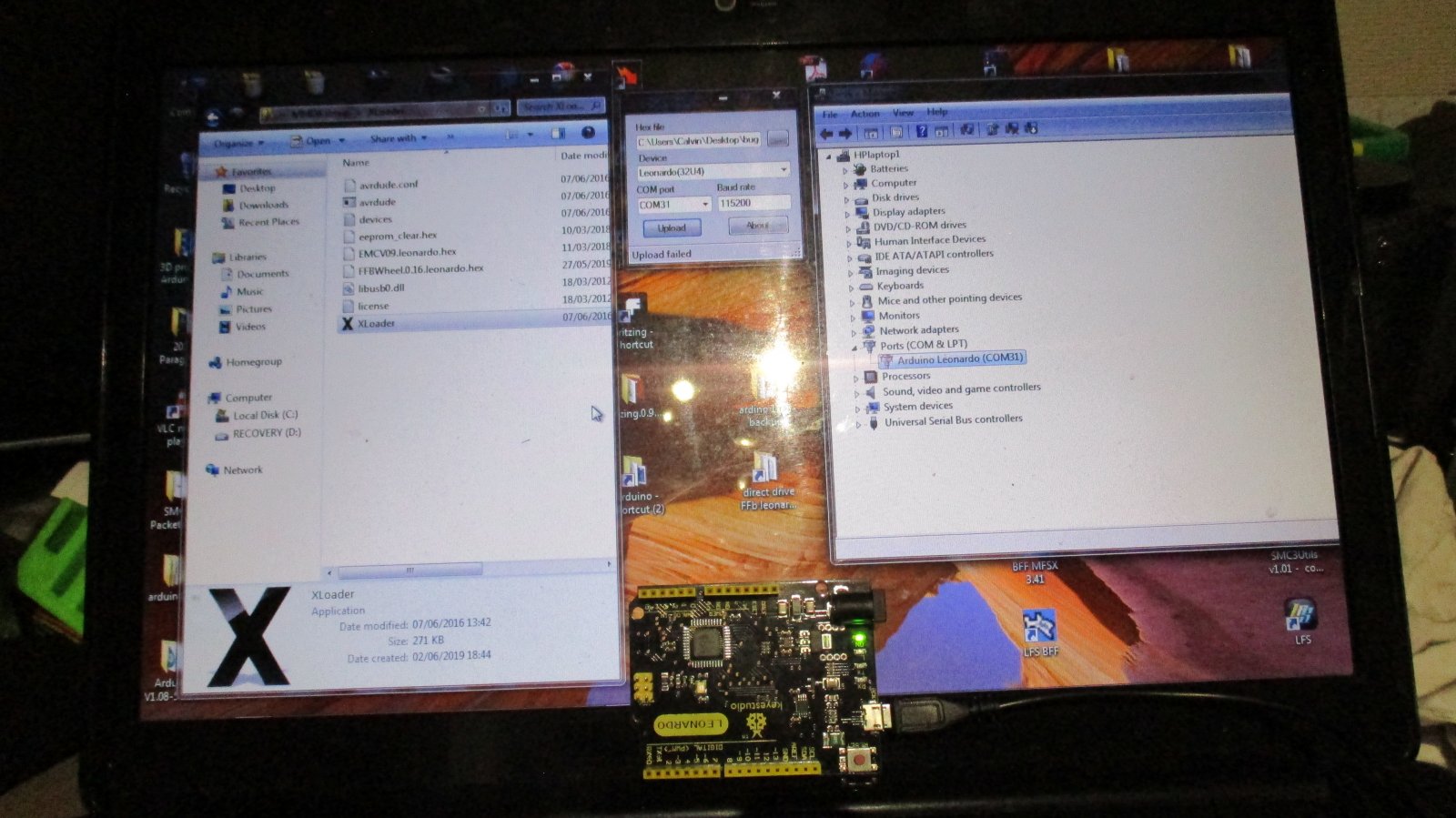

    Hi guys need some tips please , all electrics breaborded and just cant seem to get the DamM Xloader to download Firmware to the Leonardo , im sure I have followed the simple instructions on how to use Xloader But screaming sounds are now annoying the neighbour's.. ( That will be me then )
    No matter what firmware I try i.e FFBwheel.0.16.Leonardo.hex or the EMC equivalent , Xloader trips out as Upload failed , :-(
    I used the Ardunio IDE to confirm the Leonardo was ok? by just uploading the Blink test and everything complied and loaded OK :) small Whop of relief .
    so back to Xloade , Run Utility , Select Hex file , Check Com Port , Check Baud speed , Press reset , Device manager is open so I can confirm the Comport allocated to the Leonardo all good so far , now all I should need to do is press Upload and wait a few seconds for File uploaded and File Byte size should be displayed ( like a million vids on you tube show ) .......er in my case still getting Upload fail or says uploading but im sure it should not take 5 minutes to upload so I needed to press reset to jump out of Xloader ...
    Any tips would be appreciated , ( its supposed to be easy I know but as always it seems im missing a trick ) countless youtube videos and Forums Checked but still cant crack it ..
    Now gonna try a regular Ardunio Uno or nano now to see if its Leonardo related or not .. Damm I was hoping to spin up the DC motor version over the past weekend but getting square eyes trying to get over this hurdle ...

    I use a cheap “velleman” Leonardo, and I have not encountered any problems with xloader nor EMC. Windows 10?
    Could you screenshot settings? Do you get any error messages in EMC? Have you tried the latest EMC Lite?

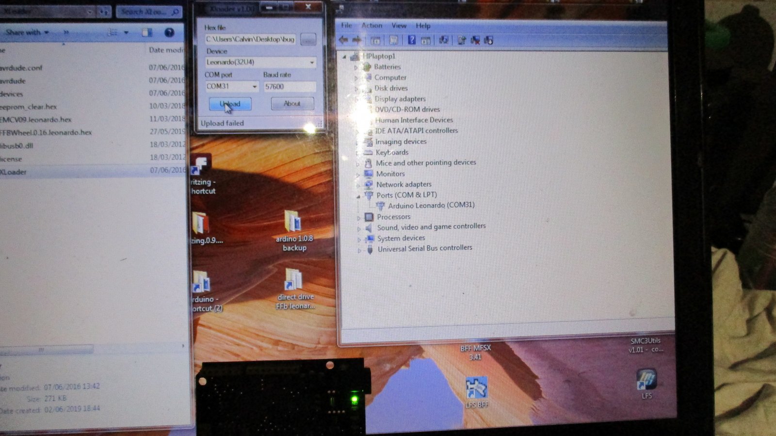

    Hi ya a few Pics of the test setu[ for Xloader , I often have these cant see the wood for the trees moments so if something jumps out please let me know . this is test is being done on my Windows XP laptop system , Trying to load MMOS firmware to Leonardo ( Ardunino Clone ) using X Loader Hex File transfer Utility .

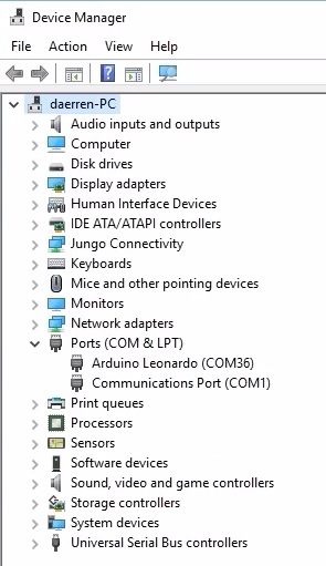

    If you look in Device manager you will see that the Leonardo changes com port number when it goes into bootloader mode. That is the number you want to use in Xloader.

    Hi Guys many thanks for giving a new area to check out , I did notice that when looking at device manager I saw the Leonardo address change briefly from COM 28 to Com 31 but then changed back to COM 28 .... thought this was just device manager trying to find a comport for the Leonardo..
    Gonna go have another attempt now I have calmed down LOL ,,,.. Fingers crossed guys :)

    It does that when you reset the unit. It goes into bootloader mode for 8 seconds. Just look what com port it gets and set xloader to that instead. It’ll solve your issue 100%-ish.. ;)

    YYYYYYEEEEEEEEEESSSSSS YE HA Baby sorted loaded OK and with Byte count confirmation so I can only assume this is a great step , massive thanks to the tips from you guys here, I would have never found that in a million years LOL ... I really don't recall seeing any info in the Xloader tutorial that explains the need to been in bootloader Comport when pressing upload .
    They said be quick and the need to press reset , But nothing about ( or at least I missed that bit regarding) Getting the timing right when Pressing upload ..

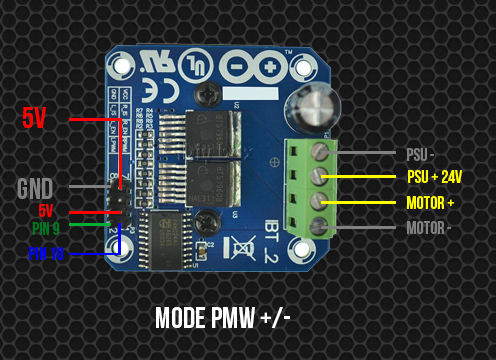

    I bought bts7960 and connected it to arduino like this:
    5v vcc
    gnd gnd
    8 l_en
    8 r_en
    9 l_pwm
    10 r_pwm
    but force feedback doesnt work. Do u know maybe why?(im using ebolz magy emc software)

    Connect/disconnect the board from usb. With every change of pwm frequency, you may also need this. Put the Constant Force slider to top or kinda.
    The EMC does not have desktop effects, otherwise you will switch on the wheelcheck for spring effects etc. But ffb will be in a game.
    Any questions fell free to ask.
    P.S. Where did you took that pin connections? That's wrong!
    Only need choose "pwm+/-" mode in EMC and pin, 9 & 10 for BTS from Arduino . LEN, REN to 5v from Arduino. Look the EMC video on connection......

    The new FW has desktop effects. (Or maybe just Pro?)
    The wiring is correct with newer firmware. Connecting the L&R enable to constant 5V will give you a sort of cumulative resistance. Setting them to pin 8 takes that problem away and let’s you “freewheel”.
    Try loading the default profile, it’ll give you a good starting point. What Arduino are you using?
