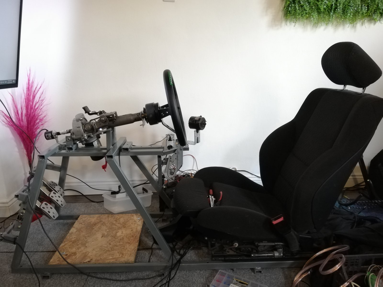

    This is mine;
    Made it from a scrapped hoverboard

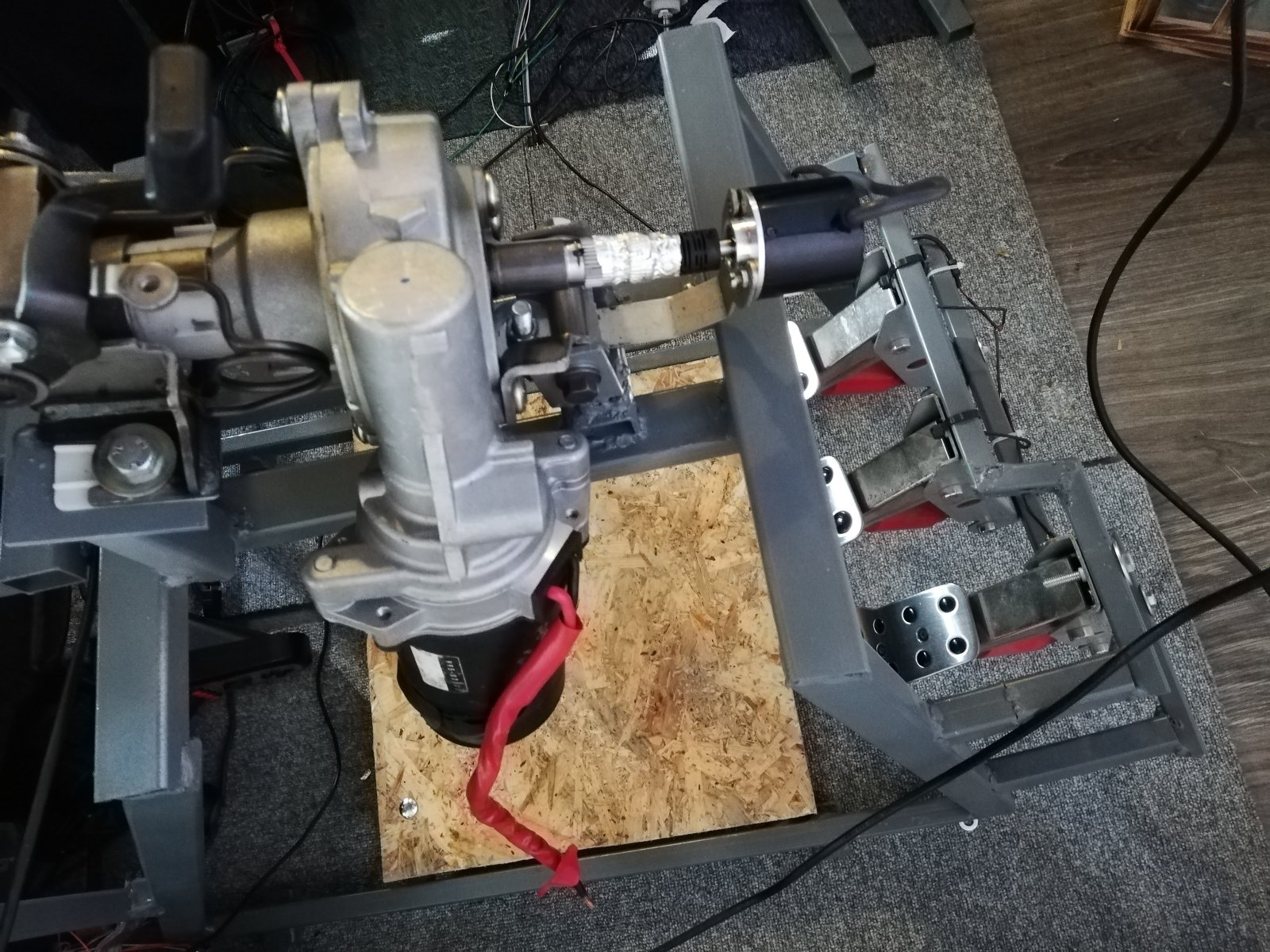

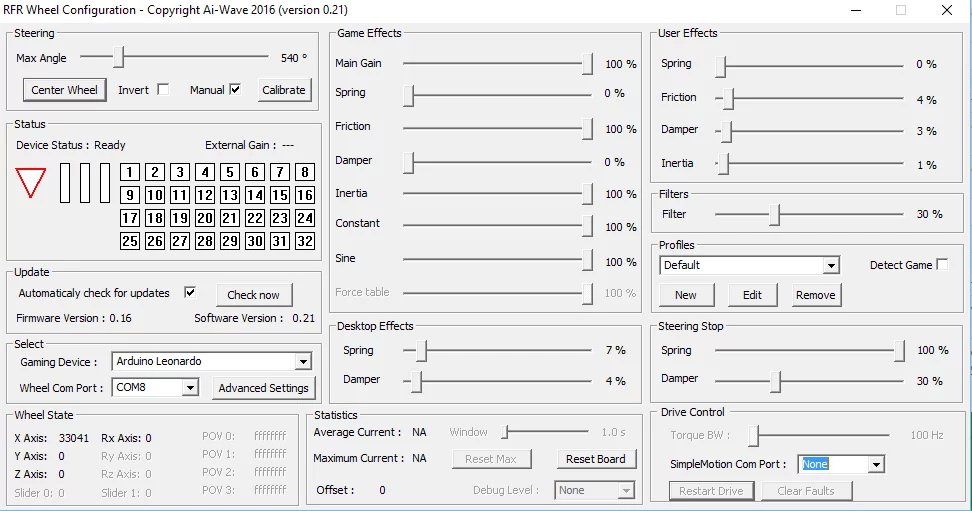

    I started a project inspired by tomthomas21's build and other nice projects. I used the whole steering column from a 2003 toyota (massive reduction, I know, 15:1) and an omron encoder copy coupled to an arduino leonardo and two bts7960 in parallel. Couldn't get the wheelconfig 0.21 to work properly and went for EbolzMagy's EMC Pro which is a very nice tool.
    The problem is I only get a constant force like a damper, no centering action no other forces. I'll try to explain better, as I don't know a lot about FFB. For example, it's almost impossible to catch the car when the rear slides, it's the same in Assetto Corsa, Dirt Rally 2.0 and Rfactor. When I try to countersteer the wheel opposes that, instead of becoming light, like in a drift car when you can just take your hands off the wheel and it will go in the right direction, thanks to caster. Also, on straight lines there is no centering action, if you turn the wheel it will just stay in that position. I tried inversing polarities and re-checked the wiring about a million times.
    Also the Wheelcheck tool doesn't work, it doesn't do anything.
    EbolzMagy's advice is to replace the arduino with a blackpill stm32, which is on the way.
    Any thoughts are welcome.
    Thanks!

    Hey Petrolhead!
    I would try using just one BTS to begin with. It sounds like they could be working against each other.
    What happens if you put power straight to the motor? Does it turn?

    Hi Chris,
    Thanks for the input. Yes, tried both ideas, running only one bts didn't change anything. Regarding the motor, I became a little suspicious and tested it too. I wrote a sketch and managed to control the motor with a potentiometer and it worked properly.
    I did a lot of fiddling around before, but in a previous itteration it did do something else, when I was using an hp printer encoder and the wheelconfig. Wasn't doing what it should have but it nearly broke my hands. Couln't get it to work with the new encoder in that software though.. Last time I tried it only saw half of the rotation, the positive one 0 to 32k. It is a three phase encoder, model is A6B2-CWZ3E-1024 and it seems to work great with EbolzMagy's sofware.

    So, the rotation works, but the feedback doesn’t? If you put the motor test sketch back in it still turns the wheel?
    And a stupid question, but guess why I know, did you turn the power in EMC up?

    Yes, rotation works, but I only get constant force, redid the test with the arduino sketch.
    I am waiting for the blackpill to arrive, but I think it will be at least a week. Are you referring to the fader labeled strength? I dialed it down actually to under 10% because the thing is very powerful, wants to break my arms :oops: The 15:1 ratio might have something to do with that...
