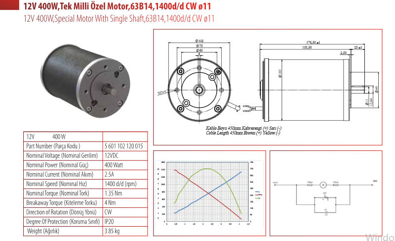

    2DOF, 3DOF, DC motor, Arduino, SimforceGT

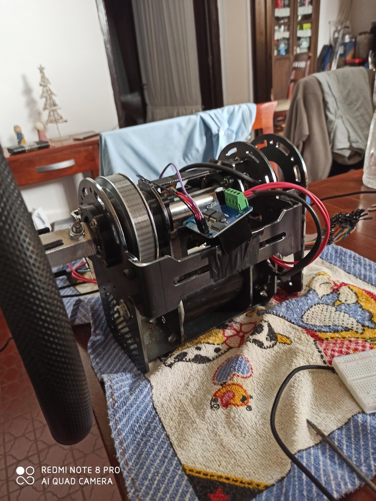

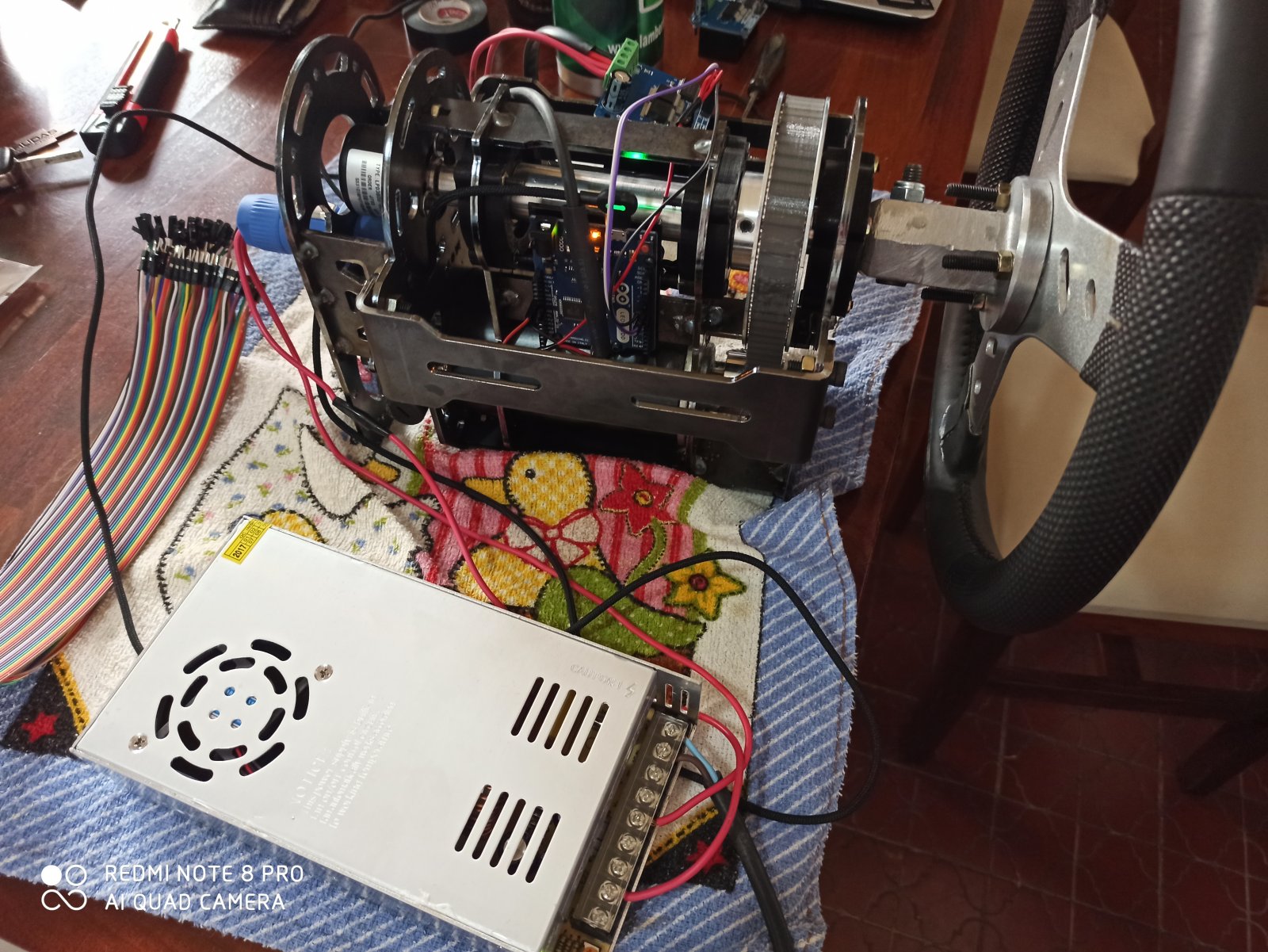

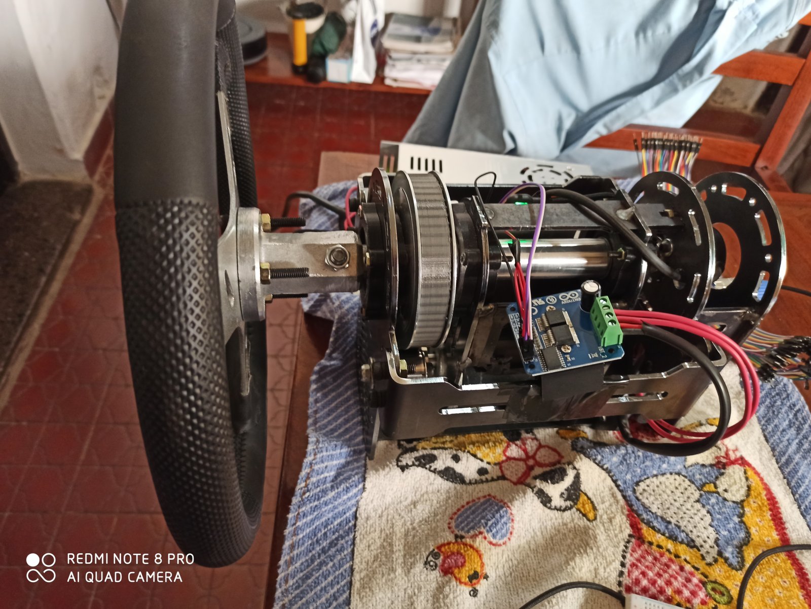

    Hello everyone!!
    First of all, thanks for sharing your projects, everything is very interesting and they have generated great motivation for me.
    I have the project quite advanced, but when configuring the steering wheel I have some doubts.
    It happens that I cannot properly center the steering wheel with wheelconfig. I don't know if it is an electronic problem or a mechanical problem as my system works with pulleys to amplify the force of the cc motor. Probably the firmware can't center the steering wheel because it doesn't work 1: 1.
    Sent some component data:
    - Arduino Leonardo board.
    - Bridge H - IBT_2
    - 600 ppr Chinese encoder.
    - 150W / 12VDC / 1800 rpm motor
    - The reduction is 4: 1.
    I send images of the project.
    I would appreciate your help to finish setting up. Thank you!!

    I also have no answer when testing the external forces of the "iracing force feedback test 1.72". As if the electronics were not sending orders correctly to the cc motor. I hope your help, thank you very much. Health!!

    Pal, forget about wheelconfig. Use EMC software for Arduino then. And all will be good. )

    Hello everyone! Follow the advice of sieben and install emc. It really is much easier and more stable. But now I'm having trouble with the IBT_2. I'm already burning two. Probably someone has already happened and can help me solve it. Thank you!!
