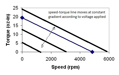

    Torque is generally at it's highest at 0 rpm (theoretically) and drops off with more rpm. PWM controls the voltage level applied (less on time) thus reducing torque.
    On this graph, imagine that the lower line is PWM at lowest duty cycle and top line is PWM max duty cycle. So with FFB wheel being on stall most of the time you have maximum motor torque all the time.
    PWM then reduces the torque by effectively dropping voltage which in turn drops current which drops the torque. No need to "re-invent the wheel" (no pun intended).
    My understanding:
    Less FFB strength responses = less PWM duty cycle
    High strength FFB = higher PWM duty cycle
    So the PWM isn't necessarily controlling the speed of the motor because speed is always at minimal anyway. I'd say the PWM for FFB is in fact a torque controller.

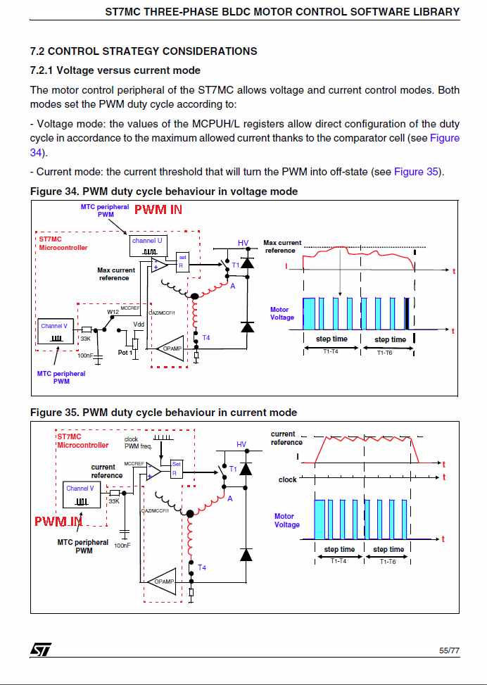

    Maybe this page from STM will explain, although aimed at a 3ph bldc the principle is the same.
    Basically, the current sense circuit acts as a PWM duty cycle manager in current mode while
    it acts as a maximum current limiter in voltage mode. The current loop allows a fine control of
    the torque by imposing the current in the windings.
    Voltage mode can be used when there is a high torque variation.

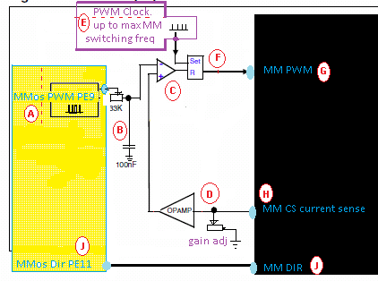

    While the current control could be done in the stm32, MMos would need to program for it although I think he did plan to use cs but the Argon has torque control mode and that made it so the current control wasn't needed on MMos.
    Torque control done external to the controller MMos and motomonster h-bridge.
    While I could probally make the circuit learning along the way, I thought Alexey could implement a lot easier having the expertise , boards and equiptment on hand.

    A- MMos PWM output.
    B- cap to avg pwm to give analog voltage
    C- comparator
    D- op-amp gain, adjust max amps
    E- Clock, this might be what mizoo mentions as motors time constant
    F- Latch? not sure what this is called but reset will block off the clock signal
    G- Input to H-bridge PWM
    H- CS low side current sense of H-bridge
    J- Dir from MMos to H-bridge
