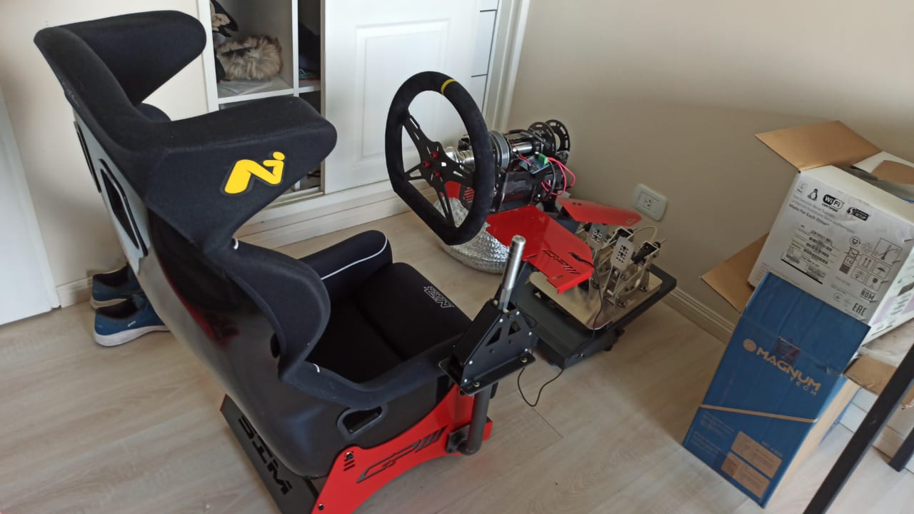

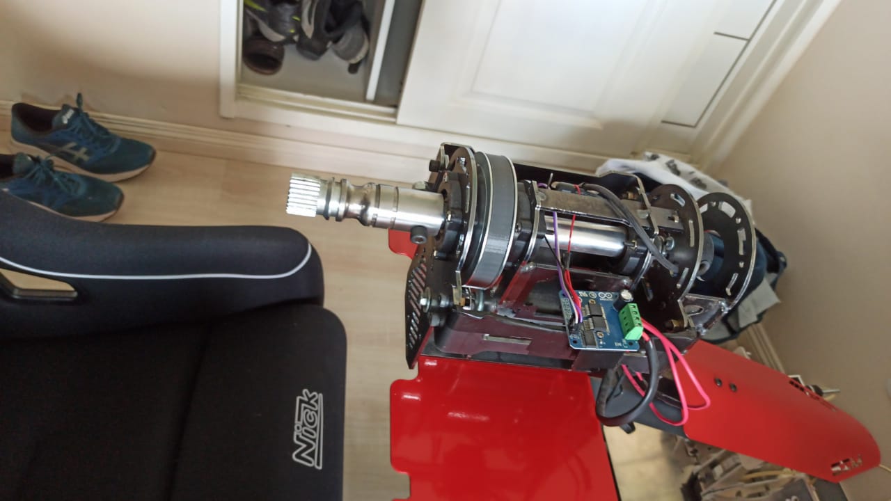

  6. juanpro91
    juanpro91 New Member
    Dec 18, 2020
    7
    112Coins
    AC motor
    Hello friends!
    Again turning to you for help.
    I already have everything configured, I have tested the steering wheel and it works fine ... but the problem is that the bts7960 driver burns easily.
    What can i do to fix it?

  8. ZipRacer
    ZipRacer 2dof full frame + seaparte L&R seat mover
    Dec 31, 2017
    25
    phils
    63Coins
    3DOF, DC motor
    Hi Petrollhead49, Zip racer here,
    I am very much interested in your project of using an actual eps from a car. I have exactly the same eps model as you. I counted the gear ratio of a g29 motor pinion to main gear and it is exactly the same turns as the EPS motor shaft to steering wheel shaft..a happy coincidence. I got a surplus G29 with a working board but dead motor. I relocated the hall sensor based counter and its magnet from the G29 motor to the back of the EPS motor...more of a mechanical challenge than electronics as i did not change any of the circuits...just relocated the sensor. Note the polarity of the magnet and the distance between the magnet and the IC top when relocating. Doable with patience and imagination and 5 minute epoxy. To drive the EPS motor, I used the motor output of the g29 board to drive the input of two back to back optocouplers...and since the g29 no longer drives the original 2 motors, I now feed it with 12 volts instead of 24. And to avoid the optos leds being fried by too much current , a 10K resistor is placed in series (calculations actually put it at just over 1K ohm but I am being very careful at the moment so 10 k is a bit of an overkill maybe). The output of the opto is fed a 5volt dc from a dc down converter board tapped to the 12 volt supply. This 5 volt also feeds the IBT2 control circuit. The 12 volt supply drives the IBT2 and the eps motor which is also 12 volts (cars use 12 volts, right?). Now the EPS motor is rated at 80 amps as it needs to move the front wheels of over a ton of a car...but a steel full-frame mover sim is nowhere near the weight of even two car wheels, so I figured the IBT2 will have enough amp rating at 40 amps. I figured, at 12 volts and pulling 10 amps, the eps motor will output 120 watts which should be ample but not powerful enough to rip your wrist or arm off. The other challenge is how to mechanically stop the motor as it self calibrates..remember the G29 self calibrates by turning fast to the left, stop after 1 1/2 or so turns as it hit the mechanical stop, reverses direction until it hits the opposite stop, calculates, then centers. Now, how do we make the EPS motor do that? What I did is attach an all thread shaft to the opposite end of the main eps drive shaft (opposite side to where you mount the steering wheel), a bolt is placed in the all thread which moves up or down as the steering wheel is rotated right or left. This bolt will hit a stop after completing 1 1/2 turns to either side and when it hits the stop , it will open a switch which connects a big resistor in series with the EPS motor circuit. This causes the EPS motor to weaken considerably (less current coming in due to the big resistor in series at that point) and stop at the switch without breaking anything (EPS motors are really strong). As the motor stalls, the sensor attached to the motor shaft end stops sending impulses to the G29 main board, which interprets it as the original mechanical stop. The board then sends the reverse motor signal which causes the motor to reverse full speed as the switch closes and takes out the series resistor.
    I used the motomonster board the first time around and found it very difficult to control. So after more readings, I came to the conclusion that the IBT2 board is simpler to use and more powerful. What I did is connect Len and Ren to +5 volts, and the Opto outputs to LPWM and RPWM pins of the IBT2 board. I am rewiring the setup at the moment so am not able to test yet.
    To summarize, I am using the main g29 board as/is to drive the EPS motor thru the IBT2 board. The EPS that you and I use have the same gear ratio as the g29 motor pinion to main gear ratio! verify by counting actual motor shaft rotations to steering wheel rotation of the EPS..and G29 motor shaft rotation to steering wheel rotation. they should be the same.
    P.s. I also used a cpu heat sink as described in this series...but mounted the copper side of the board to the copper side of the heatsink...used a silicon heatsink rubber tape to insulate the baord from the heatsink and prevent shorting. Good idea. Plus side to this is the cpu heat sink fan uses 12 volts supply also.
    I am looking forward to testing once rewiring is completed.
    I am using a switching 240 watt 12 volts PSU. Hope it will give enough juice for the EPS motor? If not, I will parallel a lead acid battery.
    The only downside I can think of at this time is weight. The EPS alone tips at almost 8 kilos without the steering wheel.

    It burns likely because it is shorting at the bottom (copper foil side of the circuit board) of the board and the uninsulated heatsink. Try separating the board from the puny heat sink by removing the 2 bolts. See how precarious the insulation is between the board and the heat sink (the chinese designers know this will fail but could not care less as shorted boards mean more orders and cash). As these 2 surfaces heat up, the likelihood of shorting increases. Solution? Try using a silicon tape like heat conducting insulator between the back of the board and the heat sink and tighten the board to the heat sink in their previous arrangement. Unless you repeatedly subject the IBT2 to heavy overloads, it should survive given its 40 amp capacity...unless you run everything at max...max voltage , max amps continuosly ...then it will surely die, pronto.
  10. ZipRacer
    Dec 31, 2017
    25
    phils
    63Coins
    3DOF, DC motor
    looking at your set-up I can see you are using the IBT2 as it came from china...like a ticking time bomb ready to short at the bottom anytime...if you look at the motor output trace at the bottom of the board, you will see that both traces are connected at the bottom copper traces directly under the main driver ics on the top side. both copper traces are insulated by the green colored resin from shorting with the heat sink...that thin layer of resin is all you have protecting the IC outputs to the motor from shorting via the heatsink surface as these two surfaces heat up during operations...pls confirm by checking the bottom copper traces of all your burned IBT2s to validate or debunk this theory.

  12. Sieben
    Sieben Active Member
    Nov 6, 2018
    395
    2,241Coins
    +115 / 2 / -0
    The do not burn due to the this short. Just stop working. And when the short is removed, work as usual.
  13. ZipRacer
    Dec 31, 2017
    25
    phils
    63Coins
    3DOF, DC motor
    Thanks. Glad to know. Could be the built in protection circuits of the chip triggering. It comes back on once a fault condition such as over current or high temps is reduced or resolved. Good luck. Cheers.
