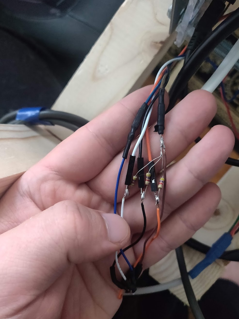

    So, I also use the emc software along with stm32 f4ve board. And i'm having problems with the wheel keeping his center. Everytime I unplug the board from the pc, i have to redo the wheel center and sometimes in game the center is sliding sometimes with 4 degrees, sometimes more.
    I use the OMRON E6B2-CWZ6C 1000P/R encoder. This is the wiring i did, the resistors are 4.5kohm

    4.5k can be too much in a 5v line. Use 2.2k. But not too much less also. Will sag the voltage of a controller then.

    I have 1k pull-ups and no issues so far. I usually use 1k pull-ups and pull-downs in my circuits and never had problems.

    Yes. Ordered from Alliexpress, not sure if real omron or not, looks legit. Does the drift occurs randomly or it happens when turning a wheel? I had similar problem when real position drift away from sensed position in one direction after turning wheel. I was able to track it down to lose connection of A wire (on stm32) from encoder resulting in missed pulses :)

    Thing is, untill measure the voltage. It can work fine, but has a voltage sag anyway. And it's better not to have it)
    Centre loose occured with 2channel encoders. Doesn't get saved. It's not a big deal. Also, don't unplug the encoder. If so, u've to replug the controller usb too, with plugged in encoder beforehand. Better use soldering connections if smth too.

    Drifting occurs only when turning from left to right. Sometimes it works as intended, not drifting. I tried with an arduino leonardo board, plugged the encoder directly, without resistors and works without problems.
    Yeah, i don't mind that if I unplug the stm32 board from the pc i have to calibrate the center again, what really bothers me is that after calibrating in software, and saying that z index found and all that and i get in acc, driving a little bit and the center drifts to the right. If i keep the wheel straight, it's not drifting, but if i move right, left and right again, it drifts a bit.
    LE: I put the 2.2k resistors and for now seems to be fine. Thanks a lot for the help :D

    Ok, same problem again. Another thing i saw was that if i move the wheel slow, from left to right there is no drifting. But if i move it fast, the led D2 from the smt board blinks, and then the drifting occurs. I can't understand what is wrong.

    Replace the wires for encoder. You have bad contact. Replug stm everytime you disconnect the encoder too.
