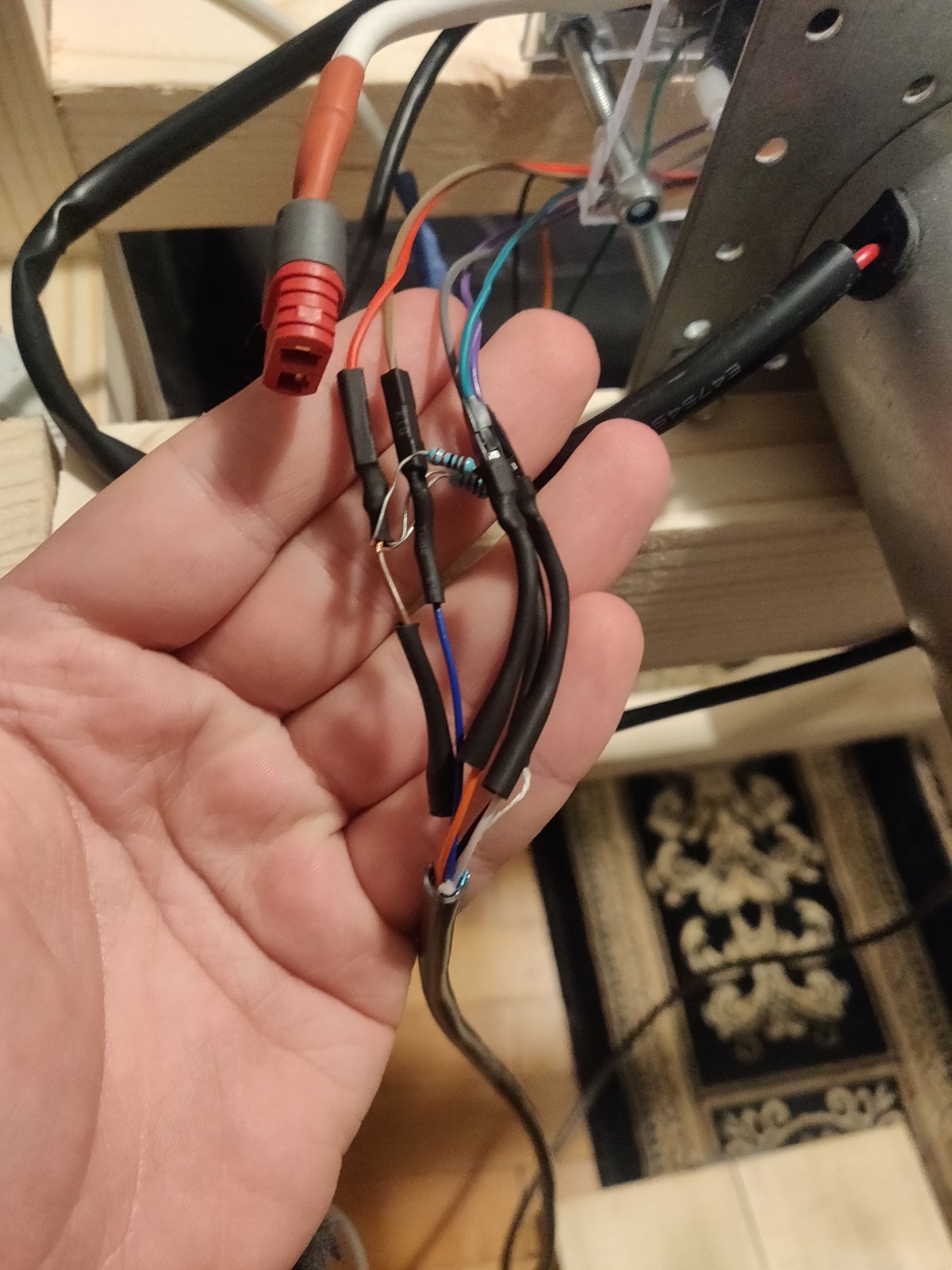

    I saw somebody soldering the resistors directly in the encoder housing. Would that be easier?
  2. Sieben
    Sieben Active Member
    Nov 6, 2018
    395
    2,241Coins
    +115 / 2 / -0
    Not especially.
    Thing is in the whole wire connectors.
    Any photo of the layout? Secure the wires after all is set with hot glue anywhere in around.
  3. Francisc
    Francisc New Member
    Dec 26, 2020
    17
    90Coins
    DC motor, Arduino
    Can the dupont cables be at fault?
  4. Sieben
    Nov 6, 2018
    395
    2,241Coins
    +115 / 2 / -0
    Yes, loose connectors first of all.

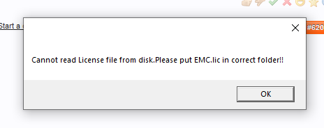

  5. Rad07
    Rad07 New Member
    May 23, 2021
    34Coins
    Hey, following your post I bough this soft but when i start the program i get this error, do you know where i can find this file? Maybe I have to ask the dev for it?

    I changed them, soldered them on the board, still the same problem. Can there be something wrong with the board?
  7. Sieben
    Nov 6, 2018
    395
    2,241Coins
    +115 / 2 / -0
    Don't know, but hardly.
    Bad electrical encoder connection, looks like mechanical loose connection from shaft to encoder. Although, it looks alike really, check the mechanical part too.

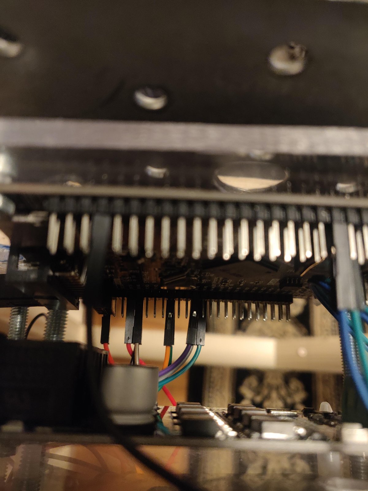

  8. Francisc
    Francisc New Member
    Dec 26, 2020
    17
    90Coins
    DC motor, Arduino
    I switched to an arduino leonardo board, and EMC lite software. I did some test, it's working good until now, no drifting. MAybe the stm32 wasn't geting 5v, idk. I ordered a smaller stm32 board, but until that arrives I will stay on the arduino
  9. Rad07
    Rad07 New Member
    May 23, 2021
    34Coins
    Didn't noticed the dev explained everything in the mail, it's fixed.

  11. Francisc
    Francisc New Member
    Dec 26, 2020
    17
    90Coins
    DC motor, Arduino
    If I connect the encoder to 3.3v I don't get a signal at all
    I tried soldering the cables from the encoder directly to the stm32 board, still the same problem. Now i'm using an arduino leonardo, with EMC lite and have no problem, I set the center everytime i connect it to the pc, but the center remains centered no matter how long I play, or how hard i steer the wheel. I ordered another stm32 board, maybe it was something wrong with mine. Will let you know when I get it. Hope that solves the problem, but I don t have a lot of hope :D
  12. Michelle
    Michelle New Member
    Sep 16, 2021
    29
    251Coins
    Truth is that encoder should not work at 3.3v as it is below minimum voltage specs. Why mine does work? No idea :D
    Reason for running it at 3.3v is that smt32 is 3.3v logic but it should be 5v tolerant but I didn't have any concrete proof about that so I rather not want to take a risk. I had prepared voltage shiter for encoder in case it would not work at 3.3v and it had to be powered at 5v.
    It is very possible your smt32 was somehow damaged, after all switching to different board seems to fix your issue.
  13. elnino
    elnino Active Member
    Apr 1, 2010
    245
    Computer Geek
    Adelaide, Australia
    1,551Coins
    +138 / 1 / -0
    The pins used are 5v tolerant. Not all of the STM pins are though - Specifically excluded are the ones that can do ADC and a few others.
    I would have thought that if the STM32 @Francisc has was damaged, there would be no signal at all. It is odd that the Arduino works fine though. You are gambling a bit with chinese quality though - For the price these boards are, it's worth getting more than one anyway.
    One thought I did have though - On the V1.06 F103 (and possibly 1.07) version, there is the option for a manual centering button, if there was noise on this pin (left floating) it could falsely reset the center. I know when I was testing with F103 i'm pretty sure I had to pull the pin high and the button would make it low.
  14. Francisc
    Francisc New Member
    Dec 26, 2020
    17
    90Coins
    DC motor, Arduino
    This is just mind boggling. I just moved the wiring from the arduino board to the stm32. The only difference is that I did not connect the Z cable, and now it's all good, from the test I did (a few laps in acc).
    Maybe the z was the problem? I don't know, but I'm glad that it just works for now. Thanks a lot for the help.
