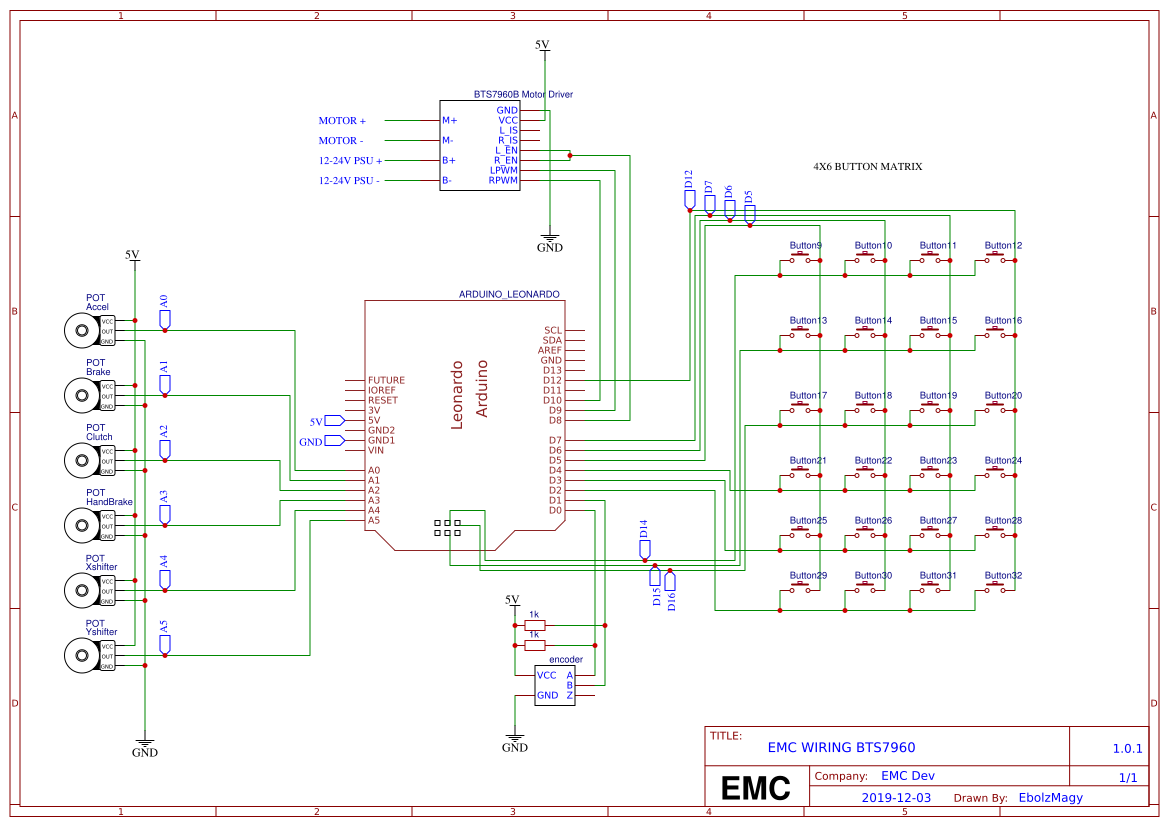

    2DOF, 3DOF, DC motor, Arduino
    yes I think you should consider to use EMC software.
    I have the lite version to work with arduino leonardo and it's a free version.
    if you want to get more serious and proper wheel, you can get the STM32 board, and EMC pro license.
    hope it can be help to get your first DIY wheel.

    And how's the wiring and the programing with the STM32, is it as easy as the Ardu Leo ?
  5. itsumairu
    itsumairu Active Member
    Dec 13, 2021
    210
    Psychologist
    Indonesia
    440Coins
    +92 / 2 / -0
    more or less its the same. you just have to follow the wiring instruction.
    what I share is the lite version. its using ardu leo.
    for the STM32 one, you much get the pro version.
    here I attach some schematic wiring.
