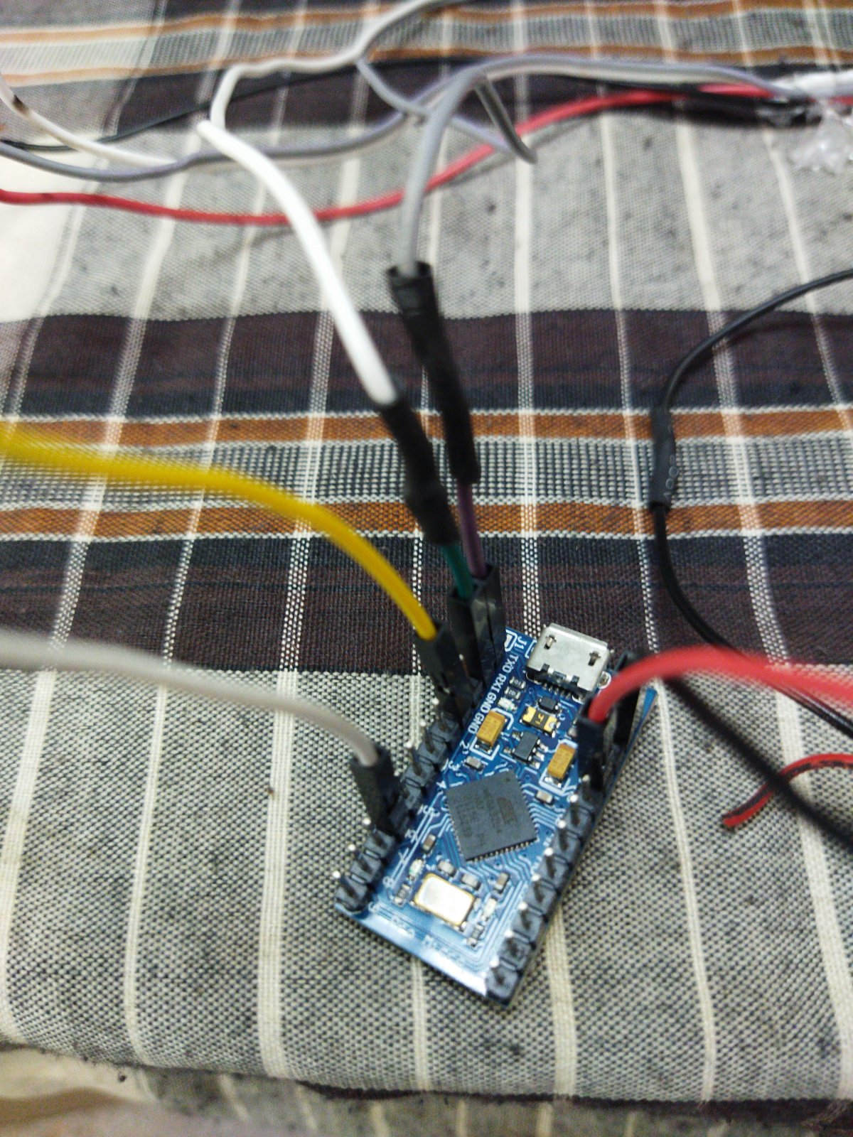

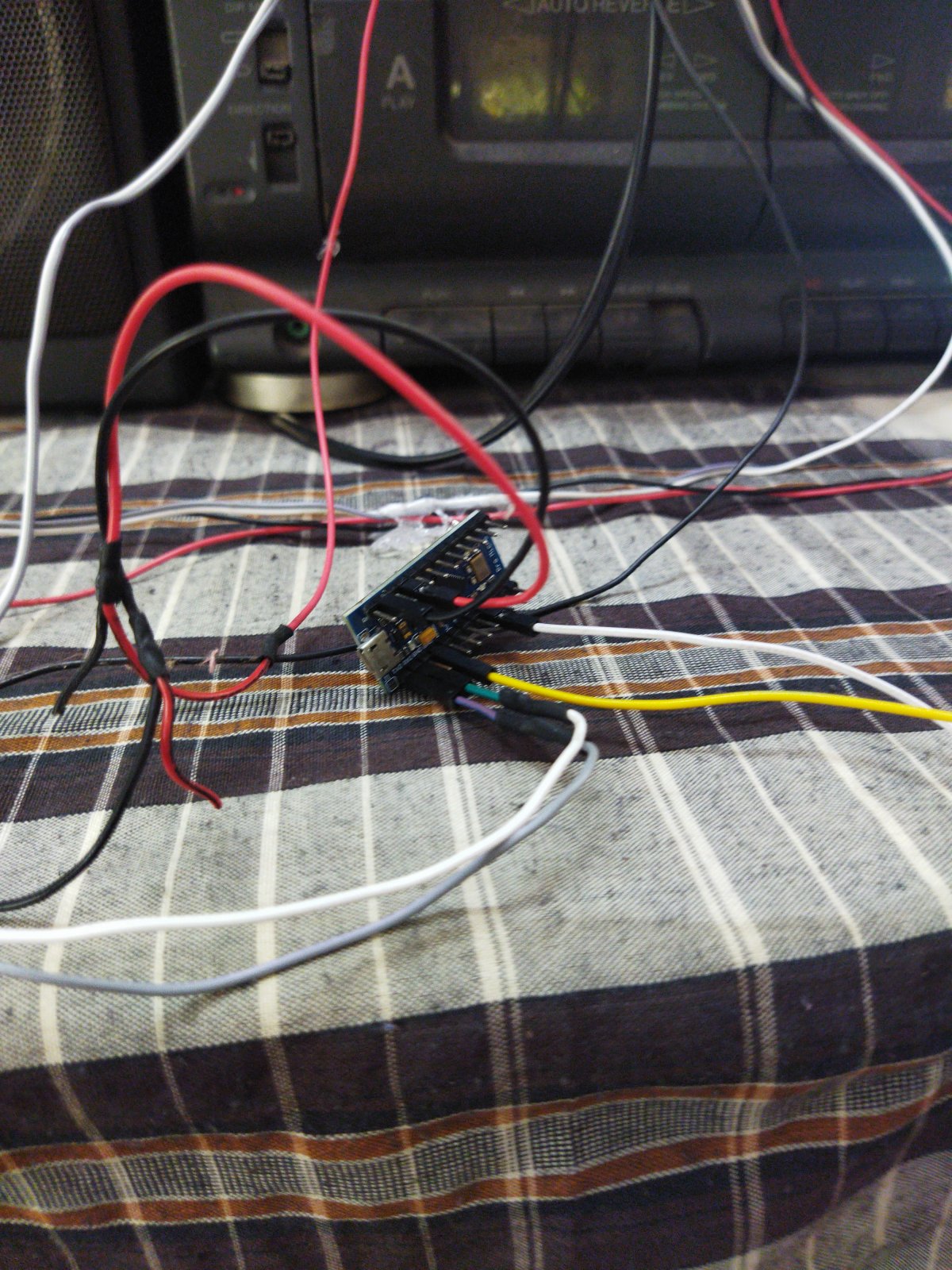

  15. Abishek Y
    Abishek Y New Member
    May 15, 2023
    10
    65Coins
    DC motor
    Hello I use mitsumi M25N-2R-14 2241 encoder with motor I can able to turn middle to left and left to middle but not able to turn right side
  16. elnino
    elnino Active Member
    Apr 1, 2010
    246
    Computer Geek
    Adelaide, Australia
    1,557Coins
    +139 / 1 / -0
    How is that anywhere near enough information for anyone to be able to help?
    Controller board:
    Firmware:
    Wiring (pictures)
    Why use this motor?
    What is it normally used in?
    Perhaps the origin of this motor causes it to have a 'home limit'?
    I would start by going 1 full turn left, then use the Z button to zero the wheel, then see if it will turn right. I'd be suspecting that the motor encoder has some extra smarts.
  17. Abishek Y
    May 15, 2023
    10
    65Coins
    DC motor
    Controller board:Arduino leonardo pro micro
    Firmware:RFR wheel config
    Wiring (pictures):I use the same wiring given above
    Why use this motor?it is cheap
    What is it normally used in? Printer

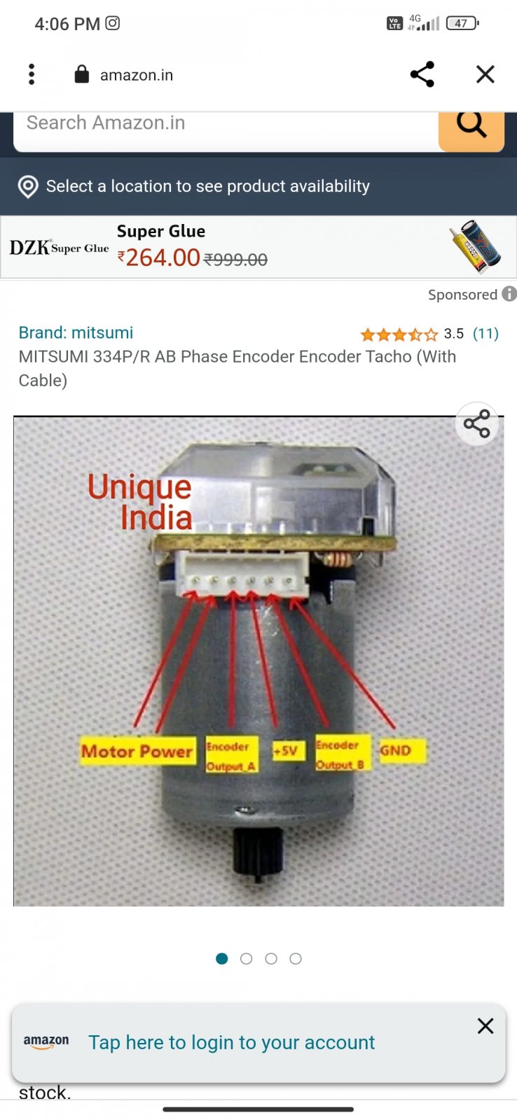

  18. elnino
    Apr 1, 2010
    246
    Computer Geek
    Adelaide, Australia
    1,557Coins
    +139 / 1 / -0
    So is there any evidence of anyone else using this motor/encoder combo unit for a wheel?
    Have you tried any other code on the arduino to test the encoder output? (I can help if you don't know how)
    I specifically asked for pictures of the wiring because so many times it has been the wiring that is the issue.
    I'm also finding conflicting information for this motors pinout relating to the encoder. Are you sure you have it right? I also noticed that this is only a 10W motor, it's not likely to be much use for this application.
    Did you try my suggestion?
    If you want other people to help, you need to help them help you by providing complete and full information.

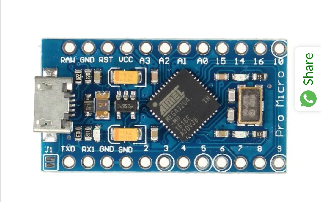

  19. Abishek Y
    May 15, 2023
    10
    65Coins
    DC motor
    A YouTuber make a ffb steering using this motor encoder
    Please help me to test the encoder with other Arduino code
    I have a screen shot of pin out of this encoder
    Ash and white colour wire encoder A and B
    One ground yellow and white pin 6 to z toogle
    Red for 5v and a black for another ground pin to encoder
    I use two ground one for encoder and other for z toogle
