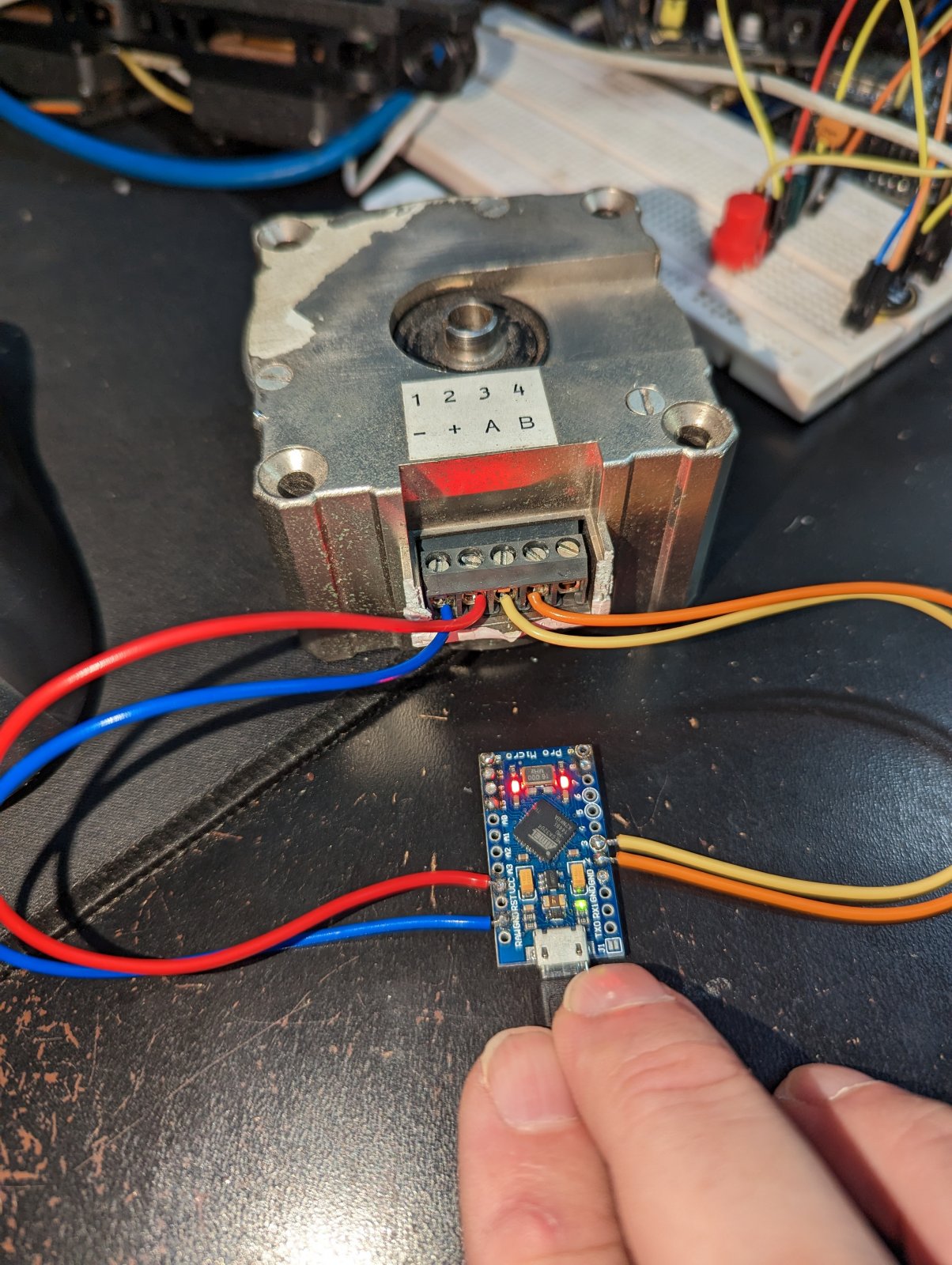

  3. Abishek Y
    Abishek Y New Member
    May 15, 2023
    10
    65Coins
    DC motor
    In serial monitor screen no numbers are shown
  4. elnino
    elnino Active Member
    Apr 1, 2010
    246
    Computer Geek
    Adelaide, Australia
    1,557Coins
    +139 / 1 / -0
    you changed encoder to pins 2 and 3? I'll have to spin up the code and test it properly but it should work
  5. elnino
    Apr 1, 2010
    246
    Computer Geek
    Adelaide, Australia
    1,557Coins
    +139 / 1 / -0
    I tested the code and it works fine for me

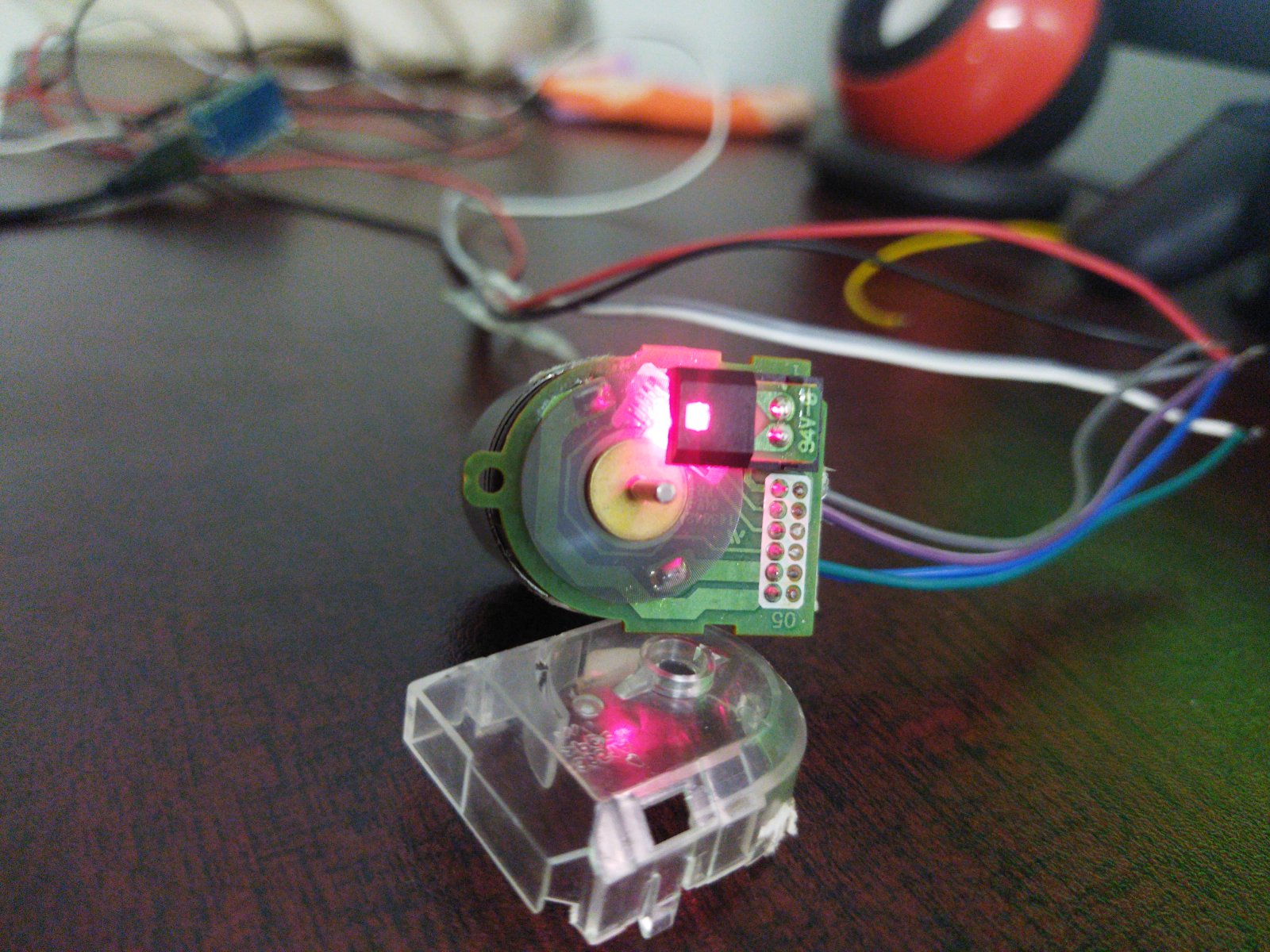

  6. Abishek Y
    May 15, 2023
    10
    65Coins
    DC motor
    Is this code is suitable for this encoder
    I cannot get output
  7. elnino
    Apr 1, 2010
    246
    Computer Geek
    Adelaide, Australia
    1,557Coins
    +139 / 1 / -0
    I have no idea, but if my code does not work for your encoder, it will not work for aiwave firmware. Perhaps you're best off contacting the person you said had it working with that motor.
    Without technical information on that encoder, it's impossible to help
    Edit - you still have not confirmed swapping to pins 2 and 3 for encoder. Importance in detail

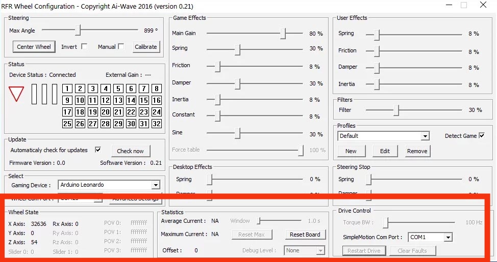

  10. Abishek Y
    May 15, 2023
    10
    65Coins
    DC motor
    In my wheel config software the marked options are not shown
    After I bought new Leonardo R3 board and encoder but now also I gave the same problem
    Is the software properly work with windows 7 I use win 7 operating system in my pc
  11. elnino
    Apr 1, 2010
    246
    Computer Geek
    Adelaide, Australia
    1,557Coins
    +139 / 1 / -0
    It's under advanced - you set PPR and drive type
    But as I have mentioned here so many times, why run 7 year old unsupported software? Aiwave was abandoned. You could have swapped to EMC firmware on stm32 for less than the cost of your new Leonardo board...
