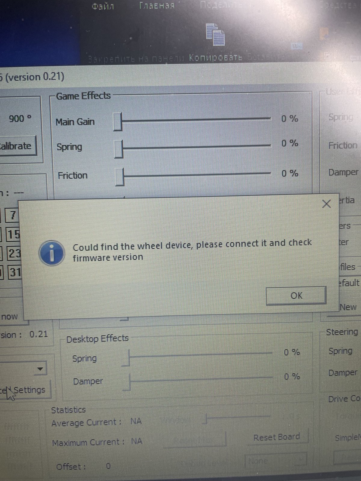

    Hello everyone, I’m making a steering wheel with my own hands using an arduino leonardo and encountered an error in the RFR Wheel Configuration program - Copyright Ai-Wave 2016 (version 0.21)
