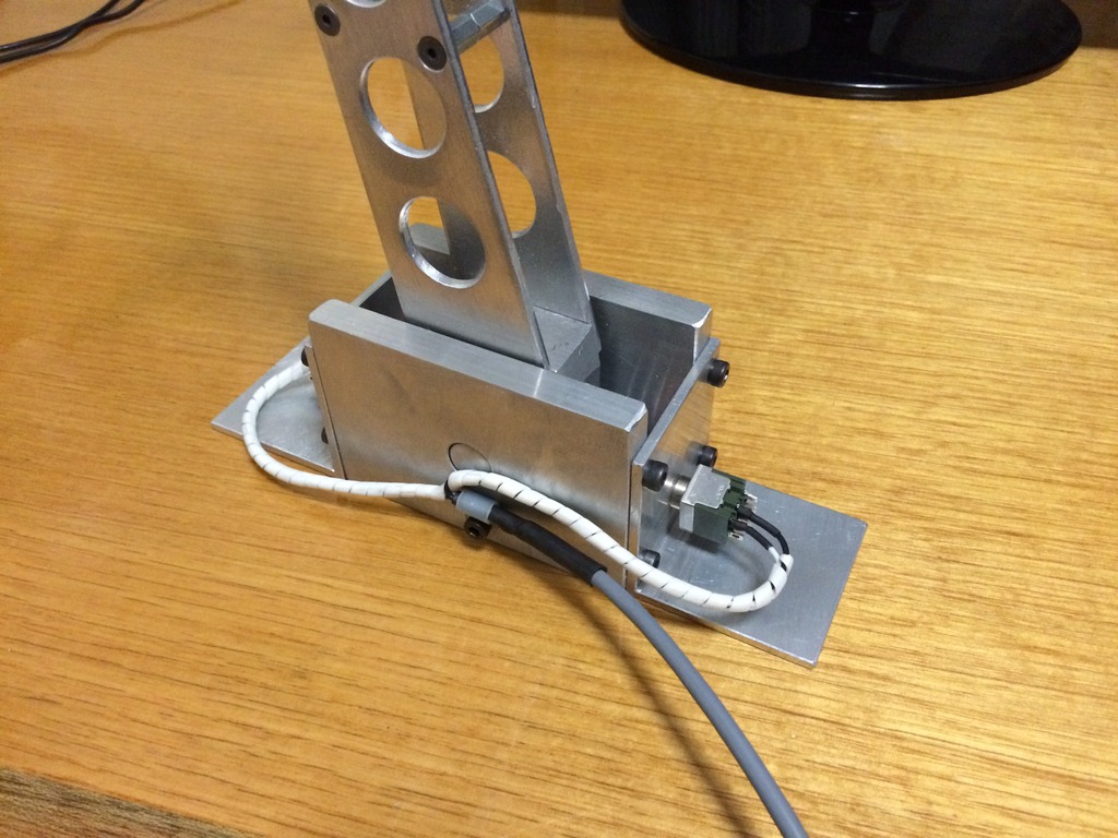

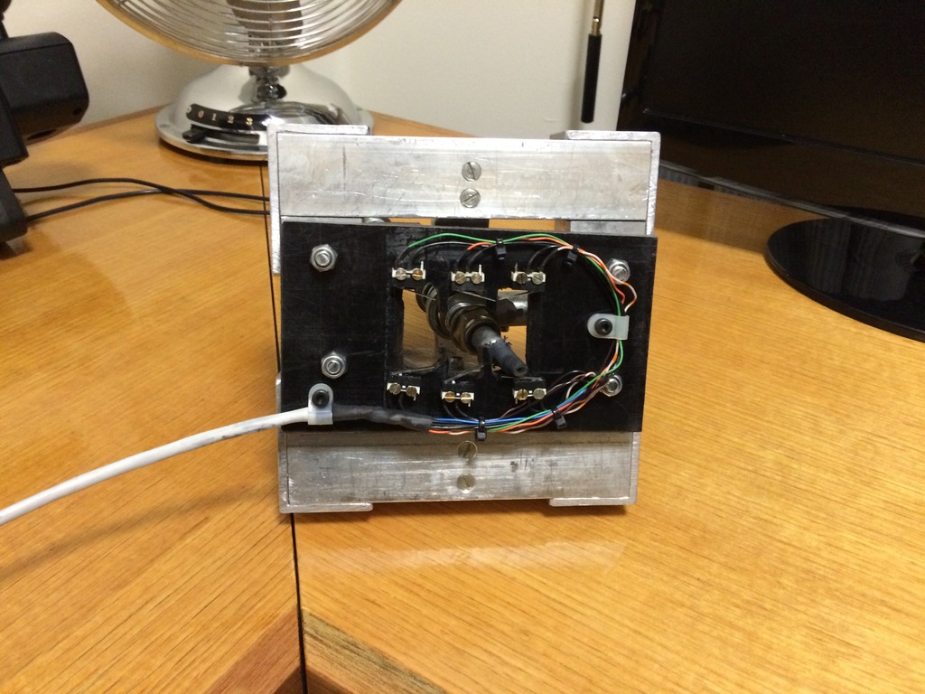

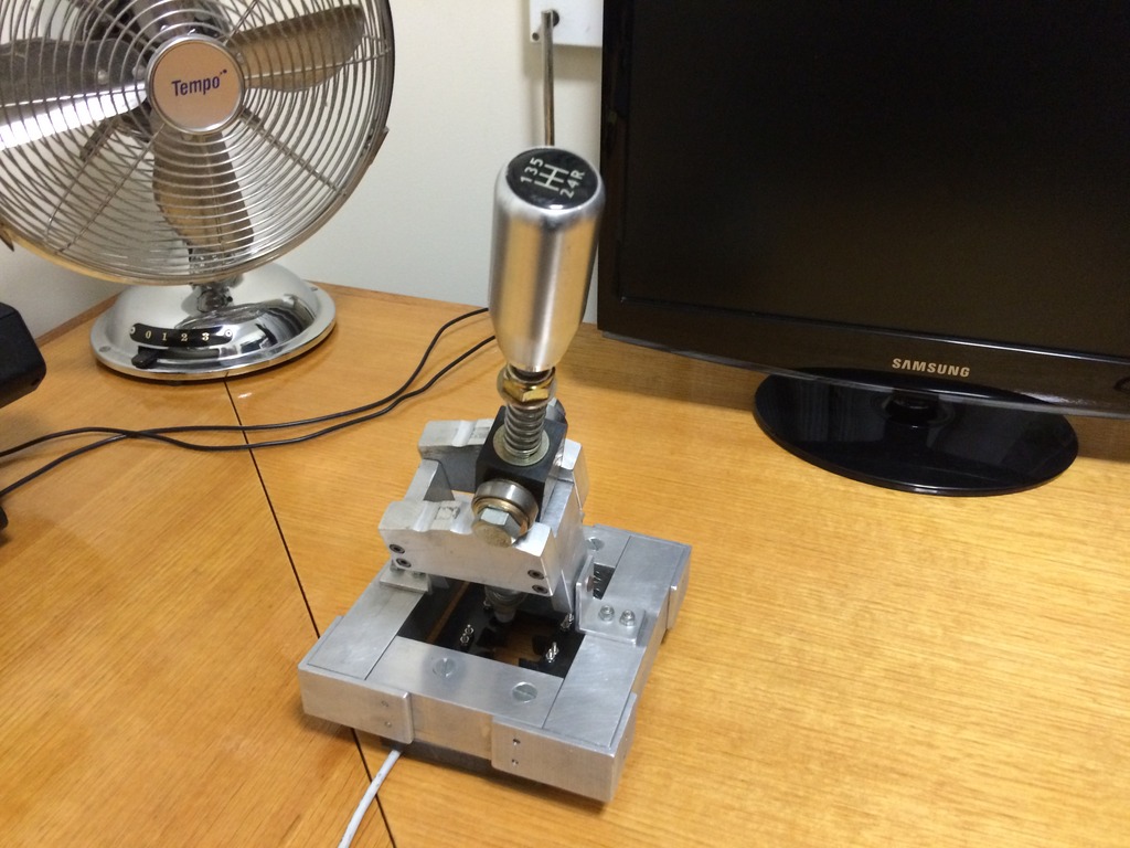

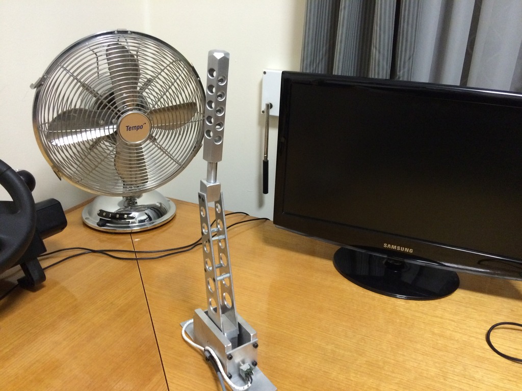

    I finally ended up wiring in my 5 DIY 5 speed shifter.
    I didn't like the first sequential that I made so I made a new one. Made the shift knob myself
    Activated by pushbutton switches.

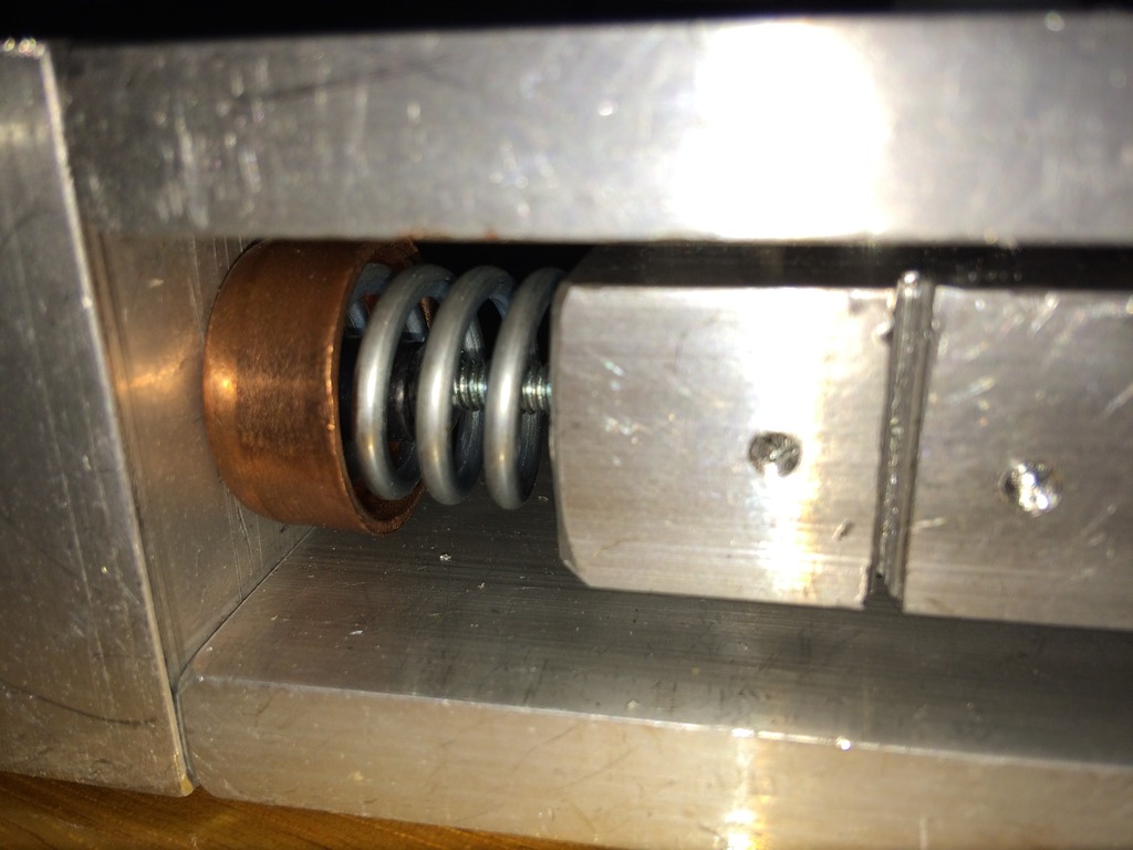

    Difficult to see but within the sping seat I have drilled and tapped a hole for a screw to sit in and activate the button on either side.

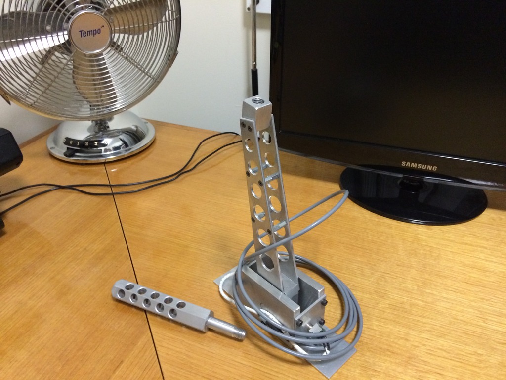

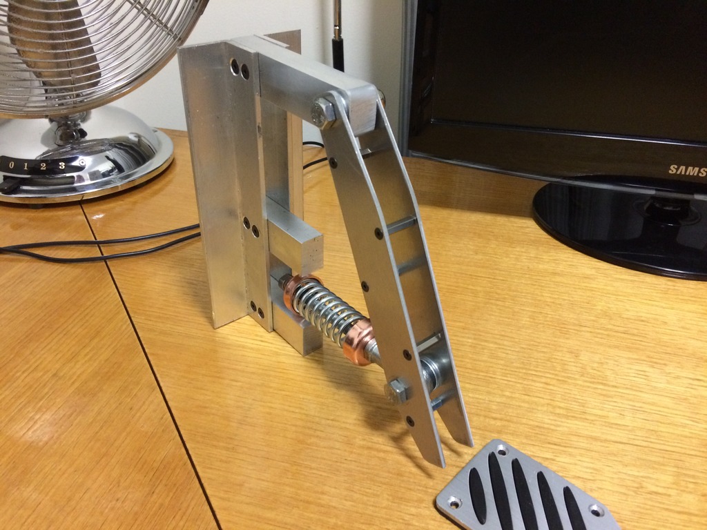

    And also a new inverted pedal design. Still in the design phase.
    Still got plenty of work to do on all the peripherals. Not done yet

    Nice work Alexey I have been very happy with my shifter (7 speed) as well. I see that you changed the design slightly with stops rather than ramps for the bearings. It would give a more solid "thunk" entering into gear, nice.
  4. Alexey
    Alexey Well-Known Member
    Sep 23, 2014
    452
    Electronics Technician
    Adelaide, Australia
    8,066Coins
    +623 / 2 / -0
    You are definitely right about the "thunk" into gear. I tried to emulate the feeling of an real shifter and this seems to achieve that. The gates look quite ugly, but feels really good. They didn't start out that ugly.
    I opted for a 5 speed as in most games that I play, the cars have either a 5 speed or sequential gearbox. Never liked 7 gears on a H pattern. If I do decide to make one it will be gated on the top and labelled as not to confuse the gear positions while using it.
