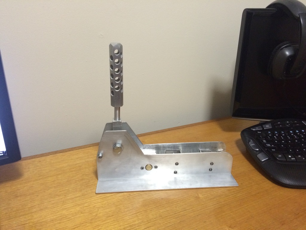

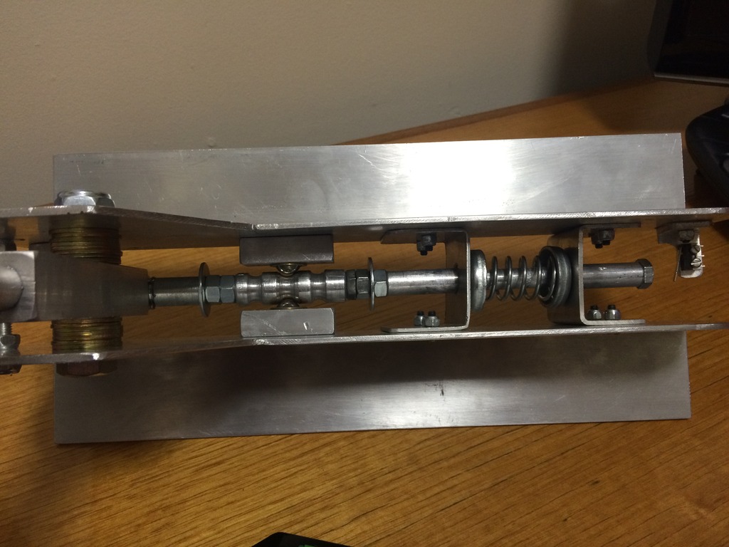

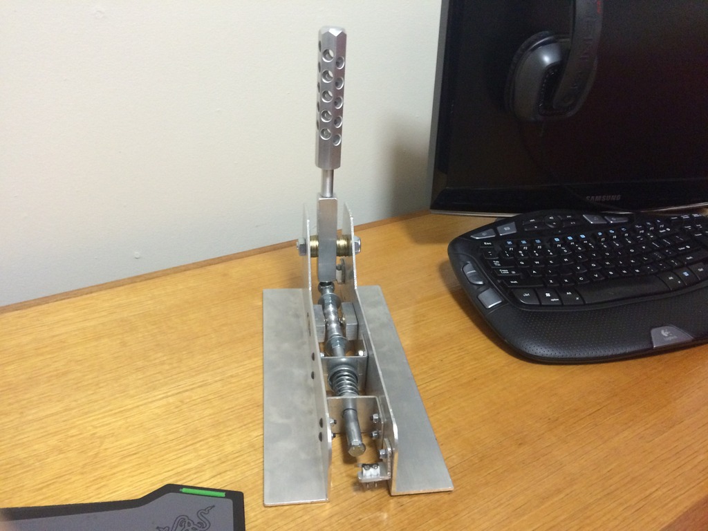

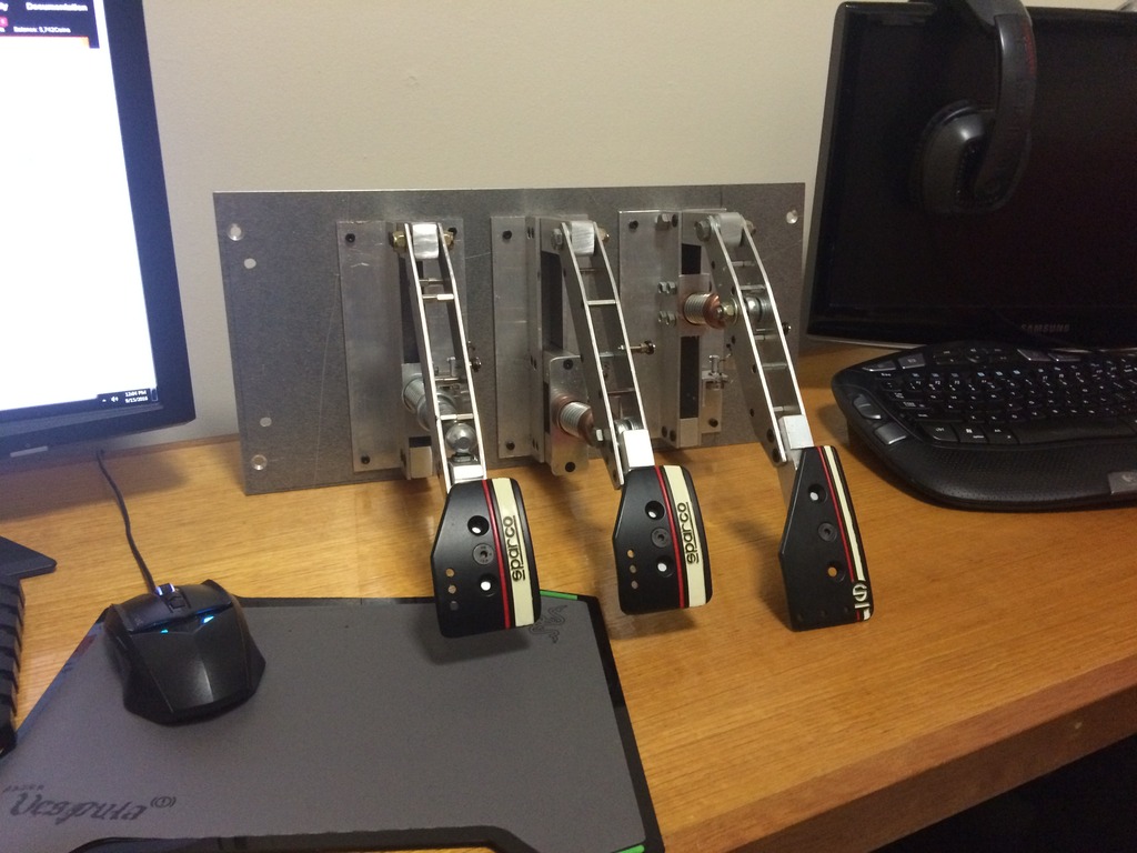

    Again, I wasn't happy with my sequential shifter. it just didn't have that "clunk" that you expect when shifting up and down gears. So I borrowed a design from a member here and made a new one, again...
    [​IMG][​IMG]
    So now I get that nice and sturdy "clunk" when shifting gears.

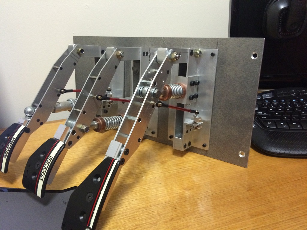

    And now, My pedal set number 2.
    The pedals feel really solid and have good resistances. The brake pedal might need tweaking here and there but really needs proper game testing to find a comfortable spot (spring strength).
    Now I just need to rebuild the motion sim and wire everything up. Sounds so simple in thoery o_O

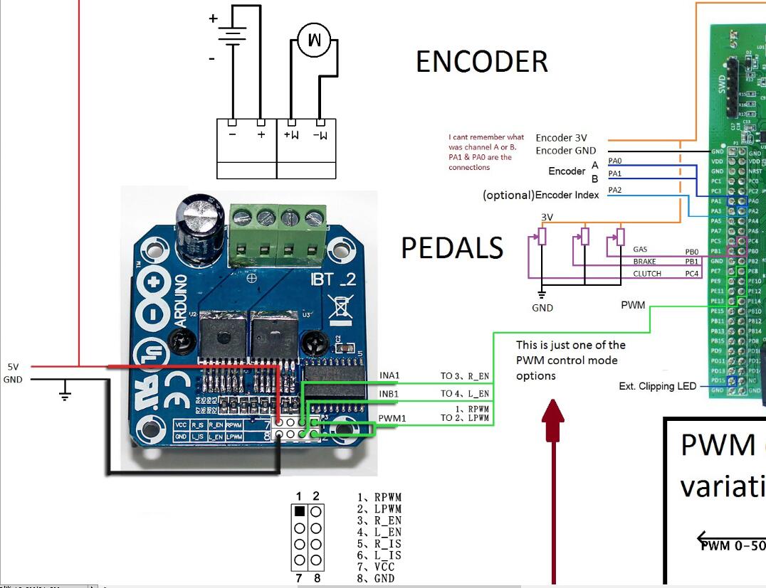

  4. fzxj520
    fzxj520 Active Member
    May 14, 2015
    176
    1,341Coins
    +90 / 1 / -0

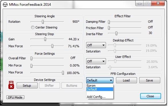

    Hey I'm building a MMOS wheel myself.. I have problems with saving the settings. If I power cycle the board it looses all settings.. Did you have simmilar problems?
  16. Alexey
    Alexey Well-Known Member
    Sep 23, 2014
    452
    Electronics Technician
    Adelaide, Australia
    8,066Coins
    +623 / 2 / -0
    I haven't got the mmos utility on the PC I'm on at the moment but I do believe there is a "save" function on the lower right hand side panel.
    Within that save tab I do believe there is also a drop down list as to what you are saving to, eg saving to the board or a config file.
  17. Daguru
    Sep 4, 2013
    725
    Kitchen installer
    Wales uk
    233Coins
    +634 / 1 / -0
    Motion platform
    Yeah i think you need to save to eprom
  18. Nick Moxley
    17,057Coins
    +2,507 / 30 / -2
    Correct, saving to Eprom is the Default default.
