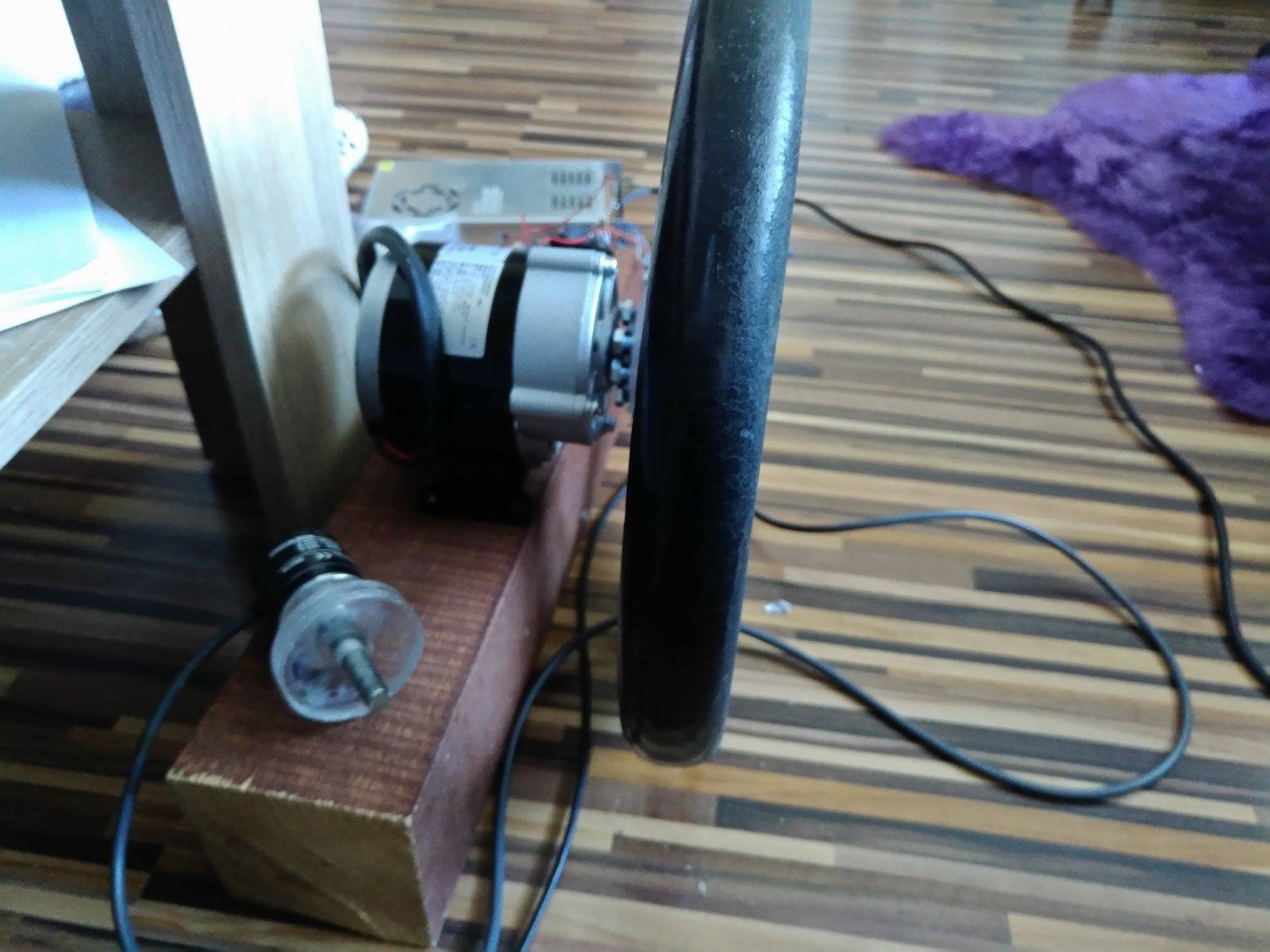

    auryza Active Member
    Jun 12, 2013
    109
    Lithuania
    4,340Coins
    +76 / 0 / -0
    2DOF, 3DOF, Arduino
    i did think there would be a lot of current ! perhaps it could be run at 6v or lower to keep the heat down
    something else i looked at was this
    Unite MY1020 Geared 750W Motor
    this guy has done a FFB wheel of his own for a flight simulator (and his own linear actuator !)
    http://bffsimulation.com/BFF-FFB-System.php[/QUOTE]
    Hi
    Believe me this one have to much power, i have project already with Arduino leonardo FFB, and this motor on picture has a lot of torque, even some times too much. :D , 24 V 350W.

  14. auryza
    Jun 12, 2013
    109
    Lithuania
    4,340Coins
    +76 / 0 / -0
    2DOF, 3DOF, Arduino
    I like it, it's really good, i have tried and OSW, of course it's different from DC motor setup, because of gearing, still it's much better than any Thrustmaster or other similar :D ,
    speed after gear with load 353 rpm, 9,7:1

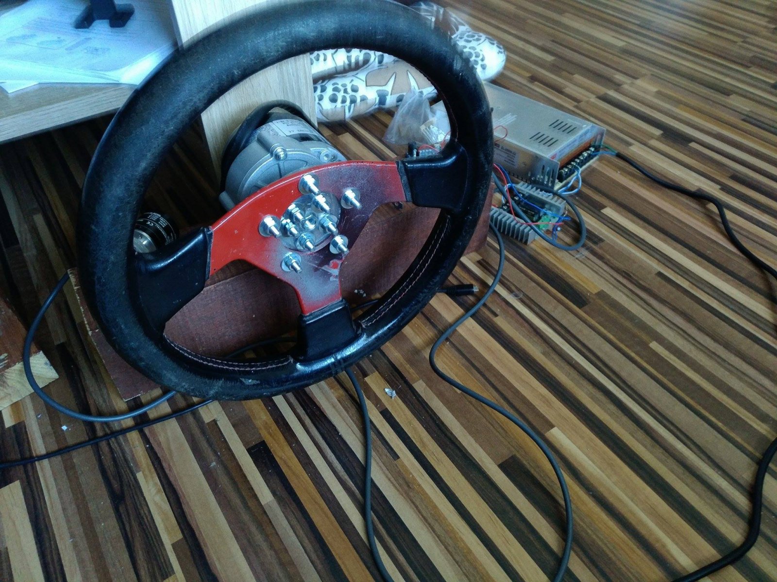

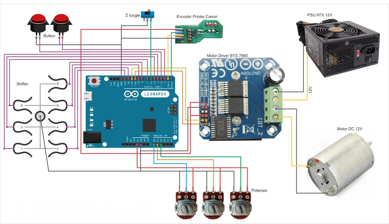

  15. auryza
    Jun 12, 2013
    109
    Lithuania
    4,340Coins
    +76 / 0 / -0
    2DOF, 3DOF, Arduino
    This is my setup. :)

  17. auryza
    Jun 12, 2013
    109
    Lithuania
    4,340Coins
    +76 / 0 / -0
    2DOF, 3DOF, Arduino
    On picture is actually sketch, what possible to do with Leonardo.
    Motor 1016z-350W 24V, 9,7:1 Gear , encoder 2000 PPR, nothing else unusual.
    Steering wheel from some old racing car.
    Coupling custom made by me. Again nothing unusual. ;)
  18. Gadget999

    +623 / 2 / -0
    Just curious. Is the wheel hard to turn even without power? Wondering if the gearing causes a heavy wheel.
    I had thought of using this motor and gearbox combo but was unsure if it would be too heavy to turn freely.
