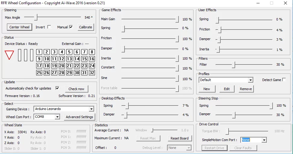

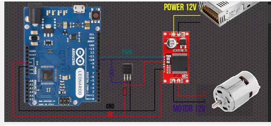

    Hello All,
    If somebody interesting, here is the code of Arduino Leonardo, actually you can use and other Arduino, but only Leonardo has feedback option.
    Less words, more pictures.

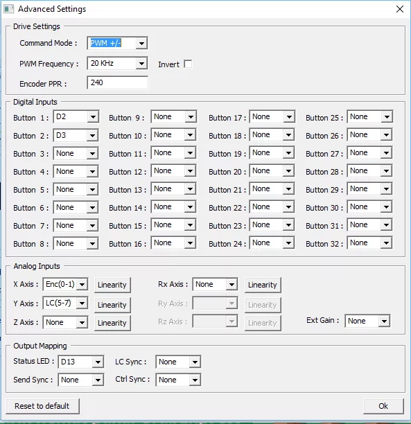

    And one more option for Monster Moto Shield, only what you need is NPN bc547 Transistorand couple resistors 5Kom, i have tried with other NPN transistor and is works well.
    And you need to choose PWM+ DIR mode on wheelconfig advance settings.

    And Here is files Necessary for set up your wheel.
    Have a fun ;)

    wooow, i have not read all the thread, but... can we make a forcefeedback out of moto monster and a regular brushed motor? last time i checked it was achivable only using steeper motors and steeper controller (a bit expensive)...
    also there was an option using stm dicovery boards. (not that expensive, but far mor expensive than a regular arduino...)
    - so only arduino leonardo, a motor driver a motor and that is all???
    -if so, what games sends data to this little master piece of software you posted on the shots?
    fer

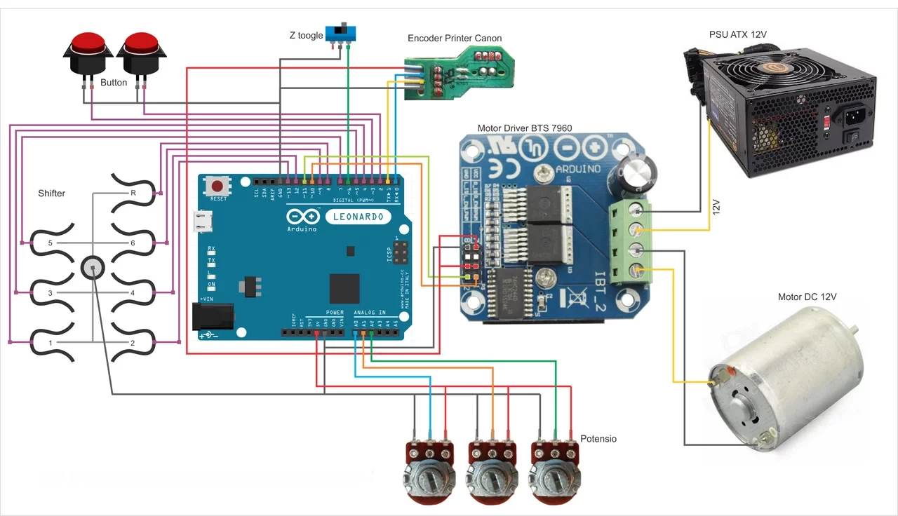

    Hi ferslash,
    The STM32F should only be around $30 from ebay or Element14. My wheel builds have used this board so I cannot comment of the arduino FFB wheel. That is a question for auryza.
    If you go back to the start of this thread and read through the pages you will see that I mention that brushed motors is what I am using. So STM23F4 + Moto Monster + Rotary encoder + brushed motor is the minimum for the wheel. However, don't forget that you will need pedals. You can re wire ones from standard off the shelf wheels or you will have to make your own.
    No you cannot use a wiper motor as the worm drive is very hard to turn by hand.
    No you cannot use a potentiometer. A rotary/shaft encoder must be used.

    Only Leonardo, motor drive and brushed motor, nothing more. :) , works with any game even if it is not racing. :D ,
    And i forgot something , power supply. :D of course.
    Force feedback feels really good.

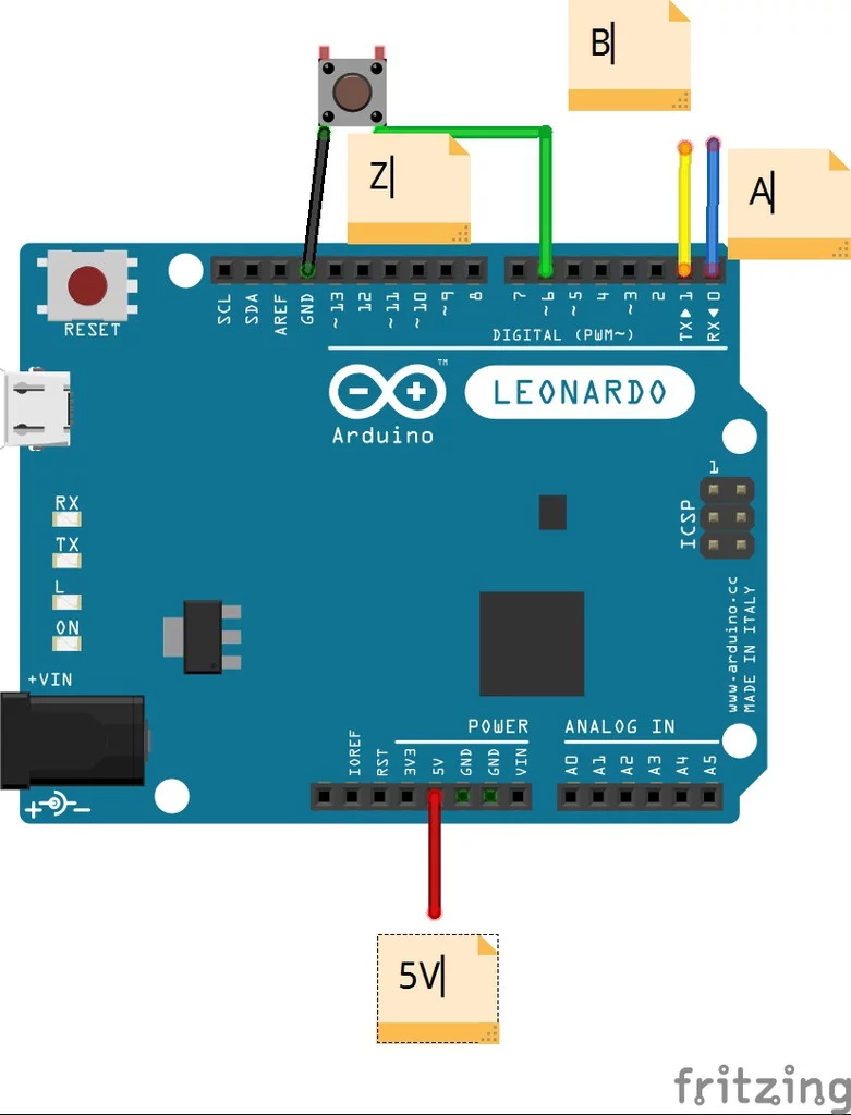

    +76 / 0 / -0
    2DOF, 3DOF, Arduino
    At this moment i'm using encoder with 2000 PPR, this will be 8000 CPR, and better take one with Z index. AB channels and Z index.
