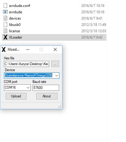

    You need to download and open XLoader , the from drop down menu, just choose mega 2560,
    All files you can find here
    DIY FFB Steering wheel (MMosFFB ) (In Progress)

    Xloader.zip

    i tried programming the code for the mega - but it did not seem to work. Does the arduino need to be a leonardo so it can emulate a joystick.
    i will keep trying

    So it's a bit tricky to program arduino with "xloader", first of all you need to restart arduino into bootloader mode, then arduino generating other com port number, whish you need find and write in to xloader com port , then you have 10 seconds to press flash button to install a hex file, that how this works with leonardo and macro.
    And with mega board probably that method doesn't work.
