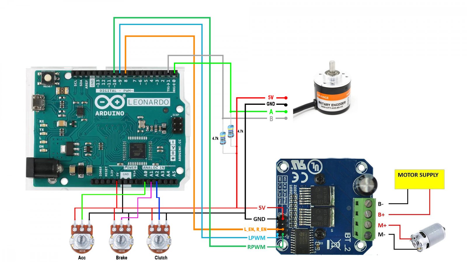

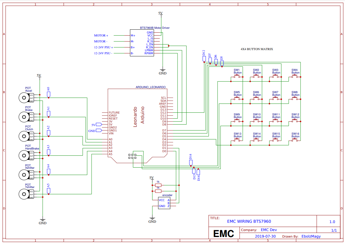

    for any one interested with the circuit diagram:
    and this is the wiring form the official Project EMC lite:
  2. Jonny_boii
    Jonny_boii Member
    Oct 29, 2024
    50
    265Coins
    +8 / 1 / -0
    DC motor, Arduino
    and this was the new one I tried recently but it didn't work as expected it just lasted longer than the 1st one but one drive gave out followed by the next.:(

    To be honest, I don't really understand why the BTS drivers burn up. According to the data sheet of the BTS7960 chip it should have overtemperature protection so it should shut down before being damaged. But the original chip is no longer manufactured by Infineon and the clones might have the protection not working properly.
    I can't give an instant fix or a recommendation how to make it work reliably. But from the schematic above, I think, I know how the current control algorithm works. The Arduino takes feedback from the encoder to measure the speed of the motor. It then tries to calculate the back-EMF voltage and aplies a bit more or less voltage to the motor to control the current.
    This is a bit like "driving blindly" and only works if the voltage-per-RPM constant and the winding resistance of the motor matches the values programmed into the software. Using a diffent and especially much larger motor than the original design is calling for trouble. So I'd recommend to replicate the original design as close as possible and use the exact same motor and encoder if possible.

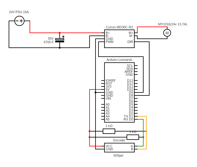

    so this up here was the original design for the official EMC software.
    This here is my modified circuit design with a more reliable driver. hope this works(yet to test it) ps.my 1st circuit diagram.
    edit: I forgot to add Z axis for the encoder cuz I don't have it for my encoder but its not used in the above diagram so if yall have Z axis yall don't have to connect it to anything .

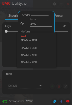

    Next, i would have to change the 2pwm one 1dir to 1pwm to 1dir in the emc lite software like this:
    and fingers crossed it should work. (I really hope, am getting mad about this project now since I can't just give up :(. Cuz ill need up like those losers who just do half-assed things and don't even try to fix it.

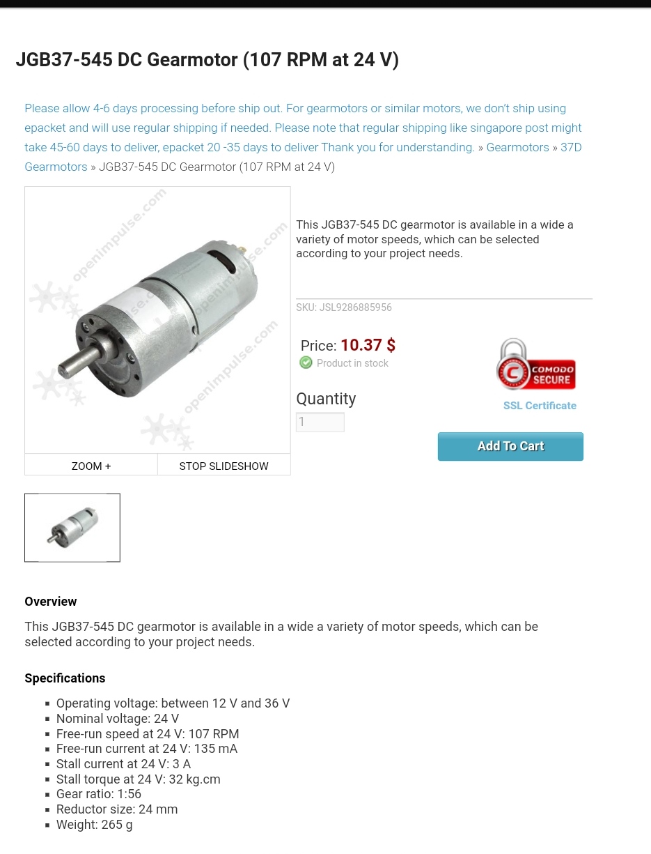

    I just saw this FFB wheel. It seems to use similar hardware as yours but much smaller motors including gearboxes. With the gearboxes and the two motors connected in series, I think that it requires a much lower current for the same torque so the drivers don't get as hot.
    Please also have a look at the Logitec wheel. It also uses relatively small motors with a large gear ratio.

    Yup seen this too but I don't have access to high quality custom gears

    I found that guys motor @Aerosmith
    Its not the exact as his was 200rpm or something .
    Looking at his gears size makes sense that he would go for smaller gear ratio as these are already geared motors

    I have ordered the cytron driver waiting for it's arrival will update when I get it.
  16. Jonny_boii
    Jonny_boii Member
    Oct 29, 2024
    50
    265Coins
    +8 / 1 / -0
    DC motor, Arduino
    Update guys, have got the driver and hooked it up after changing the inputs for pwm and Dir to singles each it worked successful no over heating nothing works like a champ
    I have to fully stress test it tho may be later now starting to put everything together

    For anyone who needs the circuit diagram
