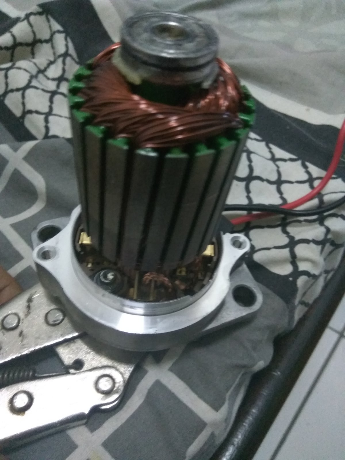

    yes 15.4nm measured with a rod of one meter above the kitchen scale, and spring 100% on wheel config software.
    66A at 10.5v more does not go due to the 66A power supply.
    this engine also swallows 150A in the starting point, but I believe in stalling it is founded

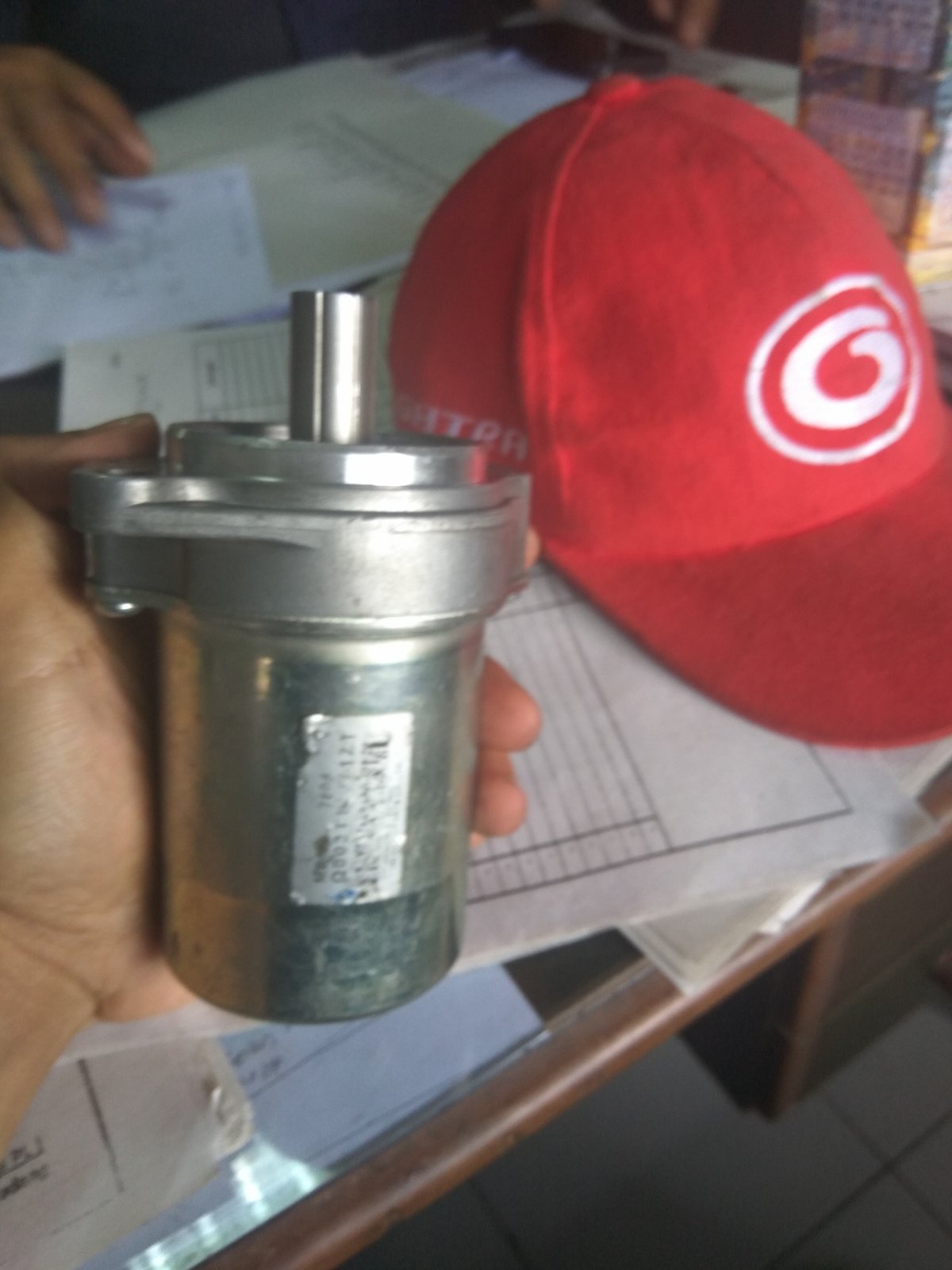

    absorbed inrush 150A at 24v on a scooter.
    while now as a steering wheel it stops at 66A 12vcc which is the limit of my power supply (I think it reaches 66A when the voltage drops to 10.5v)
    the engine from what I can read from the nameplate and 48v 0.75kw. the engine is 20 more years old .. robust products of the past

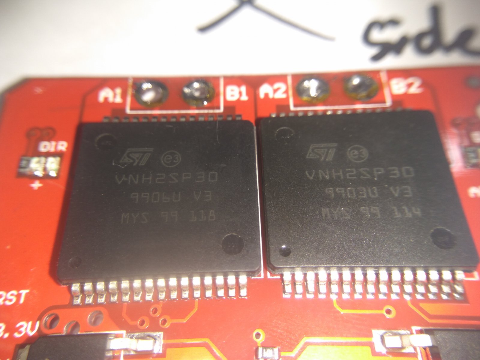

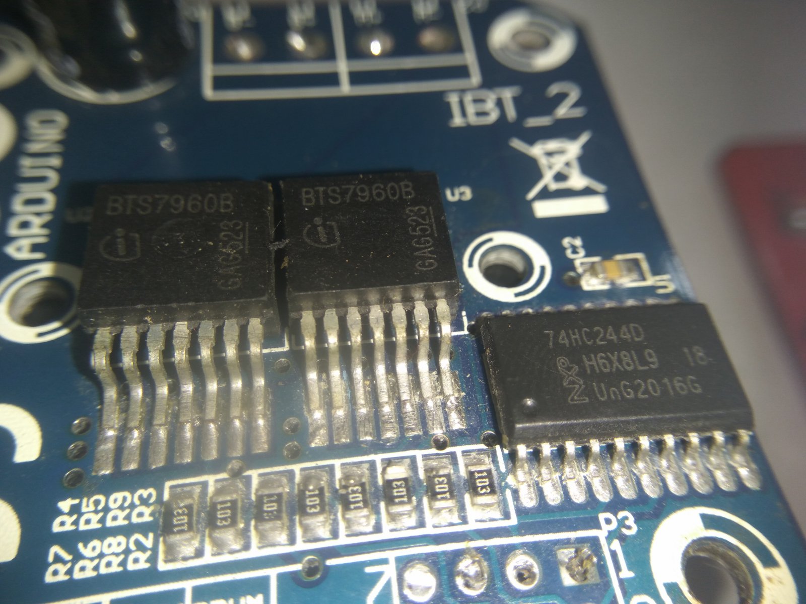

    DC motor, Arduino
    hello bro, the bts7960 driver has different chip code , how much each of them >?

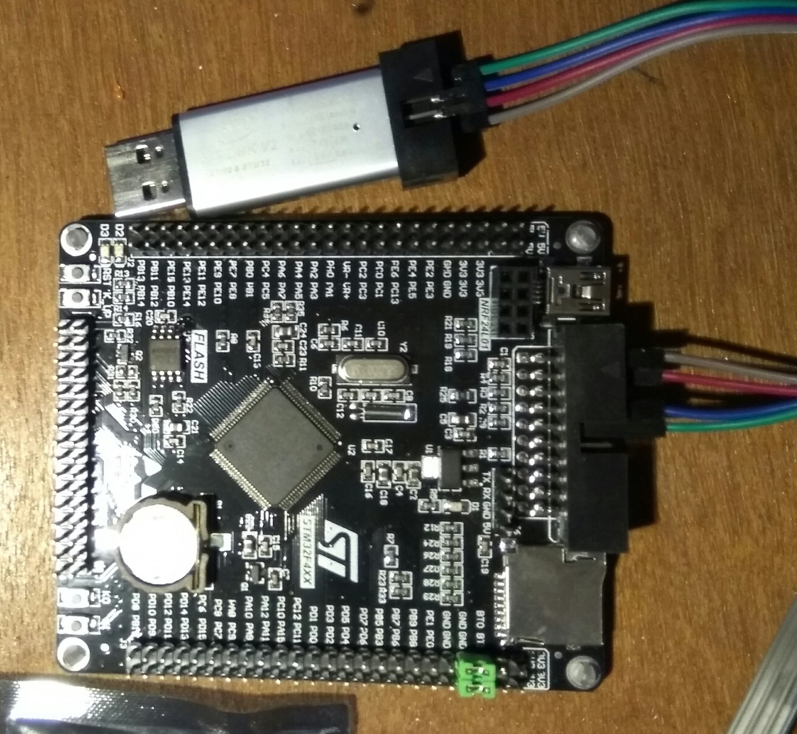

    DC motor, Arduino

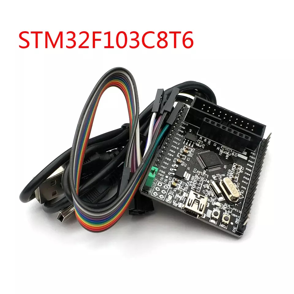

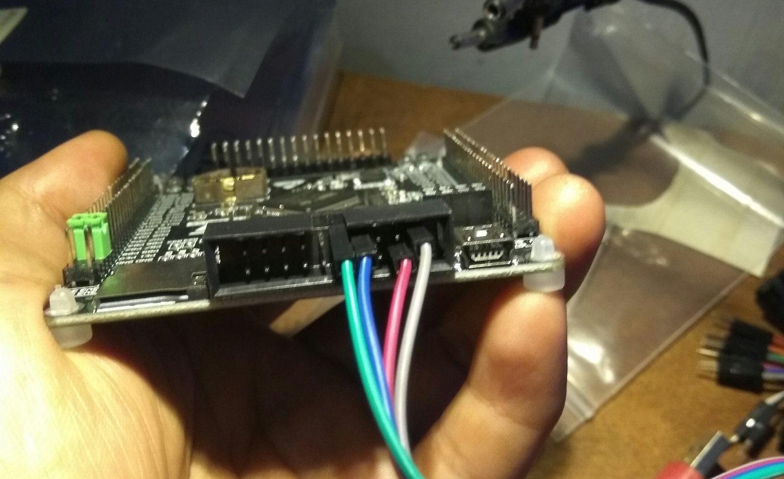

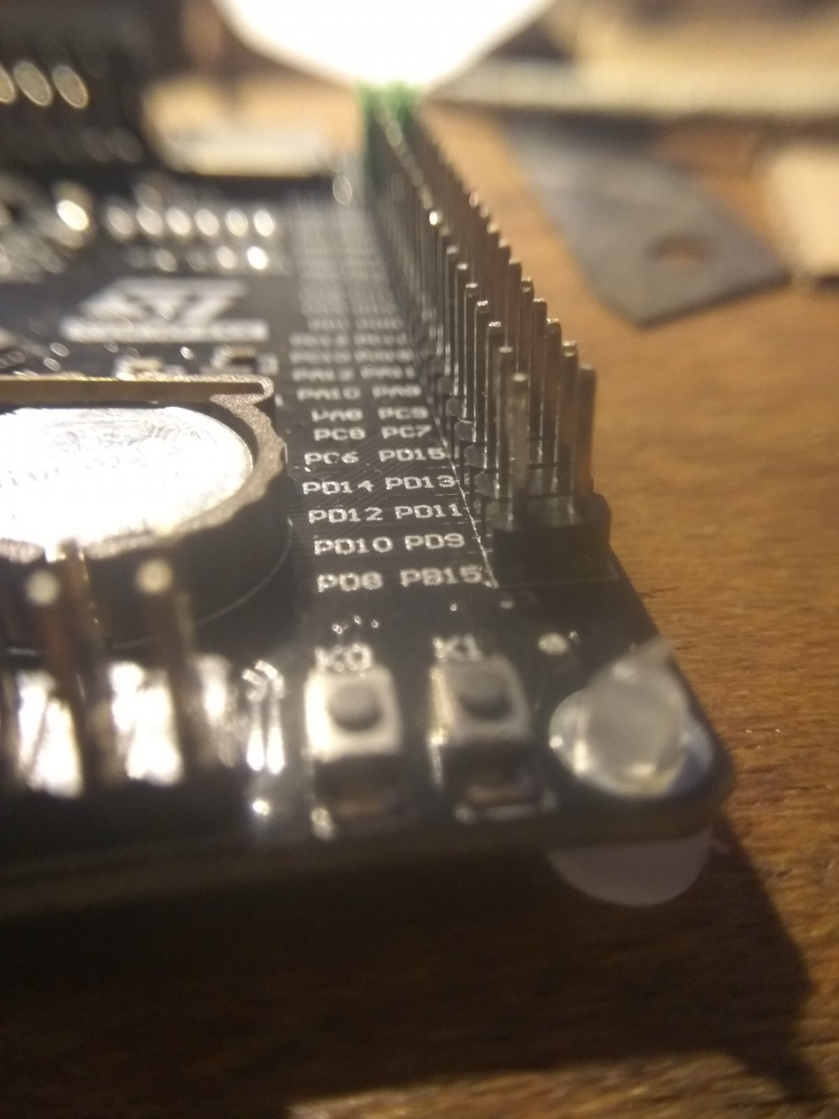

    Hello bro, can I use stm32F103C8T6 board to build your setup?

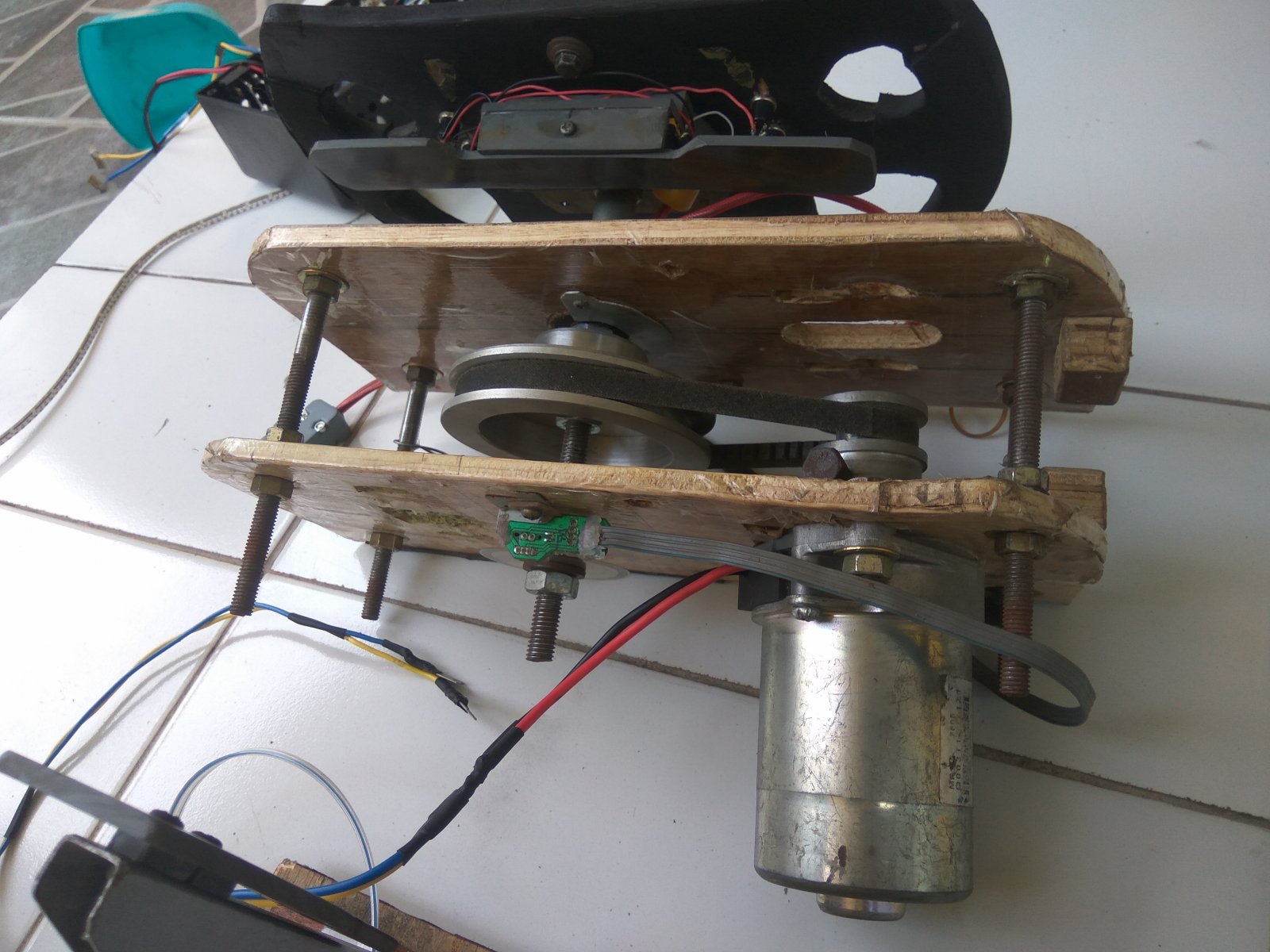

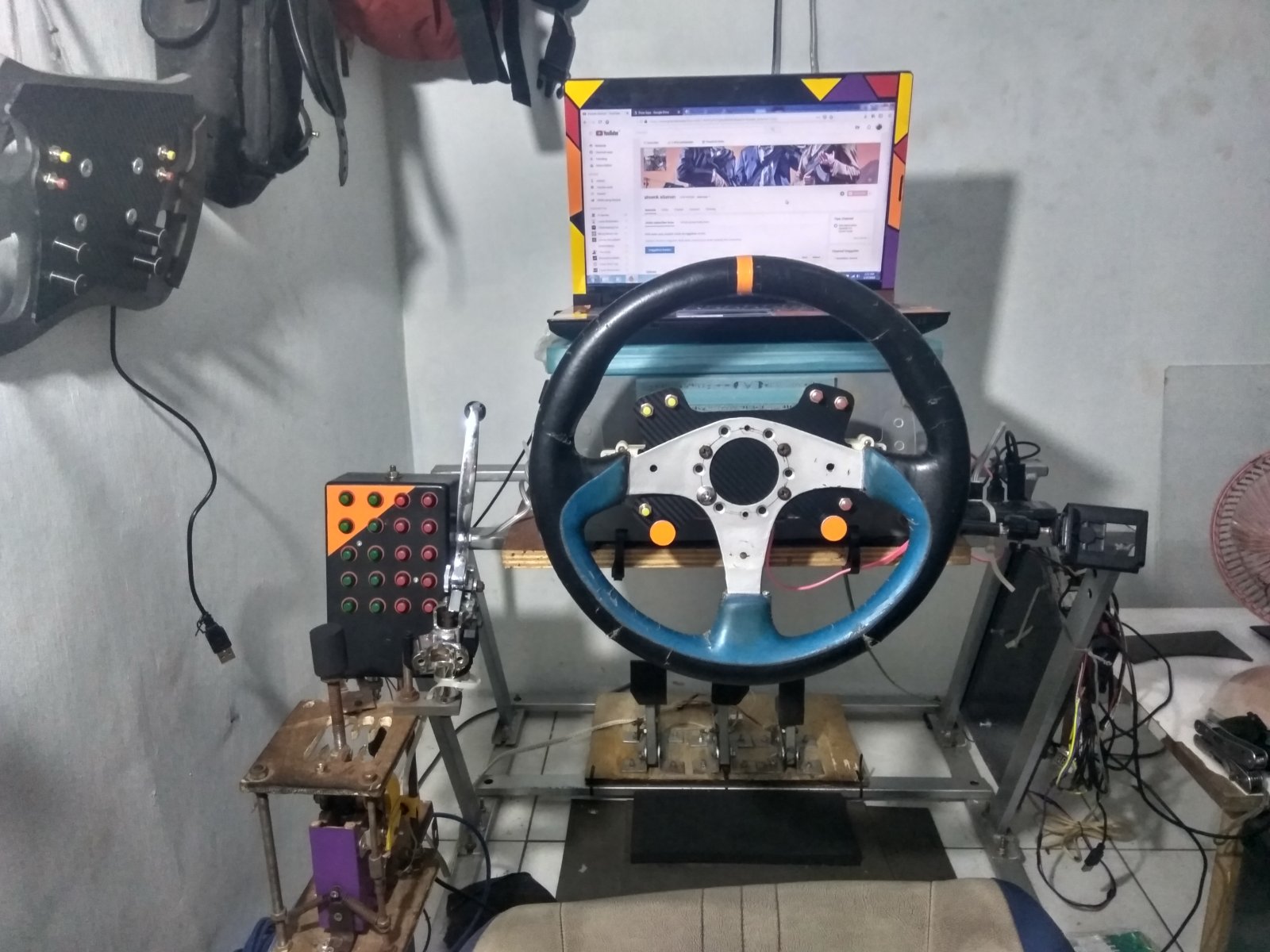

    new ratio, new setup, new torque test...
    and it get stronger, and still fast........
