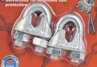

    Hello there
    I keep breaking my plastic ties...
    Volker , you are using steel wires, how to you tighten them?

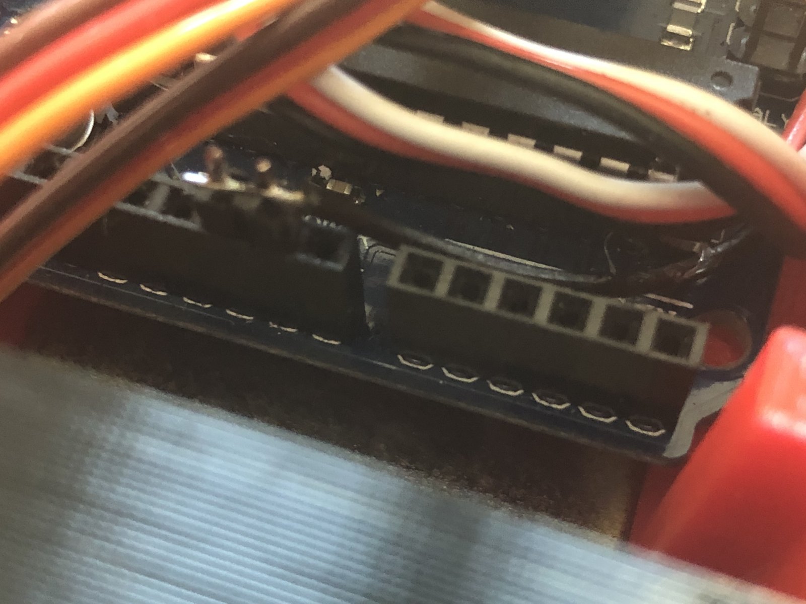

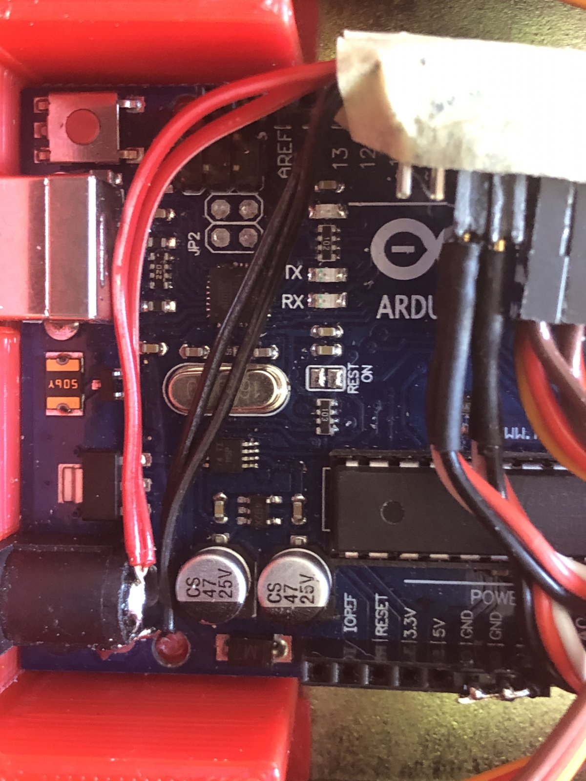

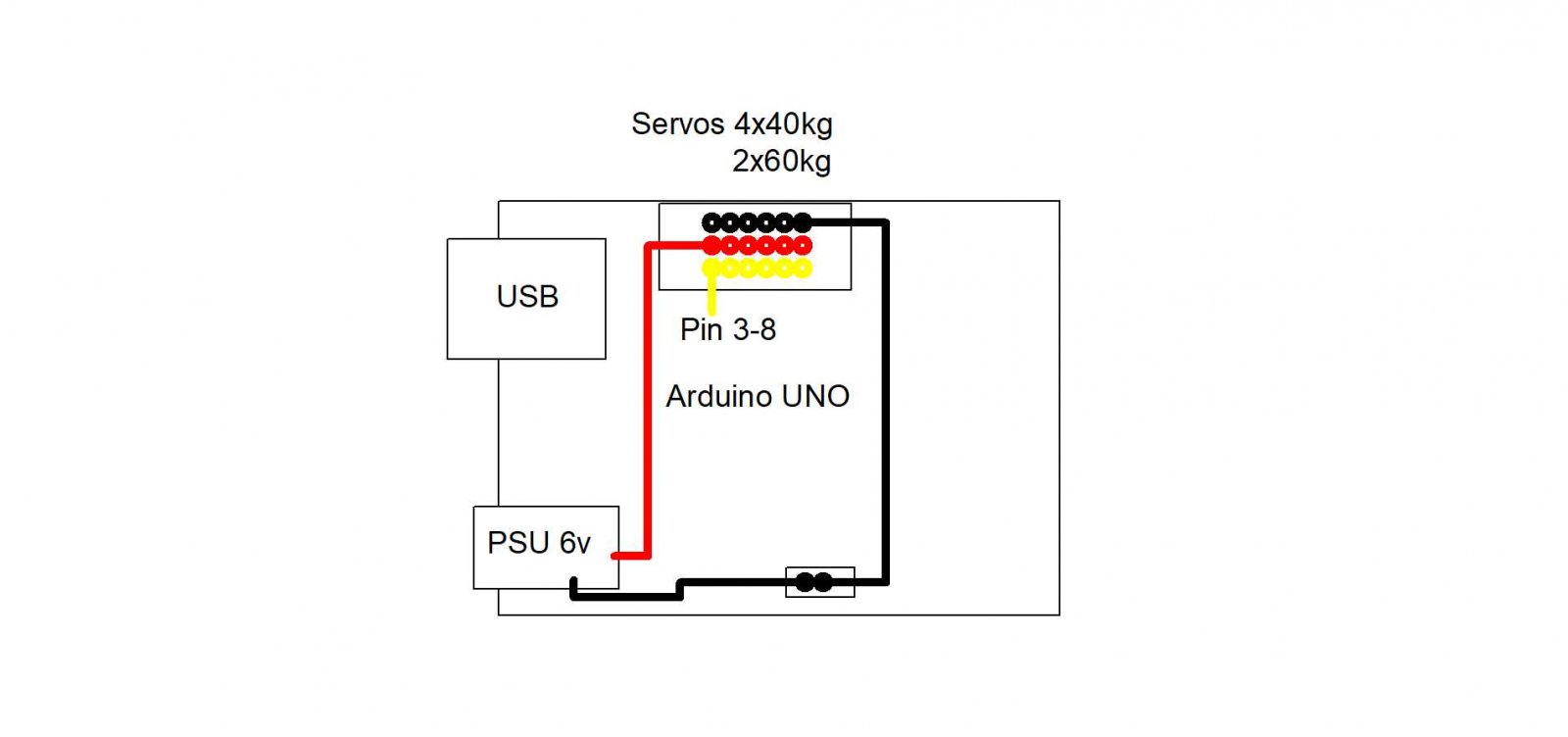

    This thread has been super helpful! I managed to build a rough prototype using toy servos and a breadboard. I'm now brainstorming a real-world design, and I'm wondering how to connect the electronics and power supply. I'm new to arduino as well as working directly with electronic components (except for maybe some programming).
    My question is...How do you connect the power supply to the servos? Do you use connect the power supply to a servo shield or motor shield, which then connects to the arduino board? Like this? https://learn.adafruit.com/adafruit-motor-shield-v2-for-arduino
    Or do you connect a separate power supply directly to each servo?
    Also, I think Volker originally mentioned that 35 kg servos were not sufficient for his design; he recommended using 60 kg servos. If I remember correctly, you're using 40 kg, right? How do you like the 40 kg servos? Do they get the job done?
    Thanks again for all your help!
  11. Banfy
    Banfy FR/AU
    Jun 11, 2020
    131
    Australia
    299Coins
    +56 / 1 / -0
    DC motor, Arduino
    Hello
    I did a similar system recently, you can see it here:
    https://www.xsimulator.net/community/threads/a-foldable-diy-sim-rig-with-g-seat.14948/
    I use 60kg servos. Not sure if it is overkill but maybe more reliable than smaller ones
    You connect power supply to each servos and, very important, you have to ground servos+arduino together otherwise it will not work
    Like Volker I have 1 PSU per servo but you can share 1 PSU for 2 or more, especially when you pair right/left servos which are not supposed to action at the same time.
    I use 7V/3A psu which is not easy to find, depends on the servo specs
    Hope this helps

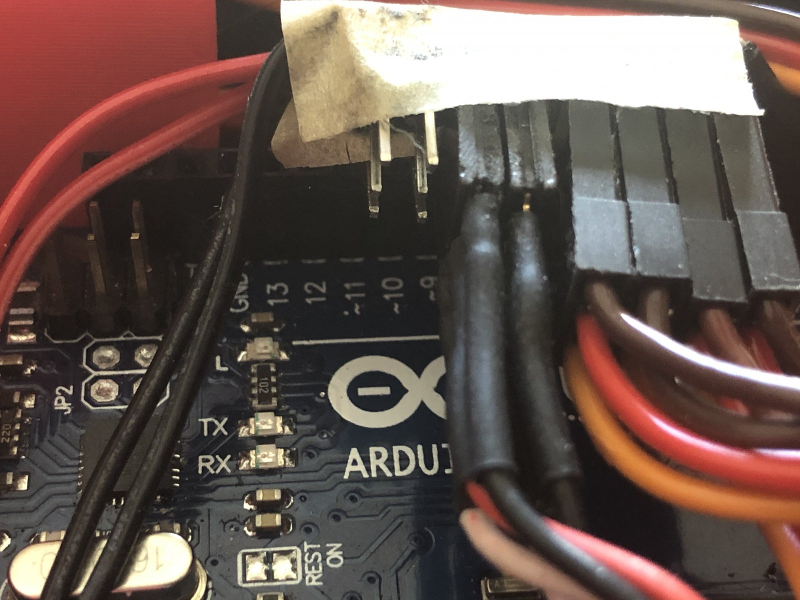

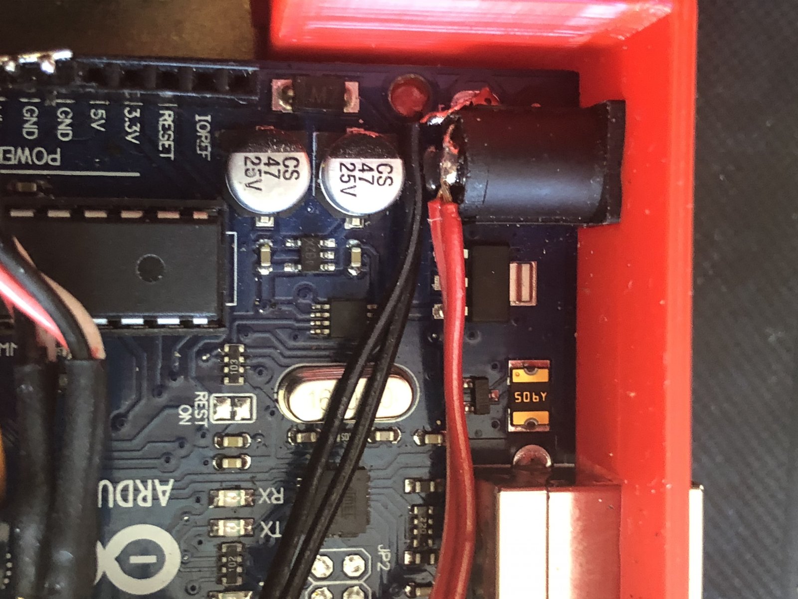

    Hi @Banfy , just want to make sure I understand what you meant about grounding to the Arduino.
    So would I connect it this way?
    + servo with + power supply
    - servo with Arduino GND port
    - power supply with separate Arduino GND port​
    If so, there are 5 GND ports on the Arduino board. If I plan to use 4 servos with 4 power supplies, would that mean I'd need a way to handle the remaining 3 GND connection?
    Or, would I use a breadboard for just the GND? Not for the + ?
    Or, is there another option that I'm just not seeing?
    Sorry for the beginner questions. I'm new to working with electronic components, but this has definitely opened me up to a whole new world of possibilities! :)
  14. Banfy
    Banfy FR/AU
    Jun 11, 2020
    131
    Australia
    299Coins
    +56 / 1 / -0
    DC motor, Arduino
    hello
    I have connected the + of servos to the + for each PSU independently
    I have connected all grounds together (servos and arduino), to the same row in the breadboard
    Not sure it is done by the book but this is how i did it ;-)

    I use 1 power supplie with 10A and 6V for 4x 40Kg and 2x 60Kg servos
