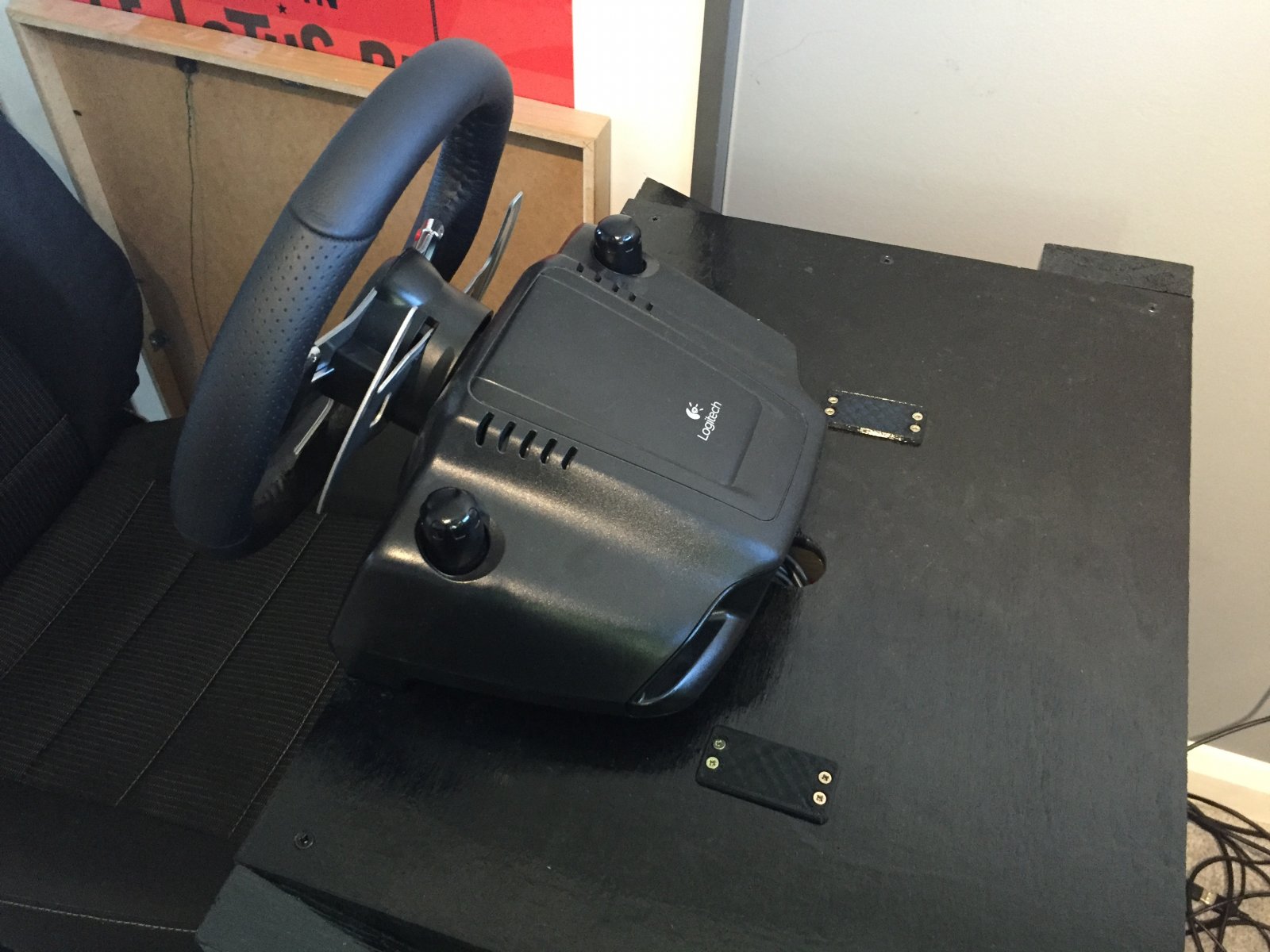

    Did make a few modifications since the last update
    Removed the g-wheel system and printed off some cover plates where the servos were:
    I initially thought the system worked well, but after more and more use it just didn't feel right. When you brake your body pushes into your arms which push into your hands and onto the wheel. The system I implemented didn't really accomplish this feeling. The force down the arms and into the hands wasn't there. The wheel just moves towards you and your arms naturally bend. Another lesson learnt but have to give these things a go

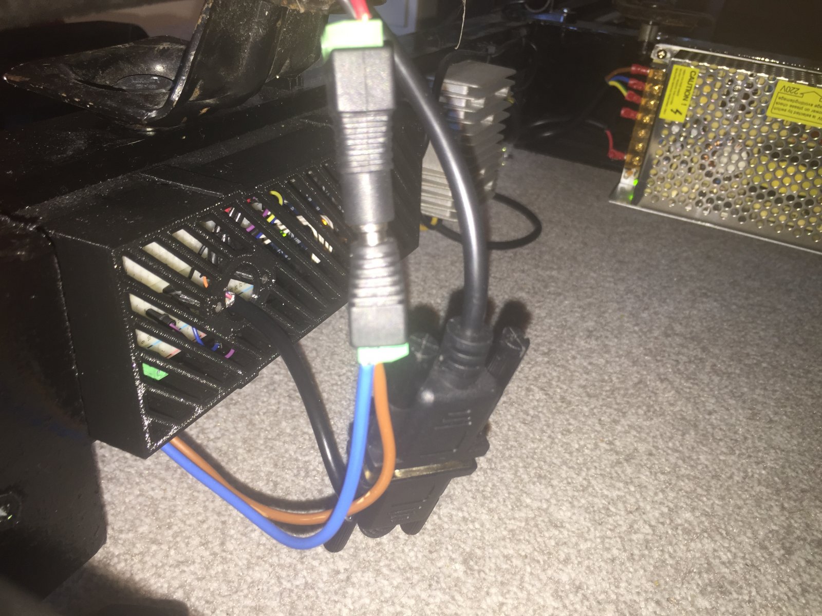

    I also completed changed how the servos connect into the breadboard. The original design was too fiddly when taking the seat on and off for maintenance. Refitting the servo connectors was a pain. I tried running just a 9 pin dsub cable but the wires aren't rated high enough for the current I need, so implemented 2 connectors, 1 for power and one for data. This way I know the servos are getting all the power they need:
    Now it's very easy to maintain - undo 2 connectors and 4 bolts and the entire seat lifts off the frame.

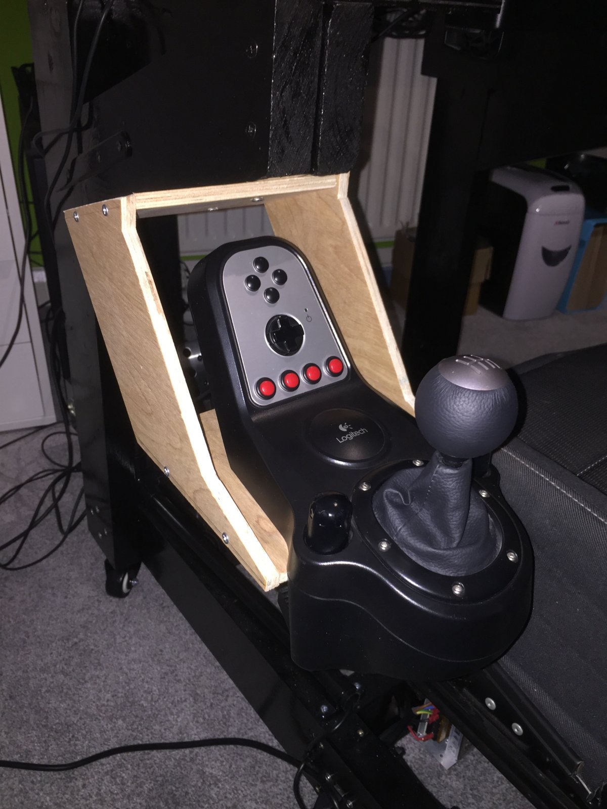

    Came up with a solution to mount the sifter. Is sturdy enough. Just needs painting black.

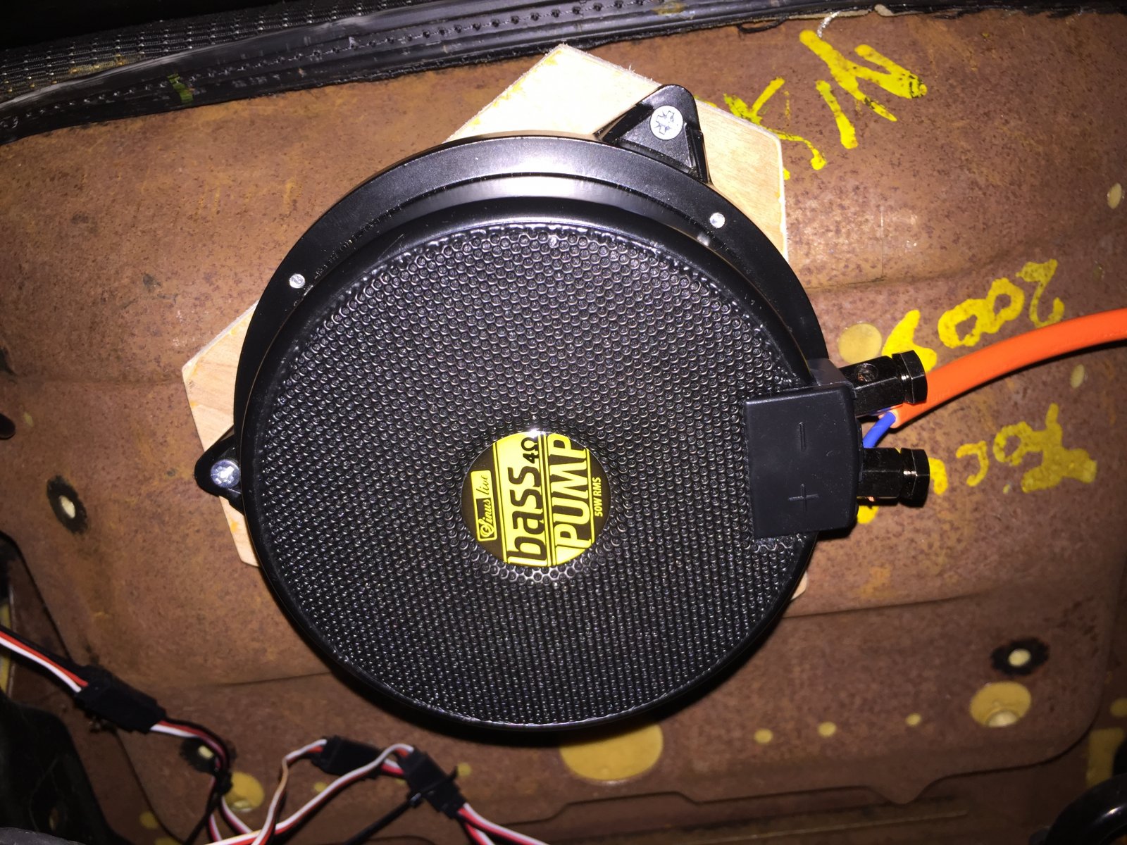

    Added a bass shaker to the underside of the seat. A sinus live 50w (£30) paired with a cheap 2x50w amp of eBay (£6).
    Main purpose is to achieve a sense of heave. Initial tests with LFS are great. Can feel bumps in the road and the rumble strips. Have also included a little rpm and gear change which takes the immersion to another level.
    The only issue I didn't forsee was the misses shouting at me from downstairs about the vibrations. Have tried to isolate the seat using rubber washers but will also need to source some anti vibration pads to go under the casters.
    Anyone have any other suggestions for isolation?

    Thanks for the isolator link, can you confirm they are effective? Doesn't look like they'd stop vibrations travelling down through a fixing? Not without an additional rubber washer under the bolt head?
    Think I'll go for these https://www.ebay.co.uk/itm/1pc-φ50x...e=STRK:MEBIDX:IT&_trksid=p2057872.m2749.l2649 as they offer a complete rubber isolation between mounts.
  13. noorbeast
    21,714
    151,991Coins
    +11,061 / 56 / -2
    They are effective in isolating sim vibrations from my wooden floor.

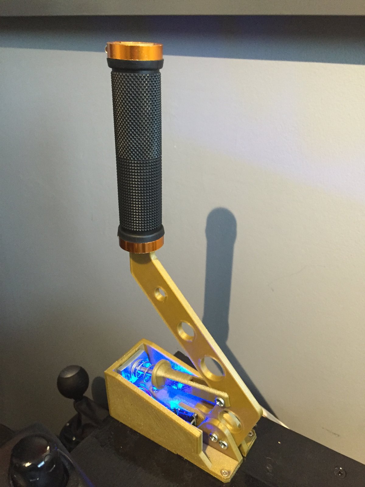

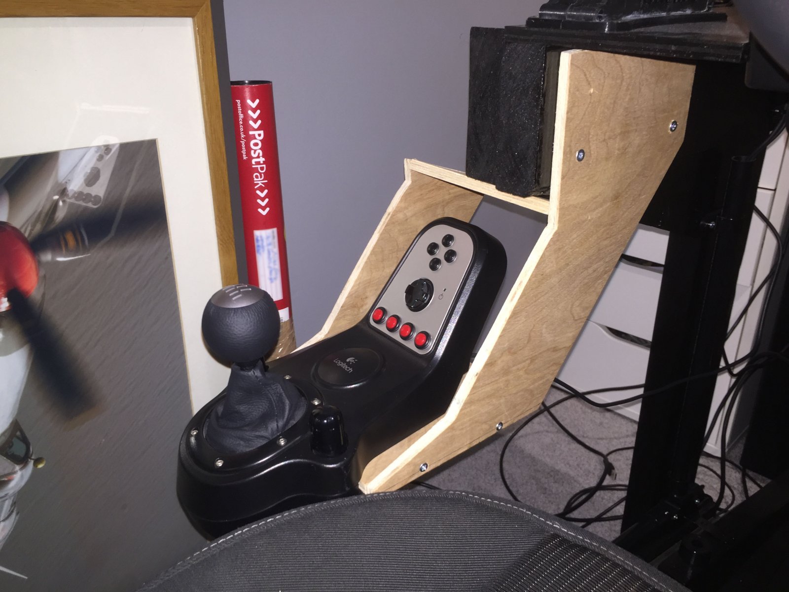

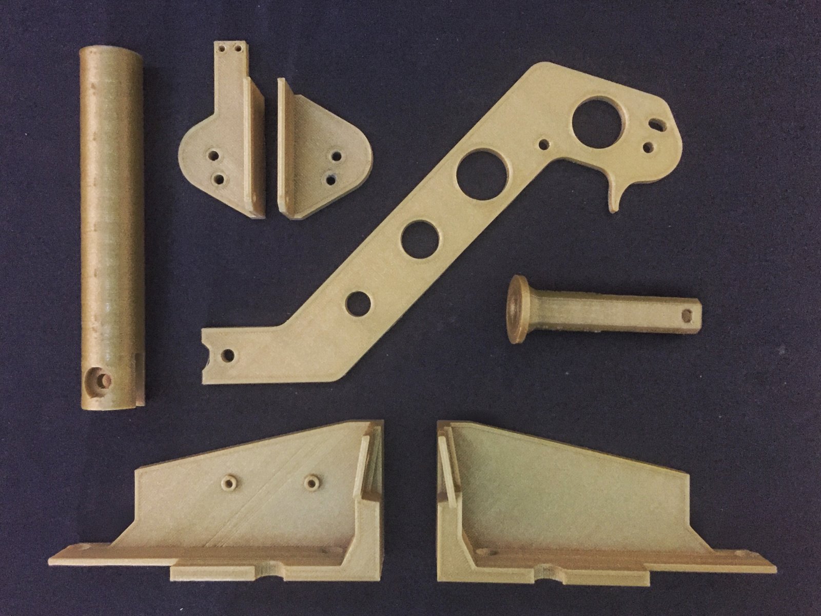

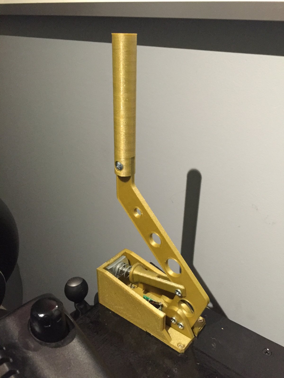

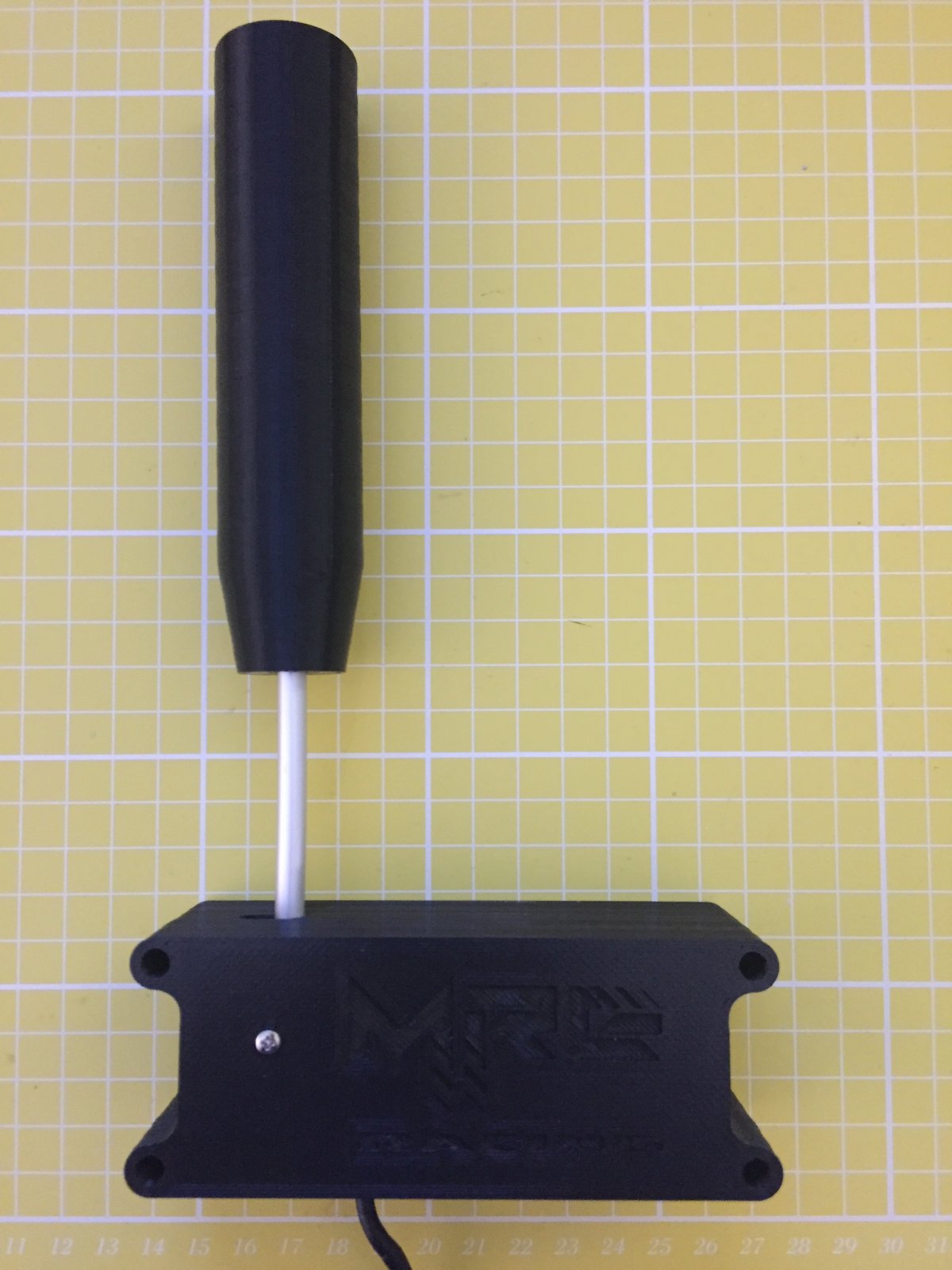

    My first handbrake design sucked a bit. It did the job but the feel just wasn't right.
    So I went back to the drawing board. Thought that a compression spring would be a better option so the design revolves around that concept.
    All 3D printed except the spring and screws:
    Final assembly:
    Added a bike handle bar grip to finish it off:
