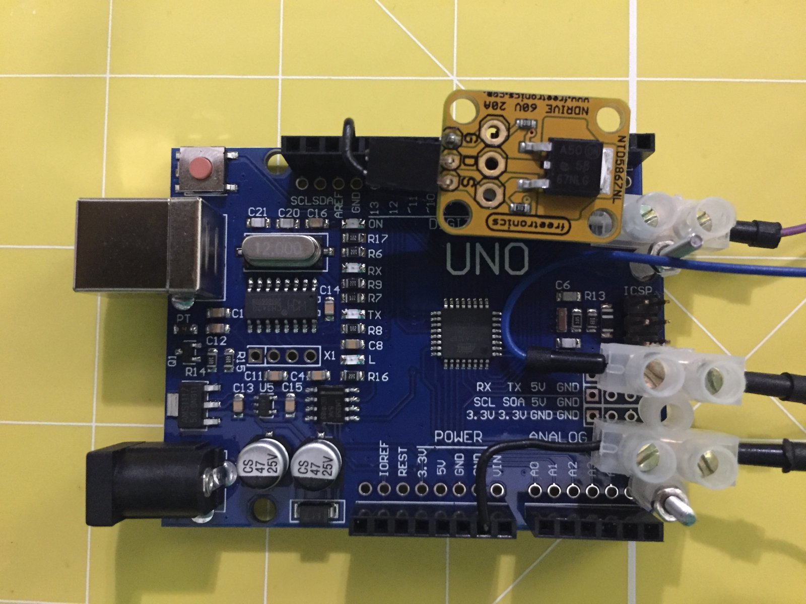

    I am adding a wind simulator to my rig using the method suggested by @eaorobbie
    Components are:
    Arduino Uno R3 clone - £5
    Freetronics Ndrive https://www.freetronics.com.au/products/n-mosfet-driver-output-module#.XiTeZxffWnM - £2
    12v twin head car dash fans https://rover.ebay.com/rover/0/0/0?mpre=https://www.ebay.co.uk/ulk/itm/153781142535 - £8.50
    Total - £15.50
    It will be powered off the 12v DC PSU that's already on my rig. The fans only pull 1.25 amps so would only require a small 12v psu for about £4 if required.

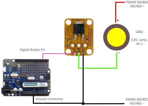

    The circuit (substitute light for fan)
    Finished circuit
    So far I have tested by using the example fade analogue sketch in the arduino IDE and it works as expected.
    Next will be to upload the code provided by @eaorobbie and get gamedash working and fans spinning using game data.
    The fans provide a decent amount of airflow and will be good enough for my needs, although they are not the quietest, especially when spinning up from low voltage - quite a bit of coil whine. Very simple to change to any other fan later down the line. The Ndrive can be used up to 60v 20A.

    The wind sim is now fully working using the sketch provided by @eaorobbie as seen in this test with LFS
    The added vr immersion is really impressive and all for £15 :thumbs

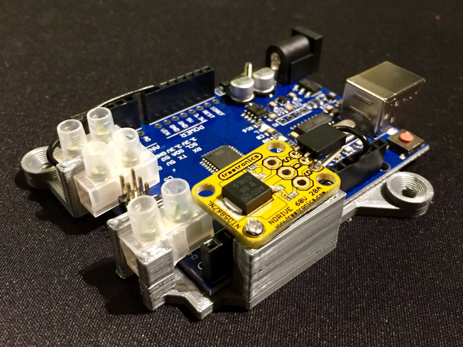

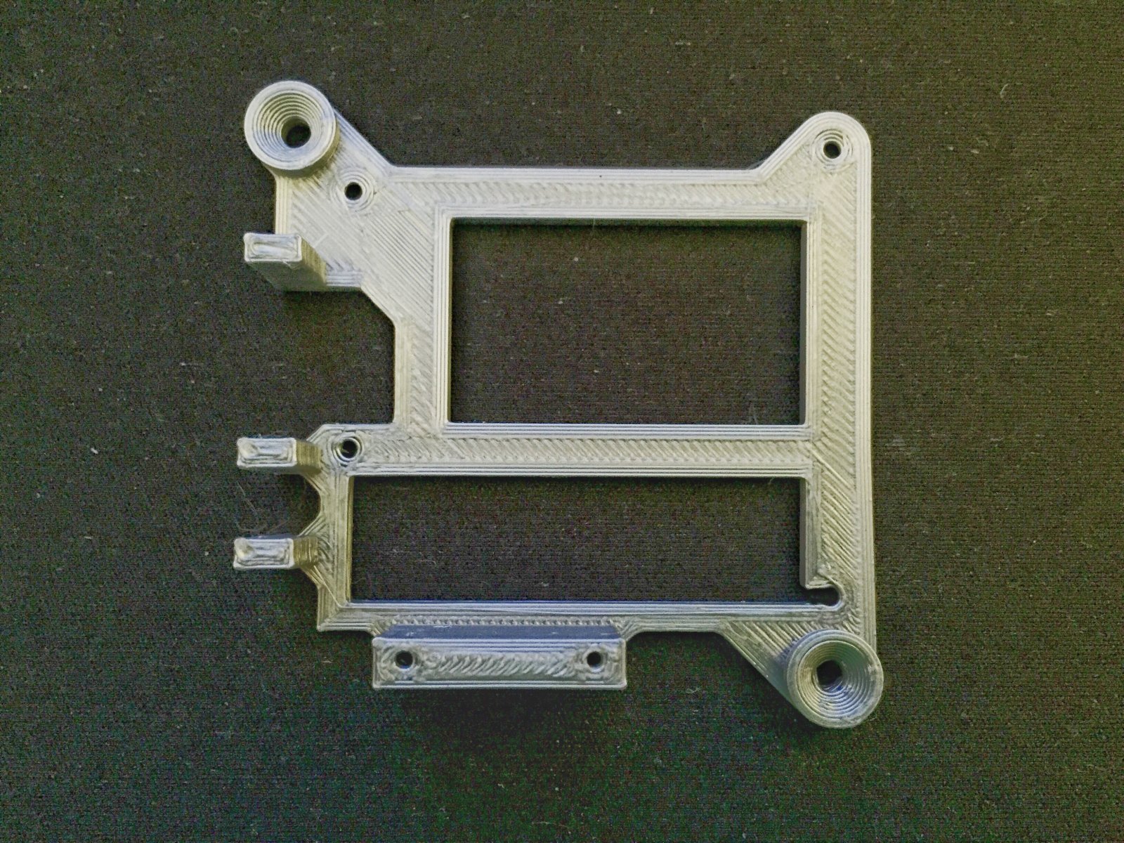

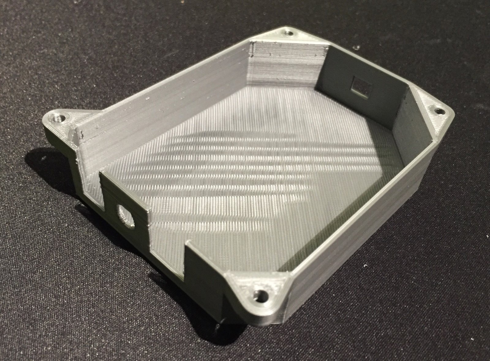

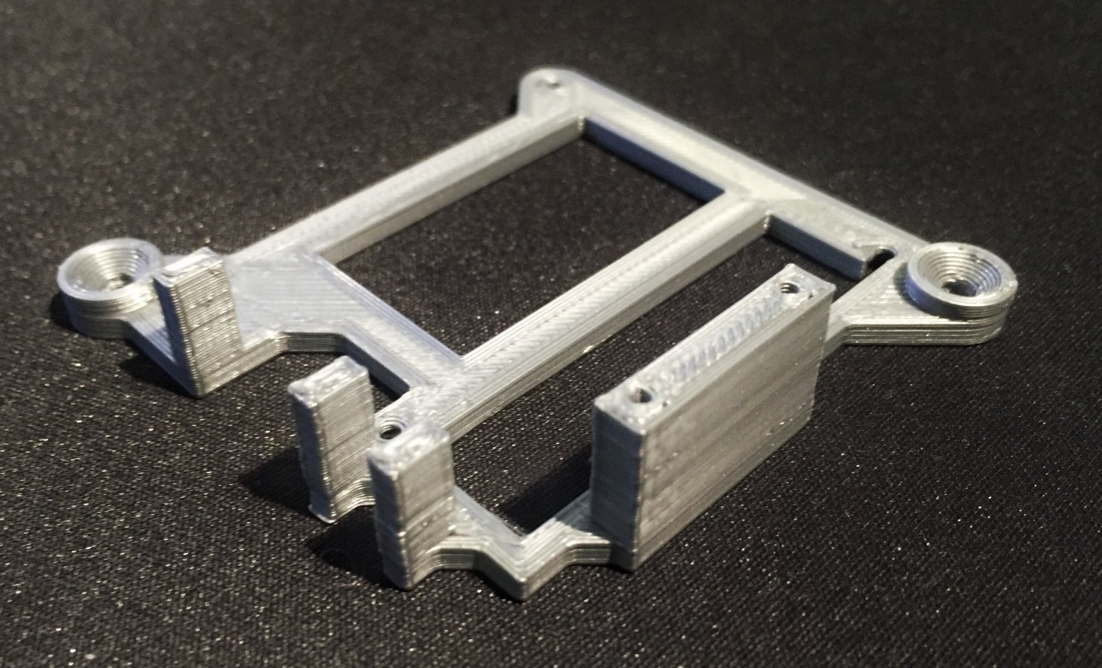

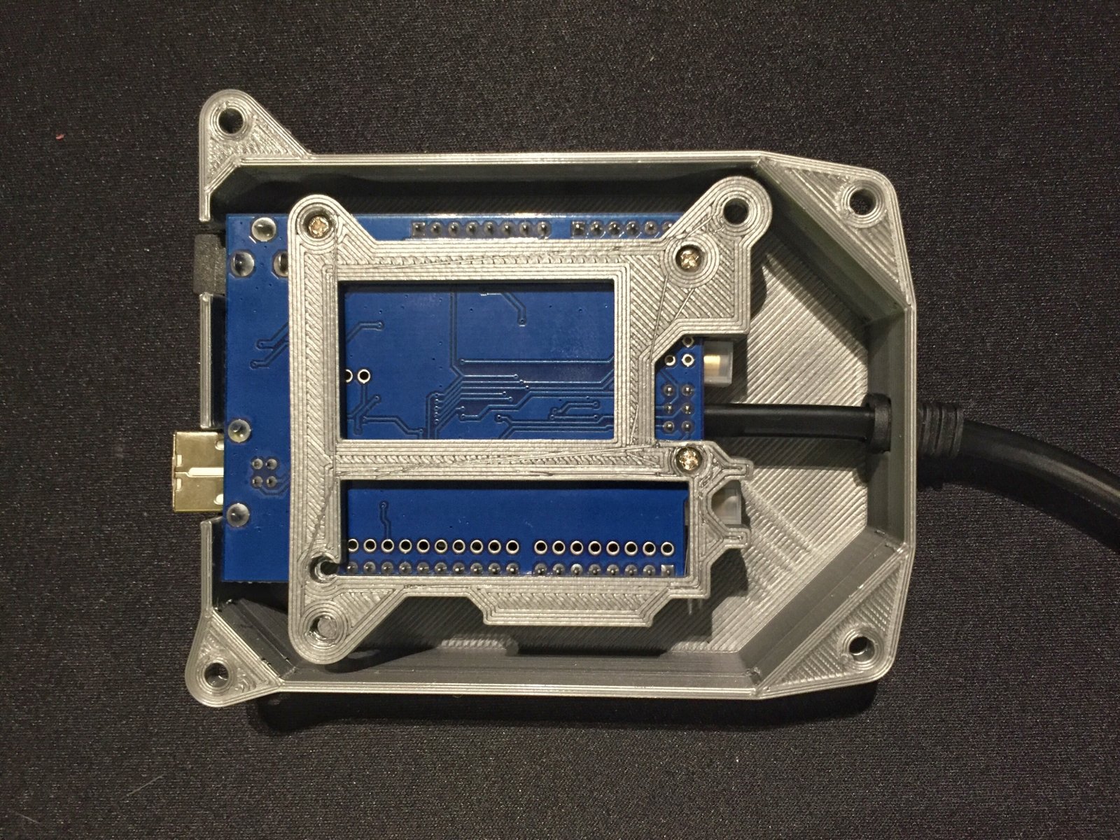

    Tidied up the circuit and created a mounting plate and housing to be fixed to the underside of my rig
  8. early_m
    early_m Active Member
    Jul 28, 2016
    334
    Chelmsford
    832Coins
    +354 / 5 / -0

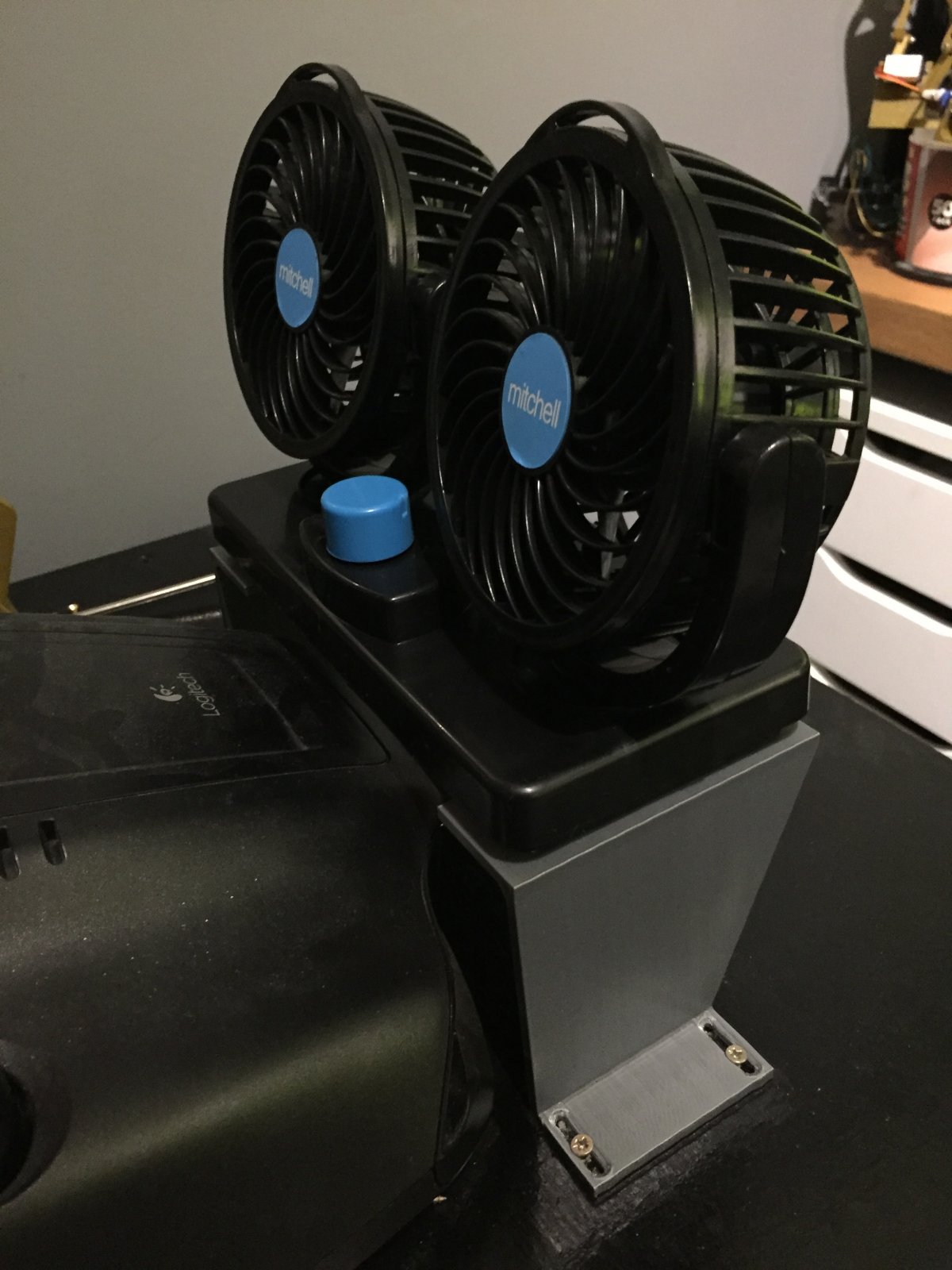

    Wind sim completed with fans mounted on 3D printed bracket
