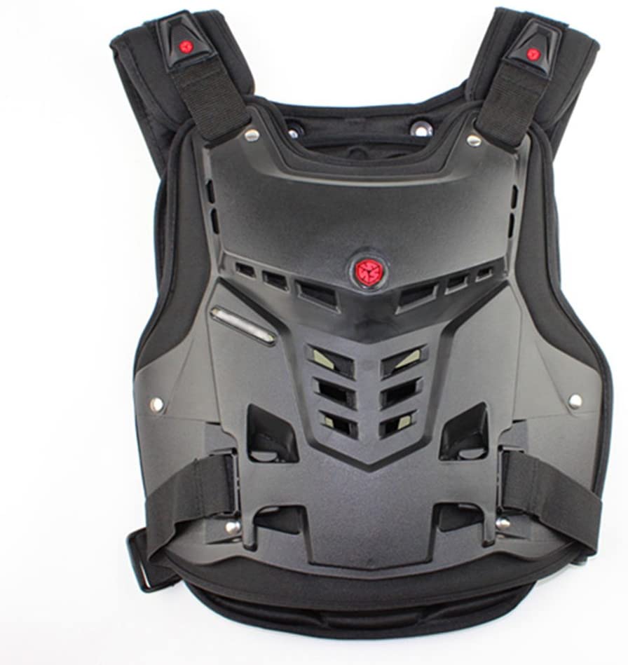

    I suspect something like this would work better as a west. Markus B has used medieval plate armor for it too. For my part id like something i can easily jump in and out of thats attached to the rig.
    Im going to check out a bike shop (dirt bike armor/protection etc) tomorrow and see if i find something suitable for my G force system. Its rigid but still somewhat flexible and i predominantly need surge forces but ill look for good side coverage to allow for a good sway pull
