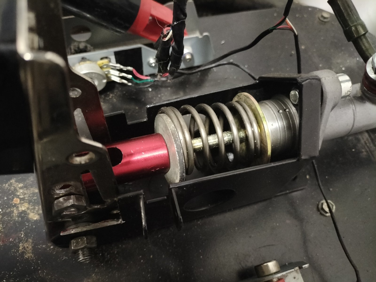

    I tried it without a spring between the pedal and the master cylinder, with a softer spring and finally with a harder spring and the harder spring brings the realisn and fine control you need.
    And now that I have set the max setting in the software back to 1024 (and the max the loadcell puts out is 1010), and the min setting above what the loadcell puts out at rest when the variable pot is at its most sensitive, I no longer have to adjust the software as the variable sensitivity pot is more than enough. I think this partly getting used to how the brake works too.
    And I also added a stiffer spring to the G29 throttle pedal so now I can be a lot more sensitive on that too and actually hold part throttle through turns.

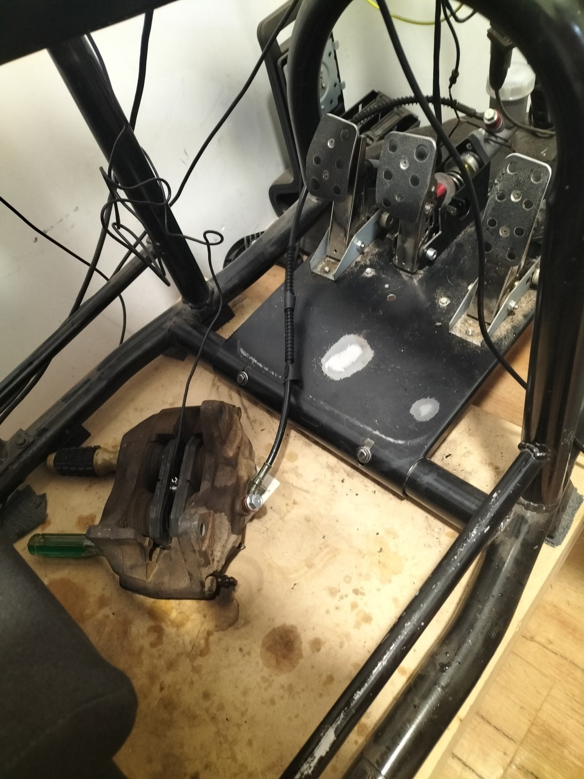

    And I have just reinforced my pedal plate so there is now no flex whatsoever.
    OMG what a huge difference.
    I didn't realise just how much flex there was and how much it translated into a 'squishy' pedal feel.
    Now the pedal is rock hard and when you just push on it (without being in game) and watch the movement there is just a couple of mm travel. But once you start playing it feels like more but it is so precise now.
    I had the brake range setup from 120 min to 450max and one of the problems that at the end of the range (where all the flex was happening) I could never quite get an exact/stable max brake pressure reading. When I pressed what felt like 100% there was always more to give but it was that extra bit that felt squishy.
    Now I have backed the max down to 360 and I can hit that mark and stay there and it feels like I am at max pressure, even though I can still push harder and go over 100% when I panic brake, as you would in a real car.

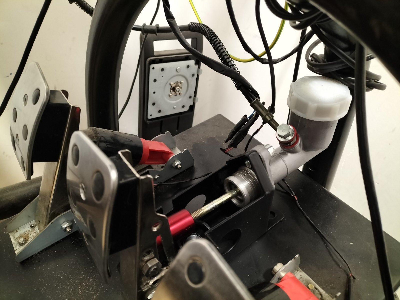

    So still not 100% happy with how the brakes feel and thought I should play some more. So I moved the pedal ratio so it is now really hard to push. I have done this before but had the settings so you hard to push really hard to get to 100%. This time I set 100% to be just moderately hard - basically as hard as I normally brake rather than as hard as I can brake.
    OMG what a difference. With the pedal hardly moving and feeling physically harder under my foot, but actually responding as if it is a lot softer, it makes it so much easier again to max and modulate the brake and trail brake all the way to the apex.

    Pedal lever ratio set to high and software set to low.
    So I have really good control over the amount of pressure I am exerting and much easier to ease off slightly but with the low software setting it is not hard to get to full braking. Took a bit of practice to retrain myself not to press so hard. It now feels natural and much more lifelike.

    One more little tweak - added this spring to push the pedal back. Wow what a difference that made. I have had a spring in there with my other master cylinders and it didn't seem to make much difference, but this one is a game changer.
    I have been able to drop my minimum position in the software and still not get any lockups and trail brake even more into corners and it feels even more realistic :)

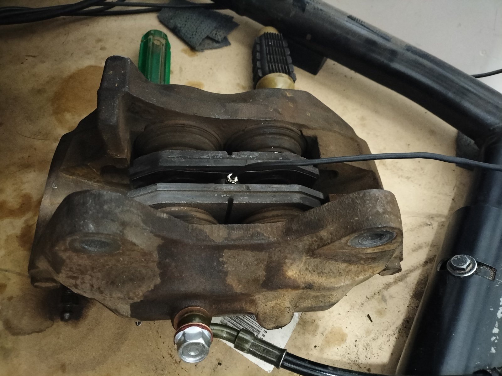

    Another upgrade - this time to big 4 pot brake calipers
    That has given more of a road car feel to the brakes with heaps more travel (as expected :) ) but a lot more mushiness (more than expected :( ).
    It does seem to be better but there is too much pedal travel and I can't comfortably reach full limit of the pedal travel. Even with that though I just did my PB lapin my favourite M3 GT2 at Spa
    I think it is too big a step from the tiny 2 pot moped caliper. so am going to try again with a smaller car caliper, but I think it is another step in the right direction :grin

    I ordered a 4 piston bike caliper but the AliExpress seller couldn't supply and issued a refund and in the meantime I swapped back to the 2 piston moped caliper.
    But this time I set it up with more pedal leverage so it is softer and more like the feeling I was getting with the big car calipers. Been using this now for quite a few weeks and definitely got used to it and think it is pretty much as good as it will get.

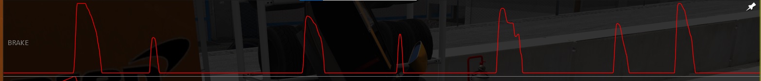

    here is my brake trace for 1:24.5 lap with MP4 at Laguna MP4 Laguna Brake trace.jpg
    Smooth Operator ( in my best Sade voice )
