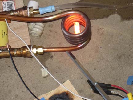

    I guess they have quite a high frequency applied. Useful for brazing - not magnets ;)
    But add a suitable core and you could easily saturate it at lower frequency. :cool:

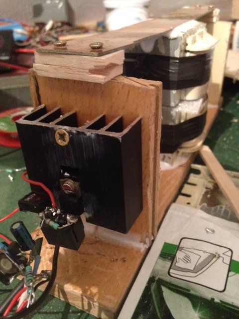

    pretty good idea, I just found a source of free available electromagnets:
    I take the ballast from obsoleete HQI Lamp fixtures. They have about 8 Ohms, so no need to recoil them! Every store is nowadays changing to LED lightning, so they throw out their old lightning utilities. I used 2 in parallel, one on top of the other.
    And you are right, considering square waves. Sinus or music like waves are for magnets unsuitable, they need on and offs.
    truely Johannes

    Here is a circuit that I`ll try, I´ll post it in my next posts.
    Ne 555, astable smith trigger, base freq 1-10Hz, and controlle the freq by musik. A power FET will make those Mags rumble. A car battery 21 V hsould be fine, may be 24V .
    truely Johannes

    The I plates came of quite easy.

    This is what I came up over the weekend:
