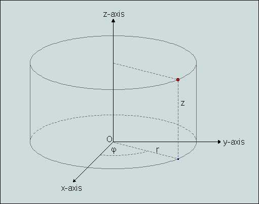

    DC motor
    Hi @wannabeaflyer2
    You asked this question in September
    i read everything in your thread but couldn’t find someone to answer this. And since i had similar questions, there could be some more guys out there who would be happy about an explanation^^
    The simple answer is: NO. There is absolutely no difference, if you fix your actuators the same way. The only difference will be, that your motors will consump more power due to the higher weight of he bigger top platform.
    I’ll try to explain what changes influence the rotational and translational movement of he upper platform.
    First we need to difine a coordinate system. In this case a cylindrical would be the best:
    You have the axis z. The radius r and the angle phi.
    For all examples we have have identical actuators with a defined lengths and the same lift.
    Also it’s good to know, that sway and surge are influenced together as well as pitch and roll.
    Lets start with 2 platforms with identical radii. The fixing points of the actuators can now only be moved with the angle phi on the bottom and the top platform. If you choose the same angles phi (difference 0°) for both you will have:
    - actuators parallel to the z.axis
    - the most heave possible
    - a good pitch&roll
    - no sway, surge and yaw
    So this would be olny a 3DoF rig although you use 6 actuators. And if you don’t fix it in y- and x- direction you’ll soon have a 0DoF rig, due to the fact that i will collapse;)
    If you raise the angle phi or the radius r you will decrease the possible heave!!

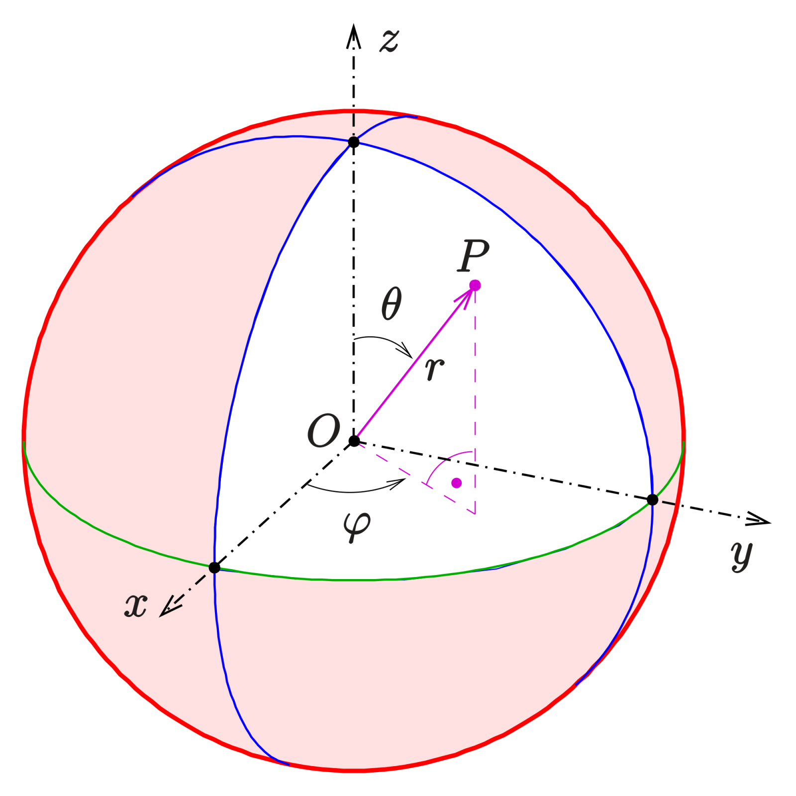

    Next step is maximize the pitch/roll. The actuators are still fixed with the same angle phi 0°. If you reduce the radius of the upper platform you will increase the pitch/roll. You could say, you reduce the CTC length. With this you also introduce sway and surge to your platform, so we have now a 5DoF rig. Raising the radius r and the angle phi will result in a lower roll/pitch movement.
    How to influence sway and surge? If you look from the top to the rig it's the easiest way to imagine. You'll have the maximal surge and sway if your upper platform lies IN the bottom platform in the x-y-plane. The radii have to be chosen depending to the length of the actuators. You won't be able to heave and roll and pitch your platform, since you work in two dimensions. (I know, if all actuators will move out, it will heave, but maybe downwards;) ) If you now raise the radius r of the upper platform, your upper platform will be higher and you'll reduce the possible sway and surge. You also can influence sway and surge with the angle phi. If you still look from the top on your rig you can estimate the possible sway/surge through the length of your actuators. You also can go to the spherical coordinate system of the actuators and simply calculate it with the angle theta:
    The higher the angle theta is, the more sway and surge you'll have, BUT it'll reduce the heave.
    Let's introduce the 6th DoF, yay traction loss. Since we didn't use the angle phi yet, this is the one we need to rotate our platform. The higher the angle phi, the higher the rotation yaw of the upper platform, easily said.
    This is what i came up with after racking my brain for some days. So, no guarantee that anything is correct:roll if someone knows more, please feel free to correct me. I would have been happy if i'd found something like this some days ago:D
    And sorry for spamming with such a long post^^
