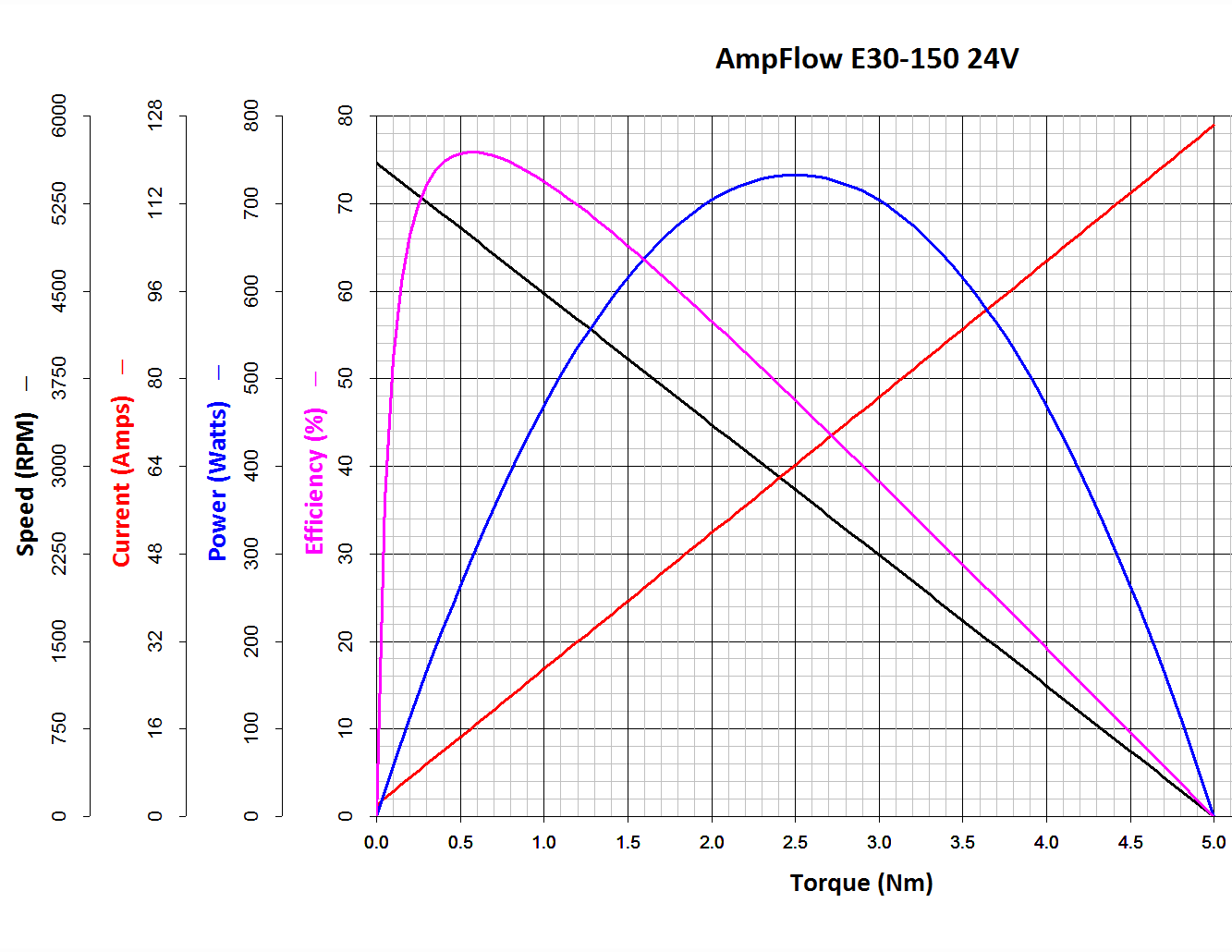

    monster motos at first because I have them but sabertooths(up to 30v dc) are in the plans. muahahah:D
    1605 ball screw with 5600 rpm. not sure about the math but that is the unloaded speed so it wont really apply anyway...

    I am sure about the Math :):
    @5600 RPM they move at 466mm/s. If you use 1610 ballscrews they will move at 933mm/s. Unloaded of course. IIRC my motors develop max power at ~80% max RPM. That means you could still expect ~750mm/s (if your motors can deliver that).
    All in all I'd expect the 1610 to give you insane actuation speeds at the cost of greatly reduced acceleration performance or greatly increased cost for motors. Certainly a 50% loss in precision in any case. Your choice.

    how would they be less precise? same position sensor with same resolution..... just more inertia to change direction. more torque to move
    they are 733 watts pos. stall (1hp). and run at peak efficiency at .4hp 310watts (5000 rpm @17amps 24volts) 5000rpm on a ten pitch is still >833mm per second no load.
    the acceleration is my main concern tho, i'm sure it will be fun if it doesnt break.

    You're right! I was mislead. In my own design I was planning to pick up the position directly from the motor axis through a multiturn encoder. So, after the control loop did its Job, there would still be the mechanical inaccuracies in the system. These would double.
    If you pick up the position directly from the shaft, that would be quasi negligable. Sorry!

    The problem with opting to use a 1610 ballscrew instead of a 1605 is that the output torque is halved. You'll travel twice the distance per revolution and the load and motor size remains the same therefore more torque is required. At least that's my understanding of the physics required.
    Power = Torque x Speed.​
