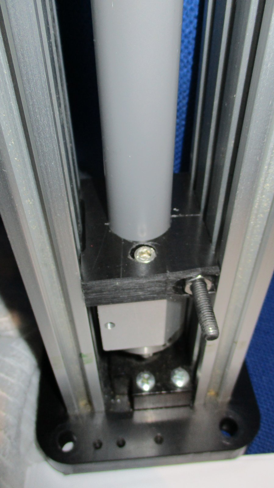

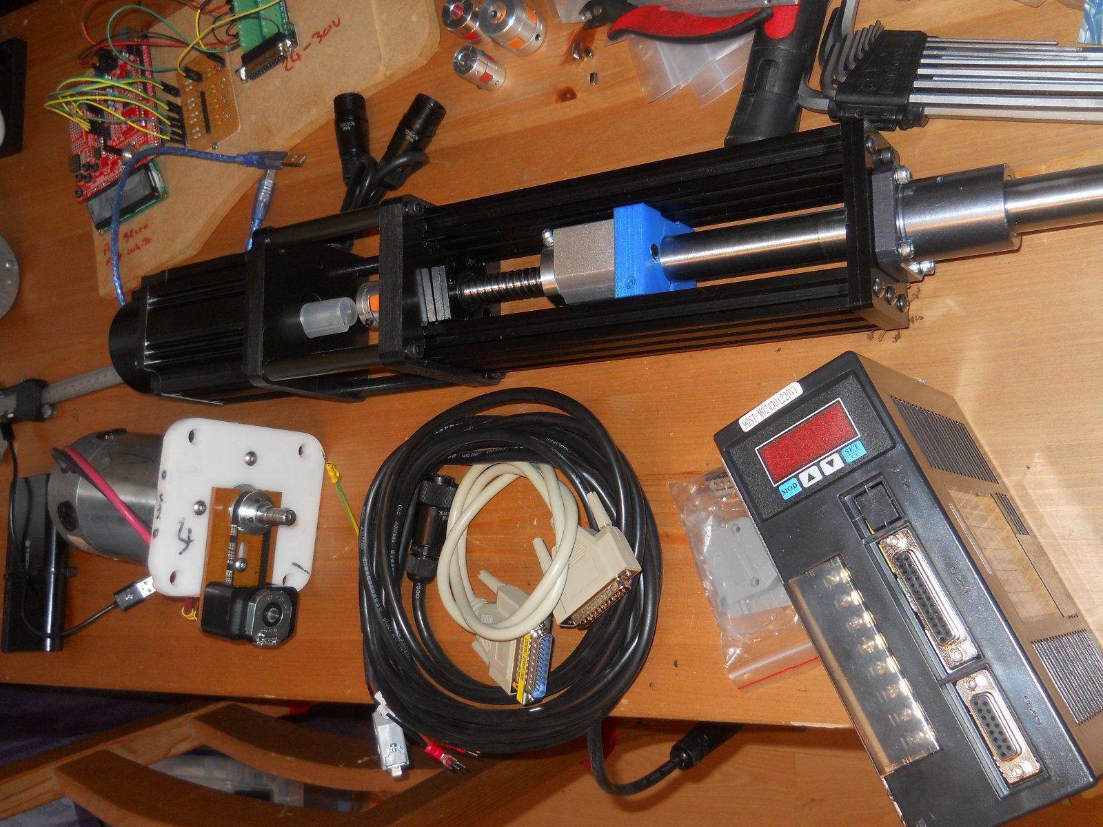

    Hi @motiondynamics as mentioned yesterday this is the option im introducing to my Actuators to make use of off the shelf Ball Nut carrier , I will need to drill and Tap an additional 3 x M5 ( 15mm deep holes) to the purchased block I think they are less than £5.00 each ..
    The photo shows the 3D printed Rod Mount and there will be 2 Adjustable sliders to dial out excess ball nut carrier rotation.. also while I have the Actuator apart i'll had the Optical encoder GT2 40T pulley to the Motor Shaft .

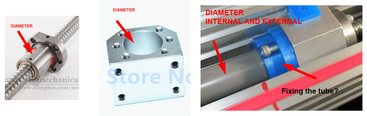

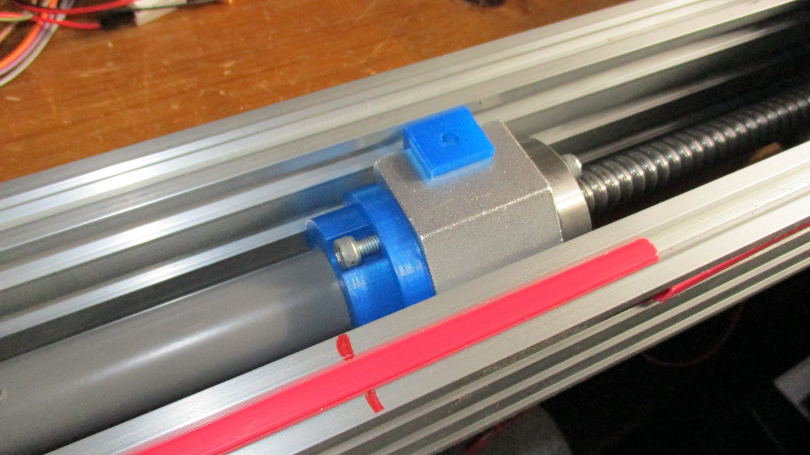

    Hi wannabeaflyer2,
    congratulations for the idea you had, in this the Ballnut replaces the piece that you would have had to print in 3D, shorter waiting times to create the piece in 3D and print.
    Two curiosities:
    1) I read that the diameter of the steel tube is 18 mm inside and 20 mm outside (1 mm thick metal), so I suppose the diameter of the Ballnut attached to the ball screw is about 18 mm, which the Ballnut extra, it has an internal hole with a diameter of about 20 mm. Is it so?
    2) The 20 mm tube, how was it fixed with the two Ballnut? I saw on the photos a piece of blue color attached with the tube, but I didn't understand the method of fixing (a passing screw? Or glue?)
    Thank you

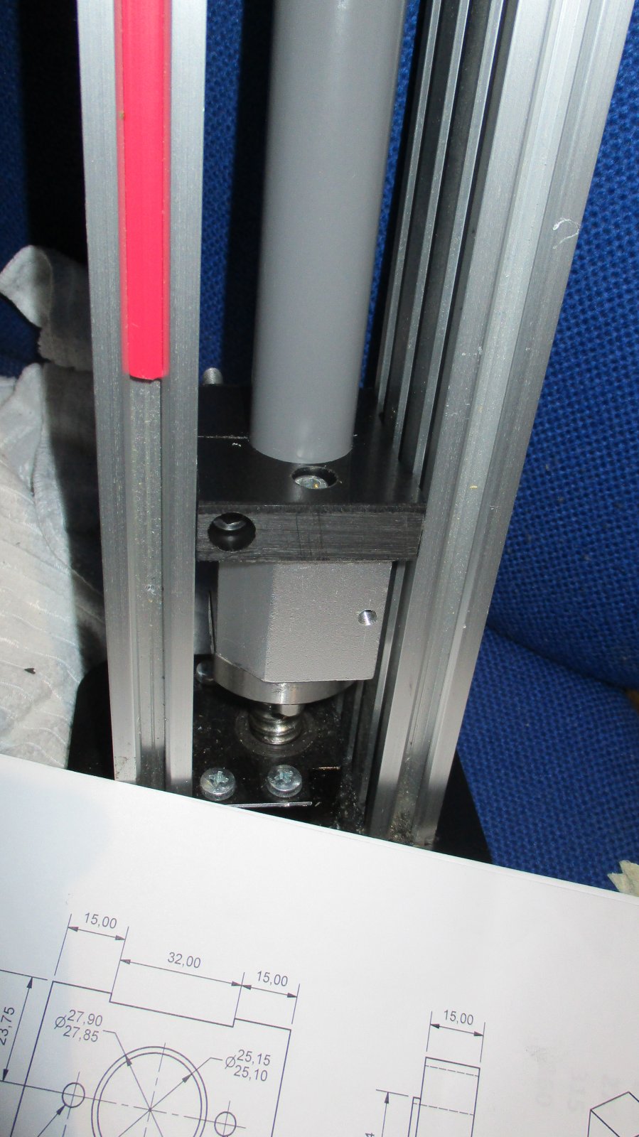

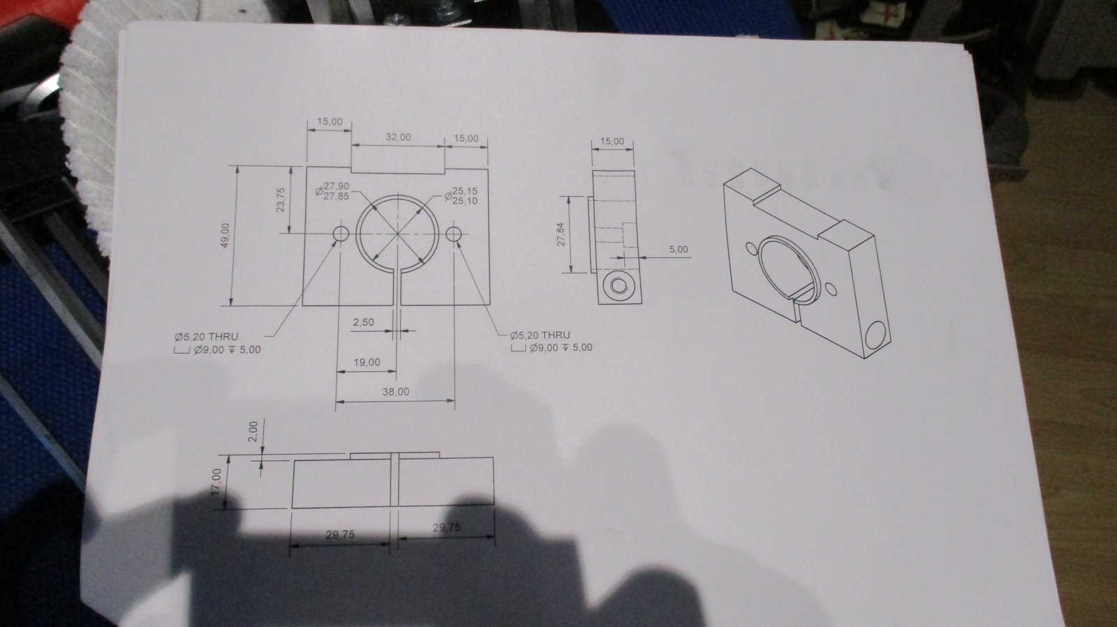

    Hi @motiondynamics I just today did a drawing of the revised Adaptor which can be 3d Printed or |Made out of Ali / HPDE plastic .. Gimme a mo to photgarph the drawing and i'll add it to this post later , 9 Gotta find camera as I forgot to e-mail it to myself at home LOL ) .
    My Steel tube has a 25mm od and the Ball nut is 28 mm The clamp has a hole reduction feature to match the chosen Tube ( Carbon Fibre . Metal whatever ) centrally to the ball nut and is locked in place with a Pinch clamp feature built into the adapter ,, ( as most of the force is applied vertically ) this pinch clamp idea should be Fine ..
    the one shown in pic was done on cnc Lunch time so bit rushed but the idea is there , its clamped to the ball nut holder by x M5 screws and has a 6mm Nut and bolt at the base to clamp onto the tube to prevent tube rotation or being pulled away from the adapter block ..
    Tomorrow i'll clean up the sketch and show a cutaway section of the assembly .. the loaded platform weight is transferred directly from the rod to the top face of the ballnut . well that's the theory ..
    so the 3d printed version in blue was proof of concept the Black ( Delrin -Acetal Co Ploymer ) CNC version I think will be my choice ( mainly because I have access to this machine at work in free time .. my Home cnc is in bits ... making it bigger) but missing its use for stuff like this .. Cheers

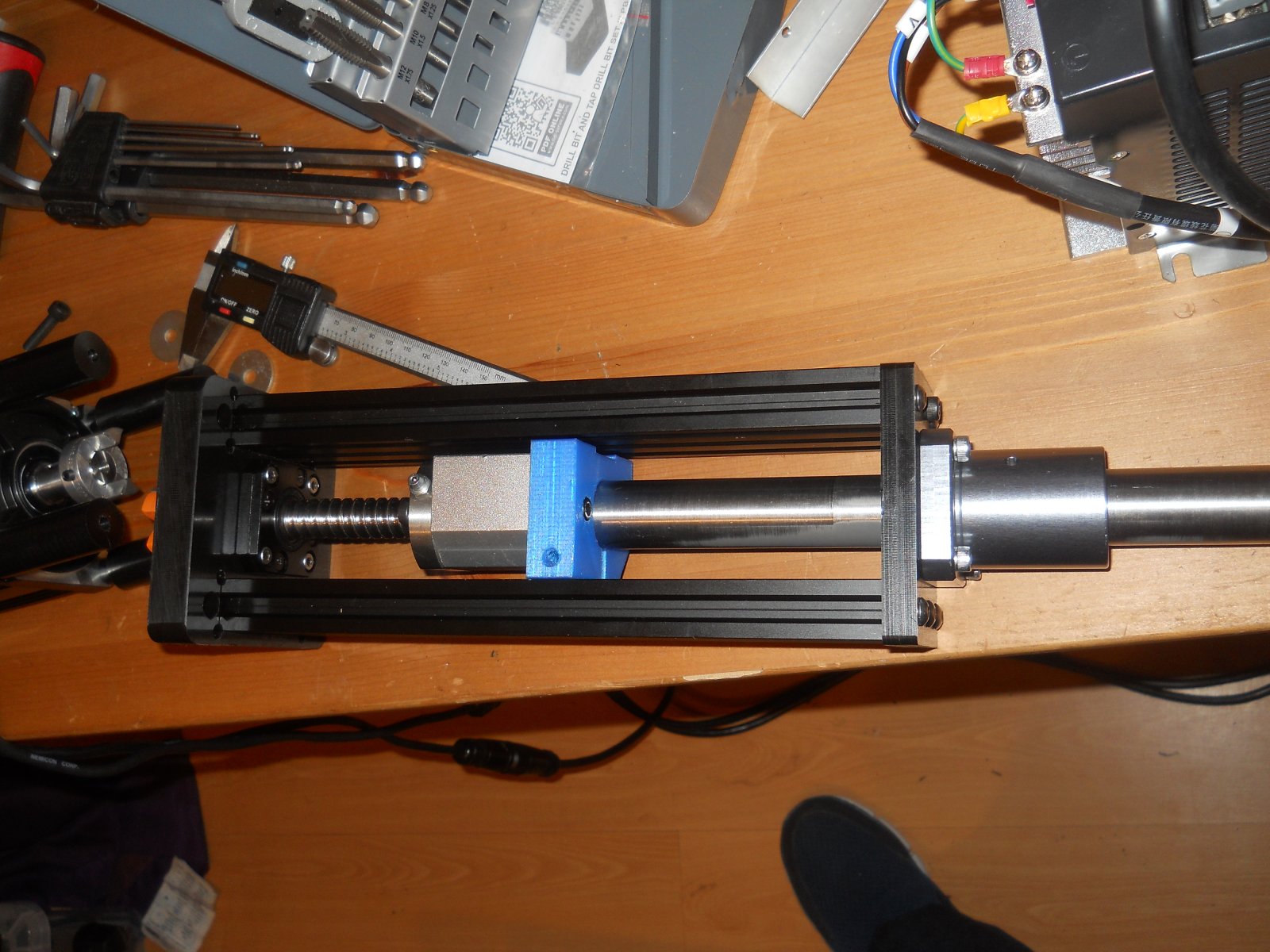

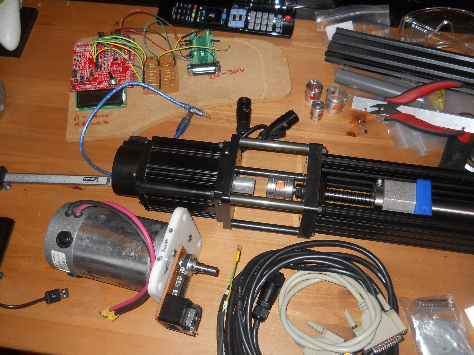

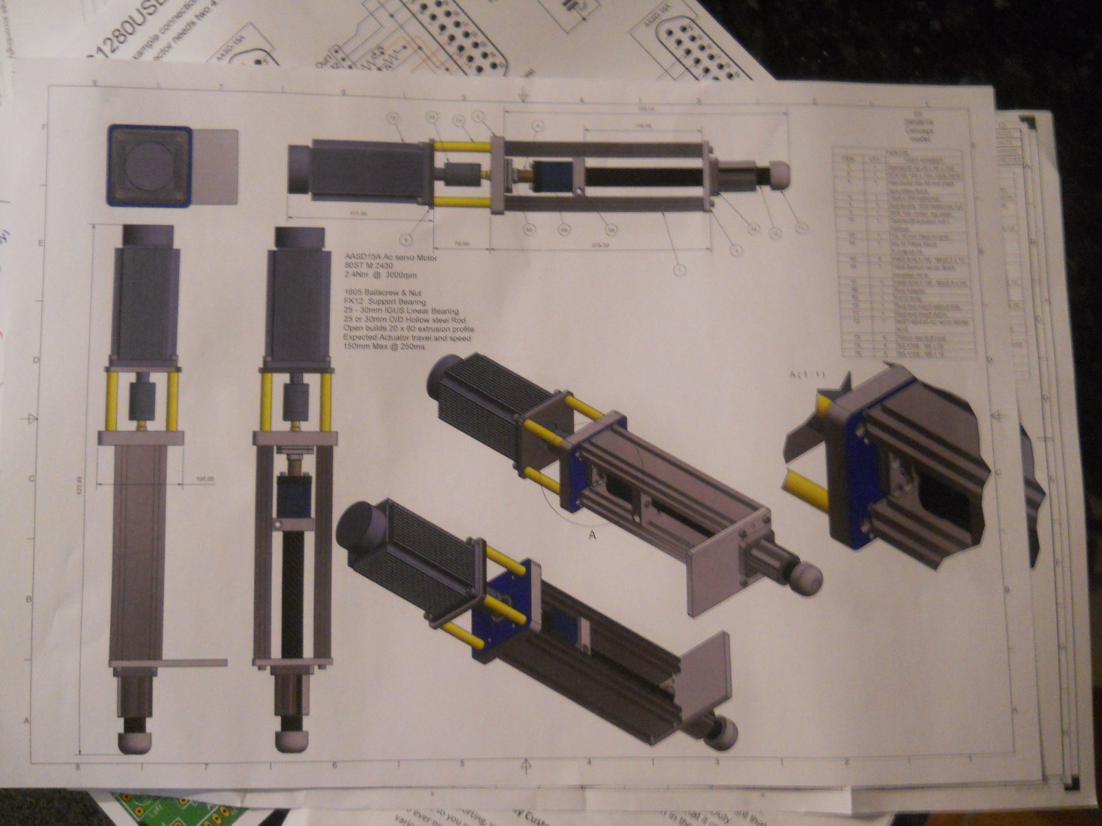

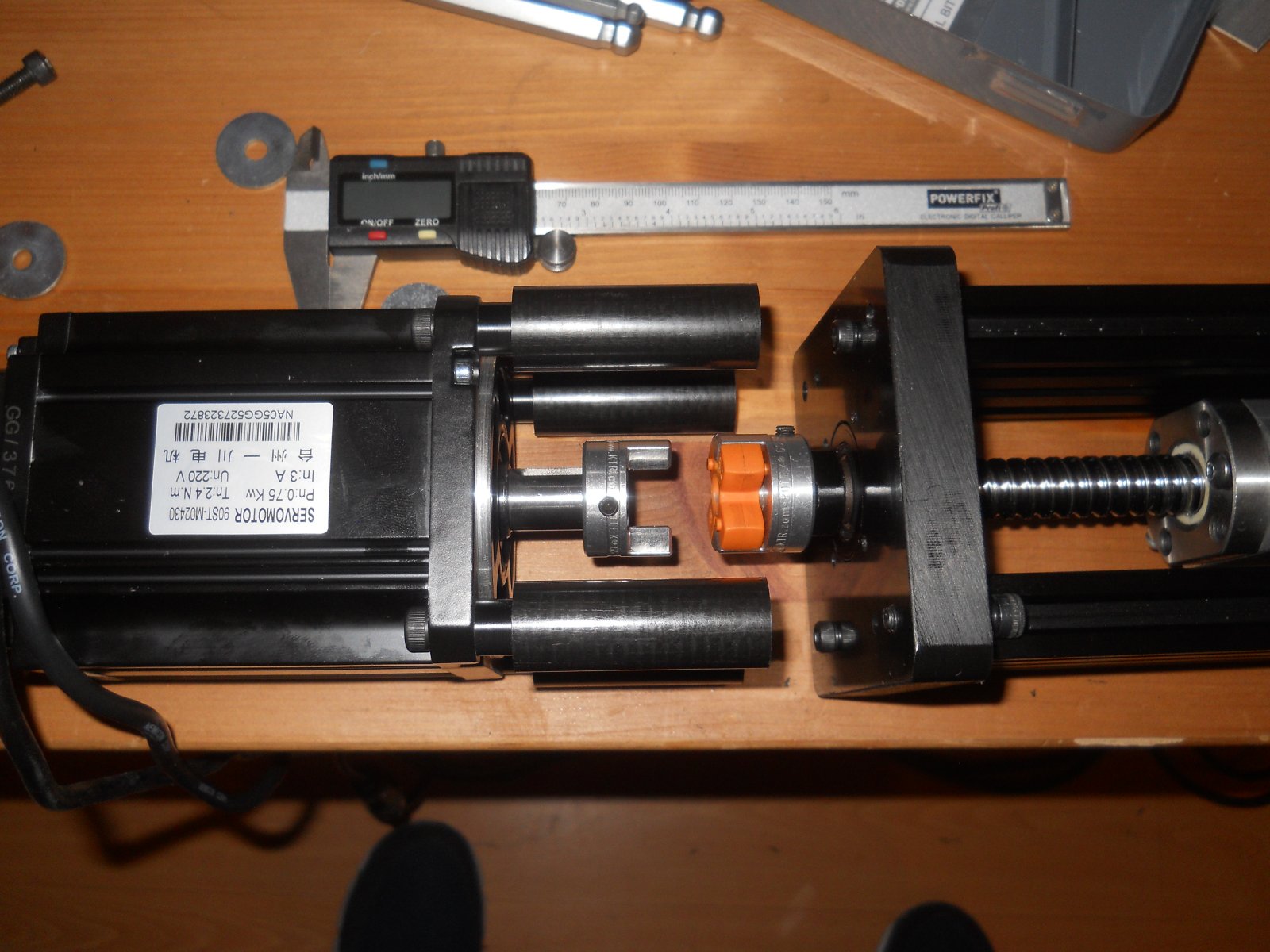

    Hi Guys , As a master tinkerer and general I can try that kinda guy , I have decided to embark on a 5 DOF simulator using these ever popular AASD15A AC servo Motor Drive / Motor Kits .. always had this bee in my Bonnet about using encoders and this system looks like it will fit the Bill ..
    I'll start a New Post for this new Endeavour so this is just a teaser , The new actuator I just built is a Derivative of my Trusty ol 6 DOF unit ( just scaled down to allow 150mm total travel ..
    Cad drawings are now in last stages before release but those familiar with the MK1 version will see no major changes other than the Motor used and some small tweaks .
    If these Motors Perform as well as they seem to , then im looking to swap my DC units out and replace them with these AC servos . Some changes will be needed to the New Motor Mounting arrangement but totally doable so I'll still Have 6 DOF setup and running and a 5DOF Car racing sim with Traction Loss..
    Basically this new system will be Wannabe's version of the SFX unit but with my Tight arsed trying to save money mods LOL .
    So without further ado here are a few teaser Pics ..

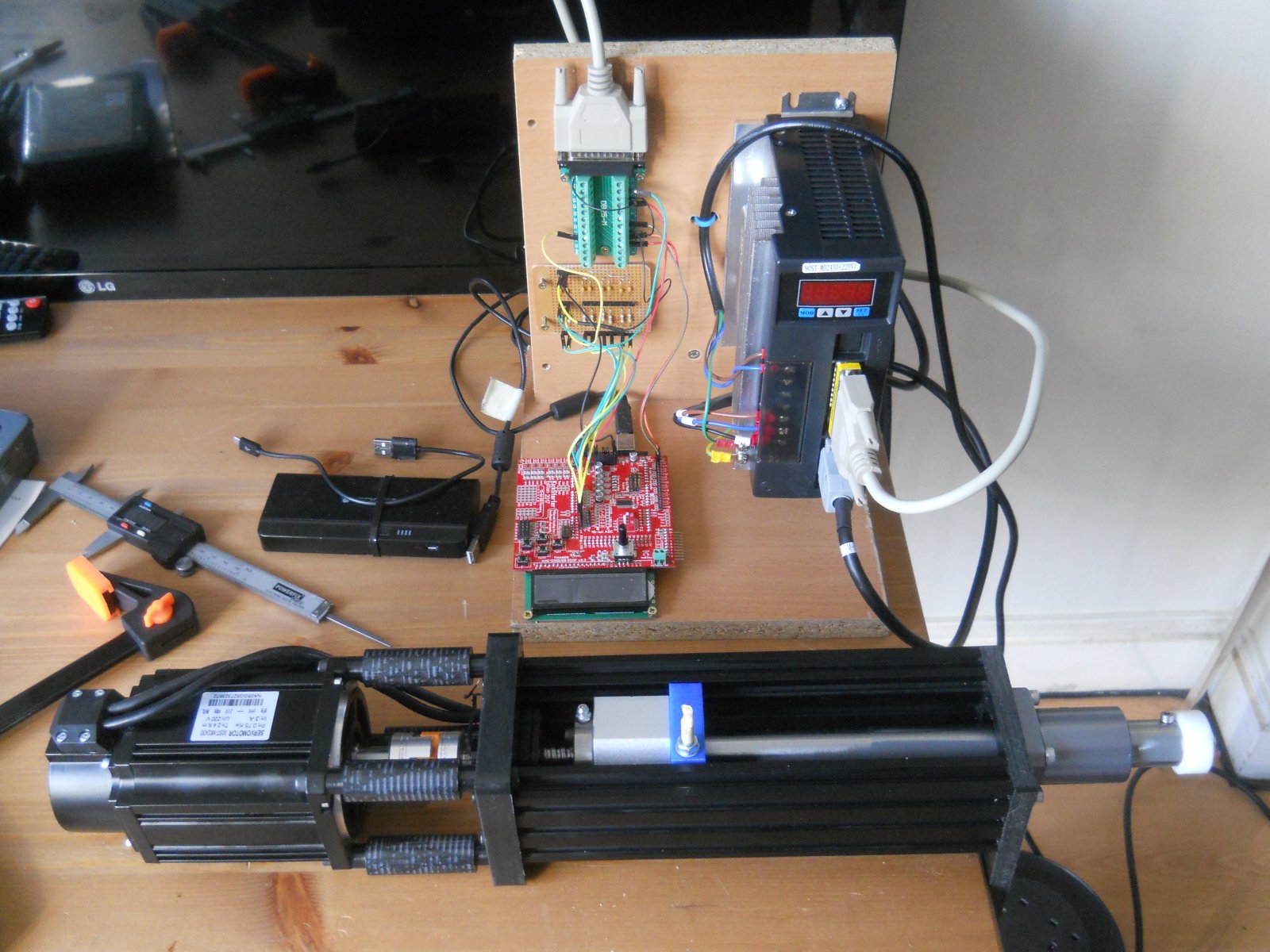

    Doh Forgot the 1st Draft Cad Pic
    Happy to report the 1st round of manual testing went greta actuator works a treat ,
    Using my Barebones AMC128USB with AASD15A firmware and connected to AASD15 Controller via a Bread boared Lash up ..all ggod
    Self Homing Works ,
    No Limit switch required ( But these can b fitted if user needs them )
    Next Step Simtool V2.04 Control Then I will be cooking with Gas as they say ..
    Currently Only bought one controller / Ac Servo Set as test assembly, But looking good so far IE "does what it say on the tin " just like the advert :)
    Just need to tidy Up the last few Bits on the Actuator .. NEW POST coming guys

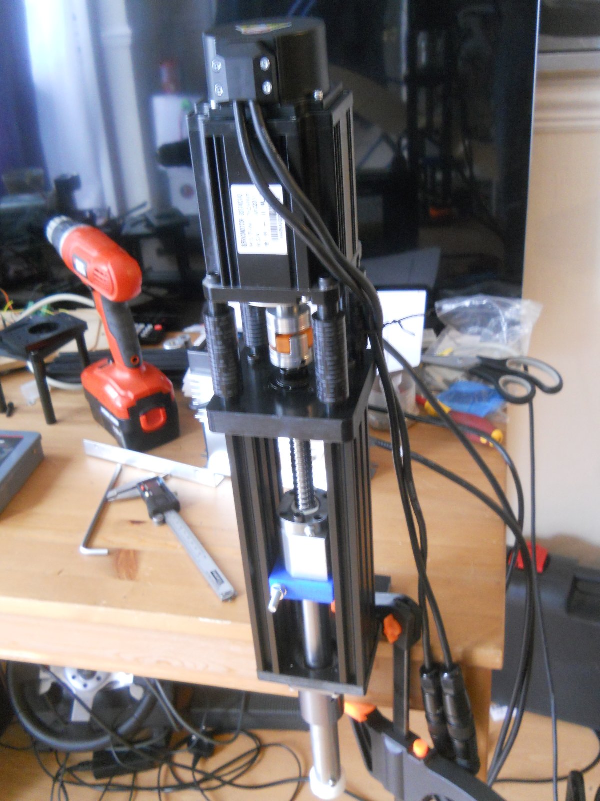

  8. wannabeaflyer2
    Jun 12, 2015
    724
    london uk
    8,357Coins
    +958 / 7 / -0
    One mor LOl then i'll bugger off for the day
    Note speed turned down for these initial test ...This puppy will go a bucket load faster once I get brave enough :)
