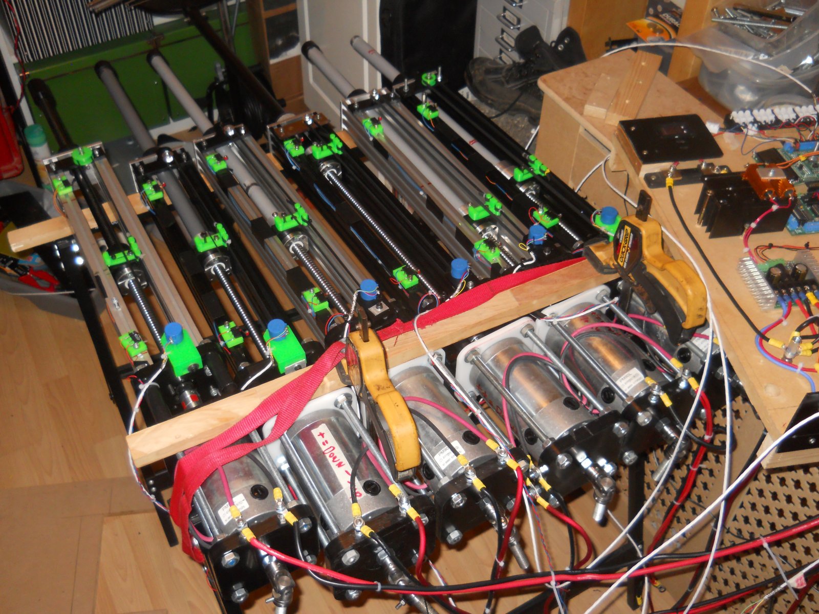

    hi guys been a busy few days but I'm seeing light at he end of this tunnel, all 6 actuator fully assembled and now just fine tuning them to make sure travel and limit switches and movement range is in synch , and can be operated in manual mode as well as under Games control, see attached picks , had to remove them from the base so as is all things wannabe style , this is a development setup for testing only then ill remount everything in the knowledge that it should be in the ball park before load testing in earnest ... :)

    Man this is incredible and you providing cad drawings pdf I must say I am impressed with your acuator design I was just about to pull the trigger on some motor and gear boxes I'm glad I found your thread this is the way to go and as far as upkeep goes mabey one day replace some bushings and pots can't wait to see it completed great job

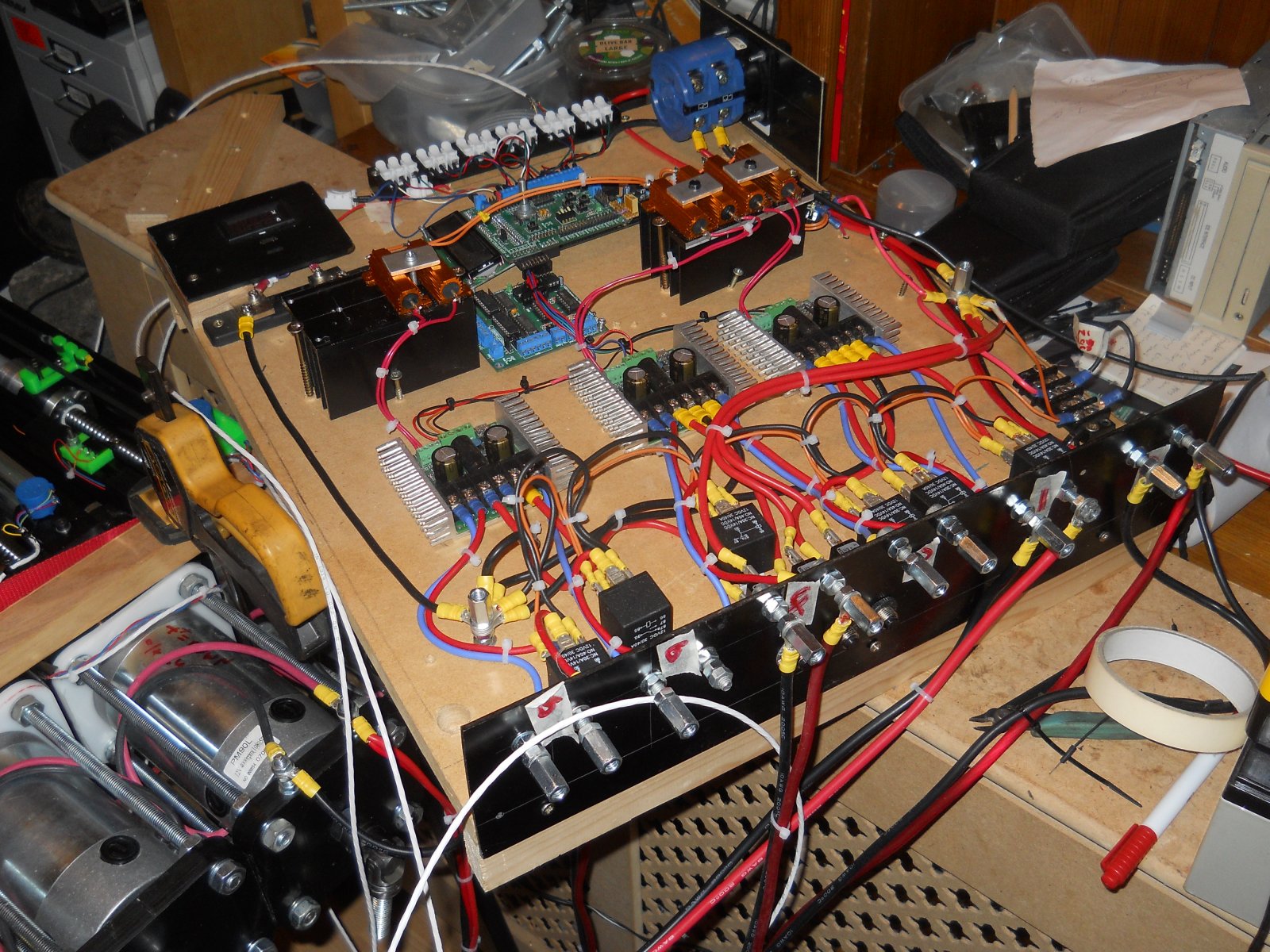

    Hi Guys some good news after all my mini mistakes wiring wise , im pleased to say the AMC128USB controller seems to be working fine with my Sabertooth 2X32 motor controllers and 12 volt Car battery as temp supply for testing only, and i can see the motors moving as i think they should when Running Ians BFF 6 DOF Software,
    Limit switches connected a minor thing i think i will need lever type limit switches instead of the roller ones i currently use :-( so back to Ebay and maybe a small redesign for the limit switch mounts ( 3D printer will pay for itself yet again LOL :) )
    Still doing basic testing ( NO LOAD ) but getting closer guys
    Next Phase is to Remount the Actuators to the Platform base and then the Add Temp Upper Platform to assess movement angles and check for possible mechanical clashes and then staged Load testing .. as always Will keep ya'll posted ...

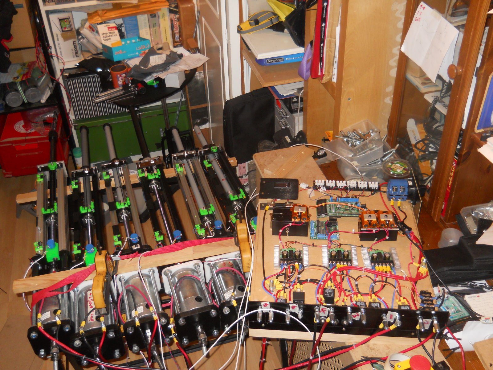

    Well Guys way way overdue but just had to report the beaming look on my face as I have now gotten to the its moving stage LOL:)
    A bit pleased with myself at the moment , 1st basic test verify the movement of the platform and linking nicely with the Software .. NO SMOKE , NO MECHANICAL CRASHES YET lol Sorry guys had to shout im feeling that good at the moment , here is a brief ( trying film and not crash video ,
    first Things first er IT Bigger and Taller than I thought LOL
    second thing The Bed in the spare room will have to go ( Visitor now have the couch )
    third all settings are lowered ie Speed , Movement range , Power, etc just for testing so will be gradually increased as the confidence levels Grow. ( or until the 1st Big Bang )
    Yes its a mess But in fairness I wanted to confirm basic operation before tidying up and making any mods which were flagged up during this testing phase ..
    Temporary Upper Platform fitted to assess Mechanical movement and travel and the Final COG should be a GOOD 300-400 mm Below the current platform actuator mounting points ( Ther frame will be stepped Like @SeatTime Great Example

    Then Stage 2 wiring tidy up , Strange problem though My limit switches and E-stop Work great but for some reason when they trip I loose the Com port connection to the AMC128USB controller so need to be careful as that also could mean the actuator will run wild ?? It may be to do with the fact I don't yet have diodes across the 7 relays in the system , so that's another fix .. All in all the sim platform dances around the skies Nicely so just gradually cranking things up .. Video will be posted soon ..
