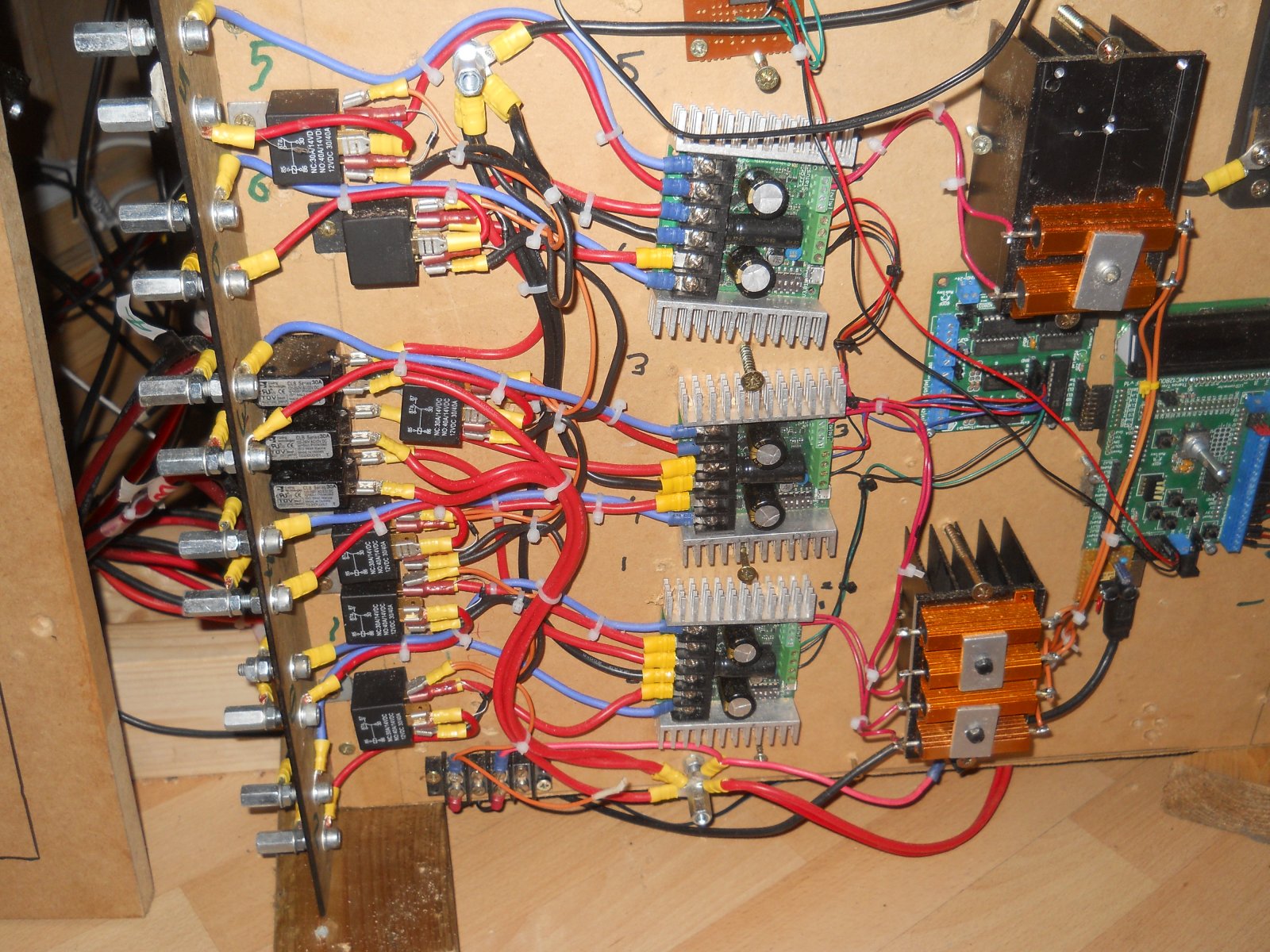

    Hi mate have you tried recording the diagnostics tab in describe I got some huge AMPS showing one peaked at 137amps which is way too high lol
    If yours is that low it means my rig must just be way way way to heavy
  4. wannabeaflyer2
    Jun 12, 2015
    724
    london uk
    8,362Coins
    +958 / 7 / -0
    Hi @SilentChill will have a look to see how I can get logging from describe later and post the results , My Platform is Not that light and the actuators should be capable of handling yours , like I may have mentioned I'm sure I'm Kicking towards 150KG all up mass with my big butt seated , but really now need to put some longer run times to see how it performs ( my short test times may not be indicative of the issues your highlighting ) ....... Oh Oh did I mention Hang In there Boyo it will come good :)
  5. SilentChill
    2,653
    20,660Coins
    +3,593 / 34 / -0
    I am hanging in dude :D (just)
    Heave you want to be testing that's what eats the power all 6 motors all hard reversing at the same time when at the bottom of the stroke, the further down you go say 75% of the axis and then a sharp move straight back up. Its easy to record in describe just run the diagnostic utility press record and name a file name and thats it. You can do it for all 3 sabertooths if you have 3 describes running.
    Yours maybe be spot on and its just I'm underestimating how heavy my platform really is especially on reverses, here comes my amazing maths lol something like the speed of the rig going down and then the force to stop the rig and then the upwards lift its alot of weight when you think about or is it force I dont know, its not just say 30kg its that multiplied by all the other factors. Hmmm whos good at maths I can tag in
    I have set the power set to a low 180 and the heave set to a pathetic 5% of axis and I can just about get a stage done in Dirt Rally. I need more speed on the actuators though, it deffo feels better than my old worm gears but I need more POWER !! lol

    Reversing motors is work with G,s
    1G is gravety from zero to 10 meter sec in one second
    Actuator speed is 300mm sec.
    0,3m/10m\=0,03
    So it takes 0,03 second to accelarate your actuator from zero to topspeed with 1G
    With 30kg on actuator you need 60kg force to accelarate with 1G
    With 0,015 second you work wih 2G and need 90kg of force
    Hope this helps
    Ps. Accel and decel. are the same
    It takes 0,06 second to go from full forward to full reverse with 1G

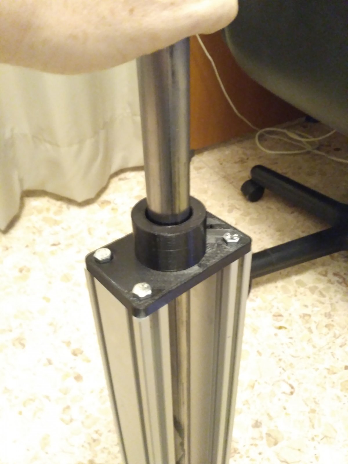

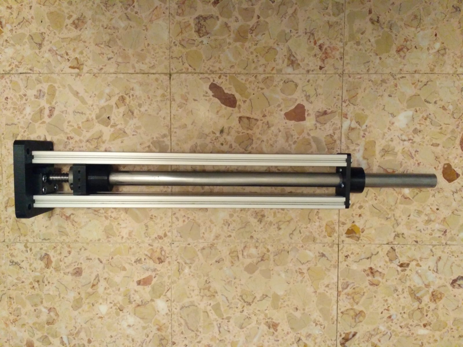

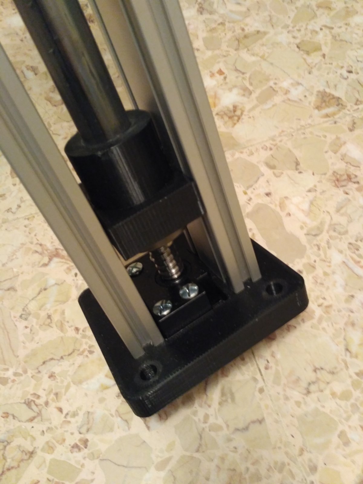

    @wannabeaflyer2 : What did you use as potentiometer ?
    Would it be better to add small teflon pad between 20x60rail and the ballscress mount ?, I noticed in one of your video that there is play between those part, maybe it could also limit noise

    Hi Guys like the idea of the Teflon strip @baykah I have to mention that i have hearing problem, so not had a issue so far with noise :) other than that which seems inherent in this design, the system noise, is i suspect because of the speed and rapid direction changes at which the ball screws are now working . im not sure if these bearings were meant to be vertically loaded so I suspect that's why they sound louder than my CNC router .. time will tell on that score but I reckon the machine would have shaken me to bits by then LOL :) .. I am today actually building another actuator to do some tests on my other Dimension engineering controllers & Kangaroo cards. using an optical encoder (never hurts to have options as they say )
    I have the gear so may as well revisit this test again .. another Forum member is having some success with this and I'd like to find out where I went wrong, when I first tried this on my earlier attempt at using 24V electric wheelchair motors and gearboxes to build a 6dof platform ...
    very happy with my current 6 dof sim and the performance is getting better. so as the guys say I really need to turn it up to th e max now to see how much it can or cant handle ...me scared ! lol dam right :-0
    But want my rift first ...

    I red that you have some hearing issues, I will have the chance to give feedback on noise of the actuators.
    Did you find time to look for your CAD files ?, i'm about to start redesigning in scketchup your part from your drawing to print the first parts.
    I allready got 1 ballscrew, rail are on their way, motor should be here before end of the year ..
    What potentiometer did you use ?
    Thanks !

    Hi @baykah I am using 10K wire wound pots , cant say how long they will last but they will be cheap to replace when that day comes , optical encoders would be the way to go , and I will be starting testing soon the extra actuator for this is all but assembled so should be able to start soon, now all I have to do is dig out the info I had created the first time I tried to use encoders and the DE kangaroo device...
    for what its worth i'll put any info here .. cheers guys
