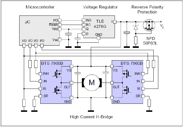

    maybe more easy just search bts7960 datasheet to identify all the pin and replace bts chip with regular mosfet...

    Not that actually. BTS is an IC inside also. Guess no so simple use with it. )

    yeah...but basicly bts chip is also regular mosfet, 2 bts chip similar to 4 regular mosfet, and the other componen in the board had fuction to handle the signal before mosfet...

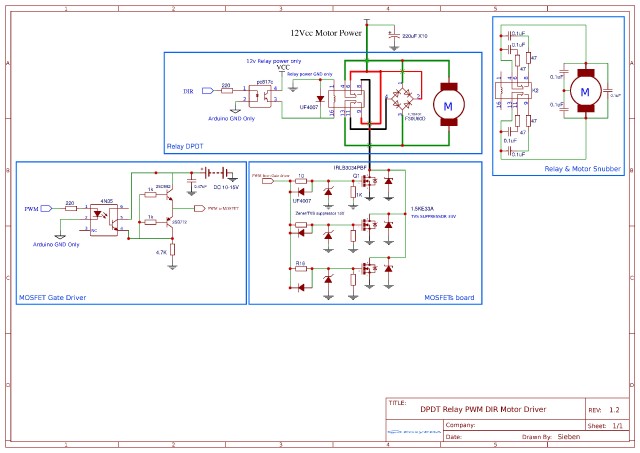

    Also testing the PWM+DIR mode with relay and one MOSFET )
    Made the schematics.

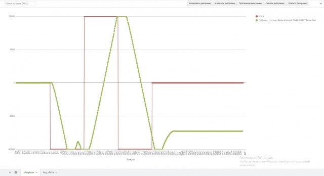

    150 ms step test

    :thumbs find out the config with aiwave 2016 to work. The "constant force" slider, should not be zeroed. And that's it.
    The relay driver works!:);):cool:

    SOLVED.
    The DD config with 540 dc motor was too fast. It works but if gonna make a drift with it, or a like, i.m. release the wheel out, the motor runs away. Made the gear ratio smth like 1:6, and here we go)))
    Gain 80%
    And 100%

    The relay module is assembled in such a way.
    [​IMG] [​IMG] [​IMG]
    Test.
    [​IMG] [​IMG] [​IMG] [​IMG] [​IMG] [​IMG] [​IMG] [​IMG] [​IMG] [​IMG] [​IMG] [​IMG] [​IMG] [​IMG] [​IMG]
    Determination of the freewheeling diodes locations and connection. Just with ordinary 1N4007.
    And schematics for them.

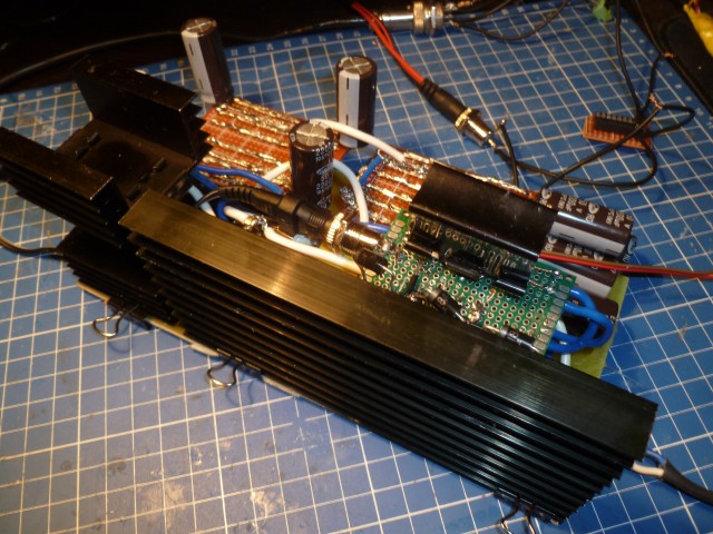

    Advanced pwm+dir driver version is assembled. Got to test with MY1025.
    [​IMG] [​IMG] [​IMG] [​IMG] [​IMG] [​IMG] [​IMG] [​IMG] [​IMG] [​IMG] [​IMG] [​IMG] [​IMG] [​IMG] [​IMG] [​IMG] [​IMG] [​IMG] [​IMG] [​IMG] [​IMG] [​IMG] [​IMG] [​IMG]
    Capacitors.
    Capacitors ripple current.
    220uf50v x24 + 2200uf50v x2 + 3300uf63v x2
    19A
    220uf50v x24 + 2200uf50v x4
    16,5A
    Total
    35,5A
    Flyback diodes 30u60DN ~ 60A
    Mosfets.
    IRLB3034 x3pc. Total allowed power should comprise ~ 90 / 120A.
