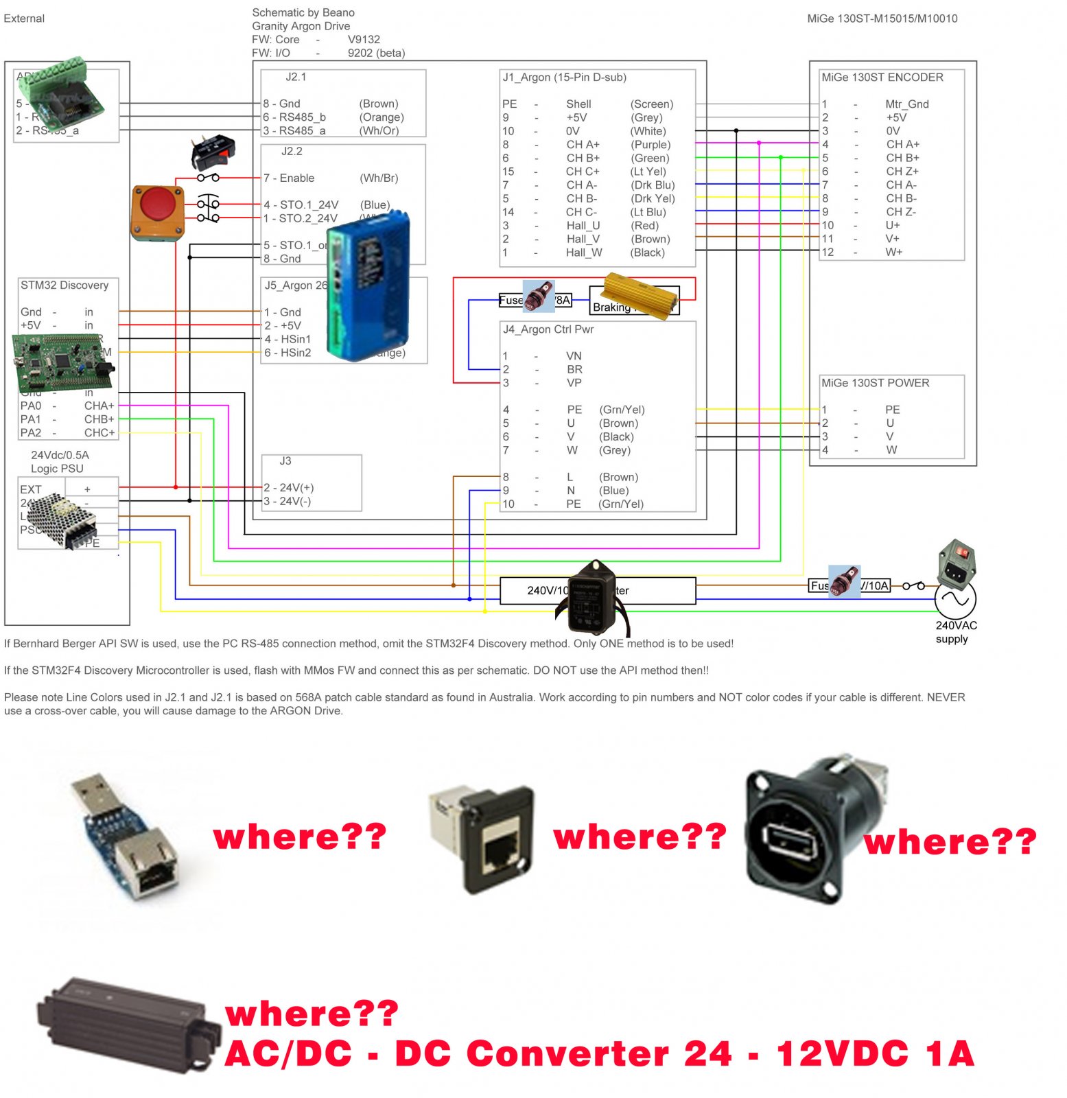

    if thats the case then I have it all. I was going to add some power switches for the motor and for the servo driver. I dont see any of the fuse info on there or the resistor either....Thats the issue is there are a few different versions floating around. The wiring, the damn wiring and the schematic wtih 3 options on it has me a bit confused. There are a few places where the wire is in a T, meaning it looks like it connects to 3 locations. Not sure how I will handle this or if I am reading it correctly.

    SCN5
    Yes ther are some dif in configurations. Just follow Martin Aschers tutorial and you'l be good

    Just looked, thats the schematic I have been using. I dont understand the best way to approach the wires with intersections that go to multiple places.

    Lol, I'm a very simply guy with no experience in electric wiring whatsoever. I just began and followed the wires one by one and three days later I was finished hahahaha
    The break outboard for Argon is sold by granite. Klik

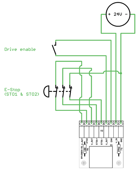

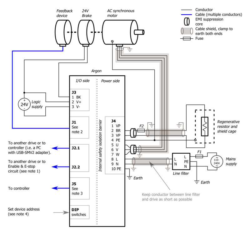

    Youl need to contact Dennis Reimer for that !! info@ib-reimer.de
    The pics are from granite wiki Klick
