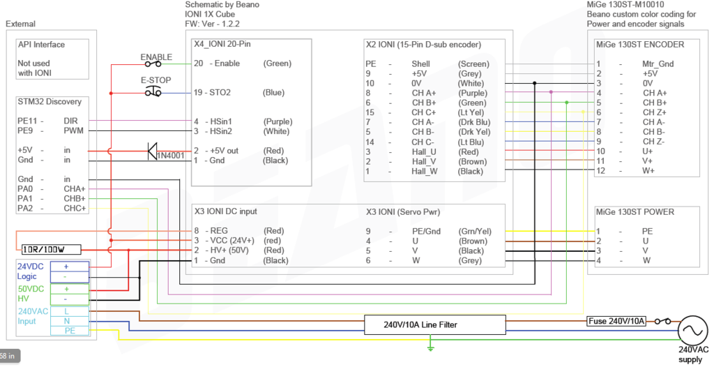

    FOund this is this the one I weant ?

    the encoder cable looks the same as your post. I never noticed you had posted while i was looking
  8. SilentChill
    2,645
    20,601Coins
    +3,570 / 34 / -0
    i have no idea the colours dont match

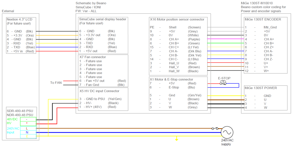

    here's something you can actually follow.
    • Informative Informative x 3
  12. SilentChill
    2,645
    20,601Coins
    +3,570 / 34 / -0
    Yes thanks matey spot on :D

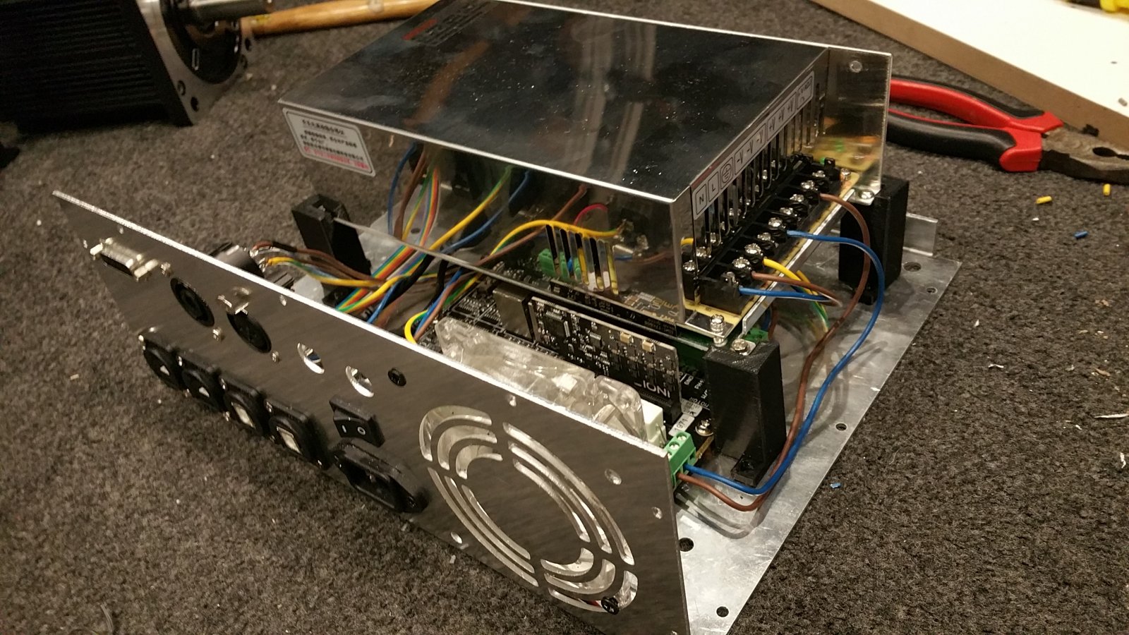

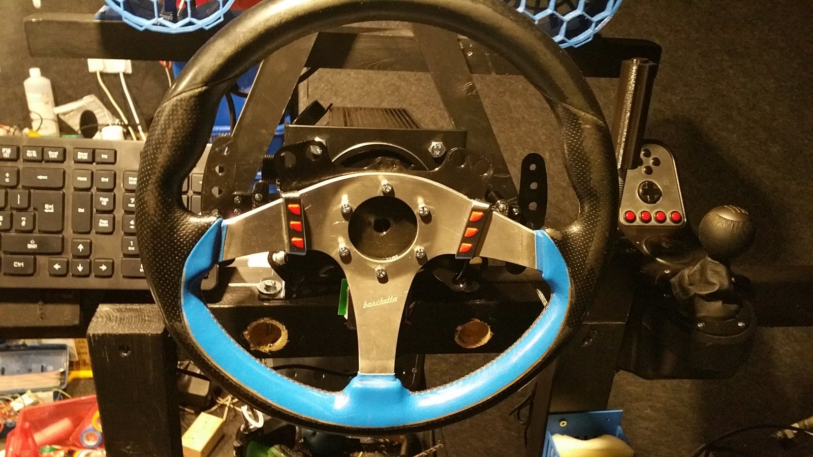

    Motor mounted still got the old wheel as new one hasn't arrived yet or the buttons but I do have paddles.
