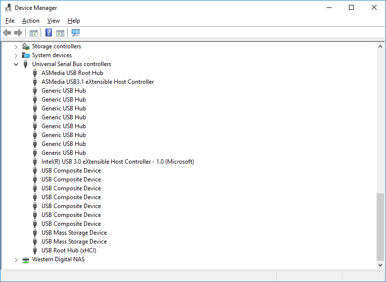

  7. SilentChill
    2,645
    20,604Coins
    +3,570 / 34 / -0
    I have nothing installed apart from the DfuSe flashing program but nothing is getting dsetected in windows tried different USB ports, cables everything I can think of, set S1 switch to DFU mode but its still not detecting it :(

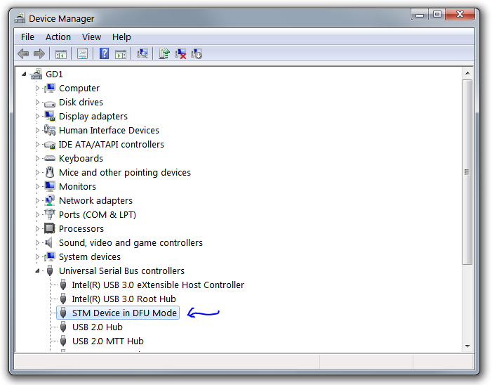

  11. SilentChill
    2,645
    20,604Coins
    +3,570 / 34 / -0
    Thanks matey but I cant detect the thing to get anything to work with it no detection no worky
    This is my device manager
    according to the wiki I need the simucube to show up as this
    But it isnt so I guess I am fecked

  14. crammy
    Feb 23, 2016
    563
    Fabrication
    essex
    4,634Coins
    +326 / 2 / -0
    SCN6, 4DOF
    ill put mine on and check how mine shows up in device manager. back in a mo

  17. SilentChill
    2,645
    20,604Coins
    +3,570 / 34 / -0
    I am just following the Wiki and I cant get it to detect like it should in the pics above

  19. SilentChill
    2,645
    20,604Coins
    +3,570 / 34 / -0
    Think I have a dead simucube :(
