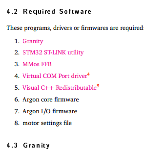

    So you installed Granity adn installed the ST-LINK Utility?

  7. SilentChill
    2,645
    20,601Coins
    +3,570 / 34 / -0
    48v going to the board I've checked the terminals but nothing detecting in windows at all, doesnt matter how much software I install it need to be detected in windows first
    Thanks for your help guys but I think it is just DOA

    1. Maybe USB device is not recognized at all? Keep Device Manager open and plug/unplug SimuCUBE while keeping eye on the Device Manager list. If you see list refresh, then it is a sign that device has entered/left the list. If nothing happens, then it might indicate hardware issue as no USB device is recognized at all.
    Thats me lol bloody typical new I should of just bought one pre built FFS

    Can you upload the granity diagnostics tab?

  13. SilentChill
    2,645
    20,601Coins
    +3,570 / 34 / -0
    It doesn't matter installing granity as the board is not detected at all in windows software wont make it detect you have to detect first before you can install stuff for that hardware
  14. SilentChill
    2,645
    20,601Coins
    +3,570 / 34 / -0
    In granity you need a COM port and to get a COM port you need the hardware to detect first
  15. SilentChill
    2,645
    20,601Coins
    +3,570 / 34 / -0
    The board has no LED's lit up either its dead, dead as a frikkin dodo, seriously peeved off i am

    Hmm, can't help from here but mostly there is a small issue you could have overlooked. I suggest to go back and begin from scratch.

    Have you tried more than one USB cable btw?
  19. SilentChill
    2,645
    20,601Coins
    +3,570 / 34 / -0
    Ok something I done must be wrong Ive unplugged everything and taken it off its stand offs and the LED is working and USB is detecting :confused::mad::confused::eek:
