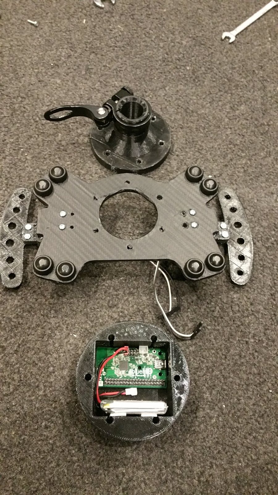

    Finally got my buttons to finish the wheel YAY !! :D
    Doesn't look to shabby for me :)
    20170217_195421.jpg 20170217_195619.jpg 20170217_212734.jpg 20170217_213831.jpg 20170217_213914.jpg
    The horn button even works as a button.................. amazing lol :D
    Happy Dayz !

    Looks sweet. How do you like the BlueHID so far?
  5. SilentChill
    2,645
    20,598Coins
    +3,570 / 34 / -0
    Its brilliant mate so easy to use, well worth the money for the hassle it saves you. I just plug it in every couple of days to charge had no issues at all

    ive really got to get this blue hid sorted. what is the depth encased so i roughly know how far i can move my wheel back. The cable is pretty annoying if you let go of the wheel
  7. SilentChill
    2,645
    20,598Coins
    +3,570 / 34 / -0
    Mine is quite deep I think 50mm as I was using jumper wires and my battery was bigger and the horn button stuck into the back a bit also. Well worth it and it is really plug and play its so simple

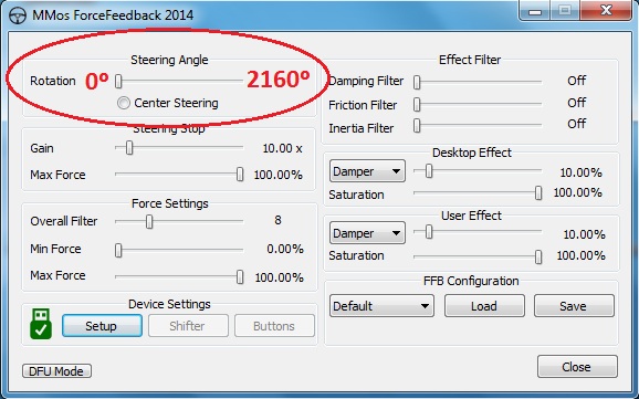

    I have another problem with the MMF FFB rotation setting.
    The rotation steering angle minimum is 180º maximum 2160º, I need it to be, minimum 0º maximum 2160º because I am going to work in -60º and + 60º right / left.
    Do you know how to configure to change this parameter and have more freedom in rotation?

    brion sohn on box this lap says
    https://boxthislap.org/simucube-setting-and-tunning-guide/
    Rotation – Steering Degrees: (parameter = 900/USER_DEFINED) –
    This sets the degrees of rotation you wish to allow in the steering. Most games use 900 deg while others use 1080 deg. You can set this to any rotation you would like and in doing so it sets your endpoints. Setting this different than the game may alter the way forces are translated to the wheel
    Center Steering – Sets Steering Center and Offset: (parameter = checked) –
    Though this box never actually stays checked, it needs to be checked after clicking the Use Encoder Index box under Setup. Once checked when the steering wheel is centered an offset number will be saved and shown under the rotation heading. Ideally you would want to have this as close to “0” as possible since “0” is the encoder index and the point at which MMOS loads setting from onboard memory. you can adjust toward “0” by loosening your steering hub and turning the shaft testing the offset until you get close to a registered zero. Once found you can tighten the hub. This should put you within a small range of “0” plus or minus. The advantage of the center point being close to “0” is that generally the phasing of the servo upon startup will cross the zero point and initialize MMOS or at worst when you center the wheel it will initialize and load your in memory saved settings.

    Regarding the rotation 900º is because the steering wheel is wanted to rotate two and a half turns (2.5 turns). When he turns those turns the steering wheel gets hard and does not let more turns.
    I want you to do the same thing, but when you turn +/- 50º, get hard and stop.
    In the MMF FFB only leaves at least 180º with the wheel, so my question is if there is someone who can modify it to change this value.
    Or if there is some way to modify it so that when the axis turns 50º it becomes hard and stops.
