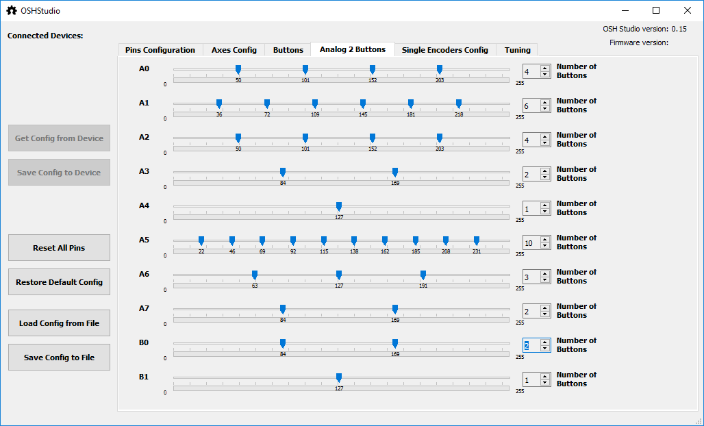

    well, after som testing and using different USB ports (2.0 and 3.0) problem is still there. Board stops for a few seconds, and none of the buttons work.
    next step is to disassemble my wheel and change the board , se if that can solve this problem.
  5. seninha
    seninha New Member
    Jul 20, 2009
    8
    60Coins
    And....no...that didn't help.
    Communication stops for a view seconds and nothing reacts..
    I opent window gamecontroller settings to see if connectie is also lost in Windows and thats not the case.
    OSH PB controller gives status OK, even when buttons stop reacting.
    I have really no idea what more to do

    what is your setup? it could be a ground loop or interference problem.

    After a lot of testing, i finally was able to sove this issue by downgrading to a lower FW.
    Somehoe V0.16 gives me this issue on all boards. Going back to FW 0.15 stopped this freeze problem.
    Yesterday I did a 40 test , and wheel did it great.
    Only thing I dont like on FW 0.15 is how potentiometers react. They give more fluctuation then on FW 0.16
    but , at least I can now drive without having to miss shifting due to no reaction
