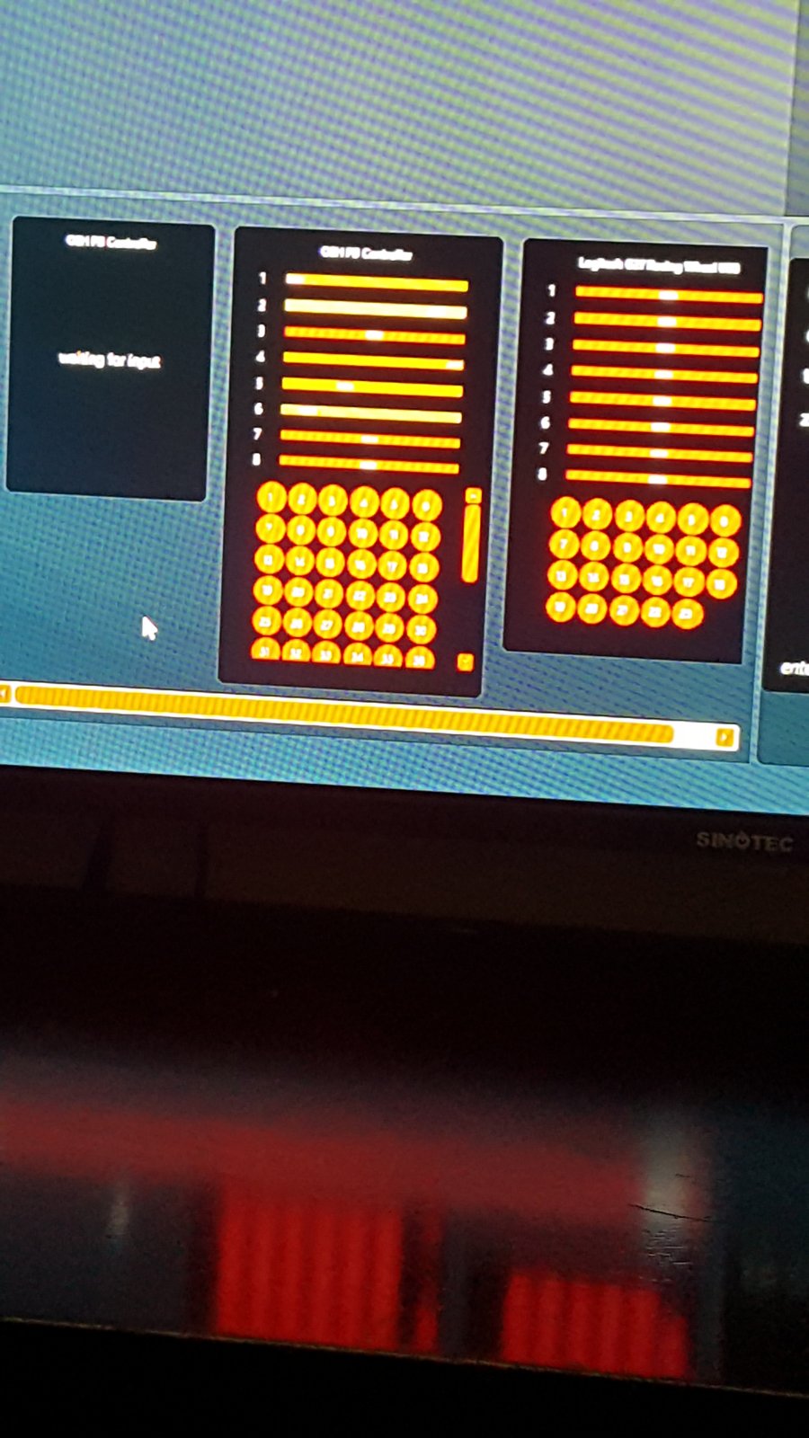

    and just to be clear - how you check what buttons are working? Device Properties in Control Panel can show only 32 buttons, but USB descriptor can handle 64 buttons, so not all buttons show up when you check them in Device Properties.
    Can you try them in a game for example?

    @razzor13bt
    before buying another board, please try to check buttons in a game or other joistick test software, which can show all 64 buttons

    Thank you.
    That sorted it out.
    Checked assetto Corsa and everything is working perfectly :)
    Much appreciated.

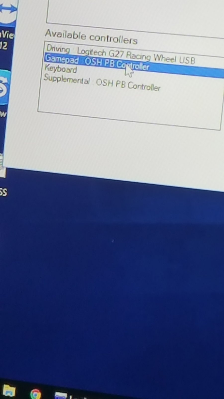

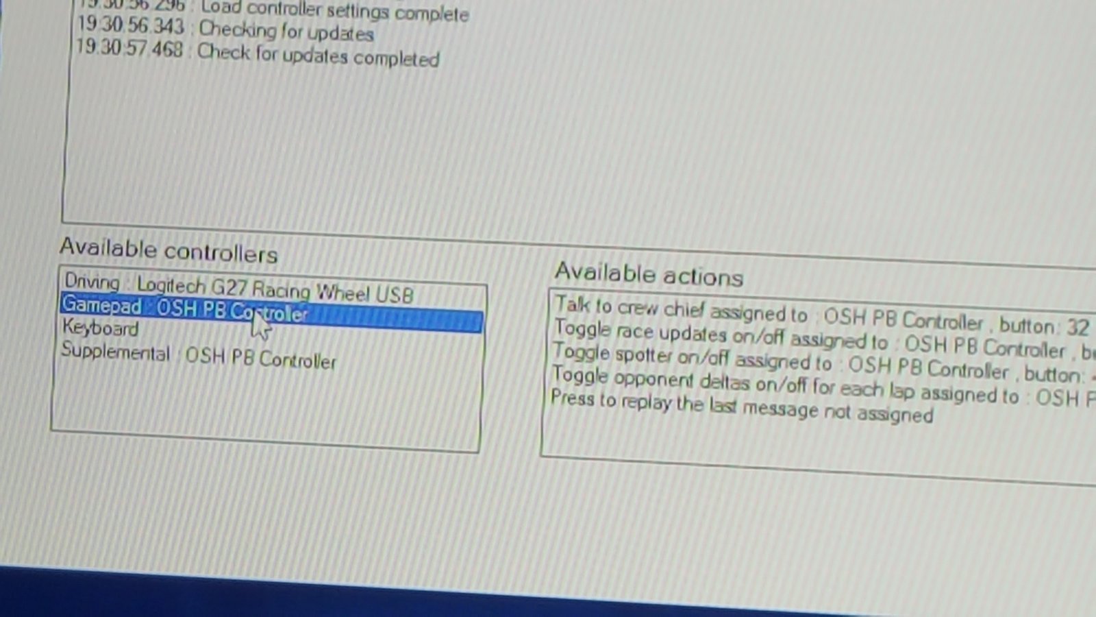

    In the crew chief app and also in Assetto Corsa i noticed the button box comes up as a game pad and as a supplemental device.

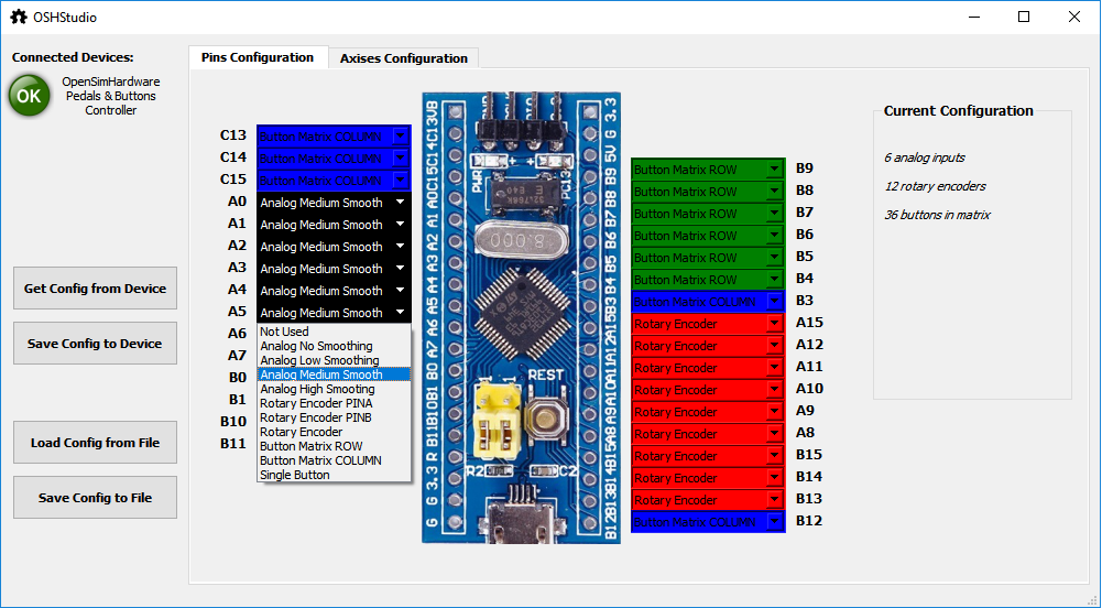

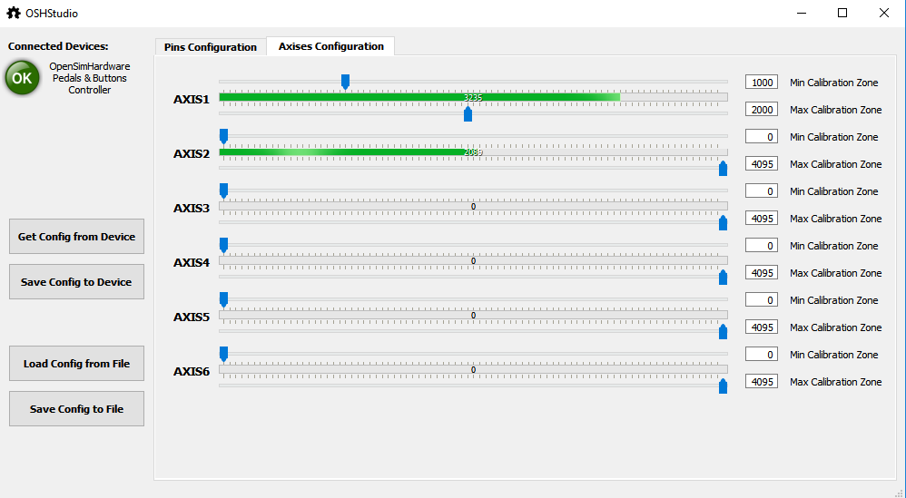

    Hi all
    I wrote a little app, which allows to configure pin's functions. Now you can choose function of each pin. Analog inputs now can have different levels of signal smoothing (for noisy environments)
    Also now you can calibrate axises and store calibration values in the MCU itself.
    link to app
    link to new firmware

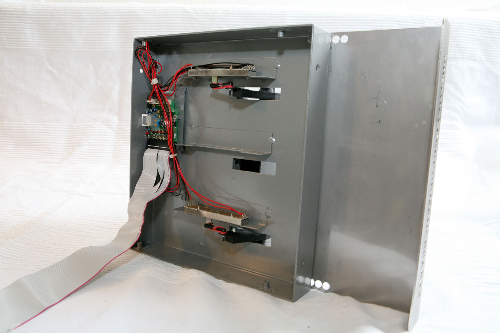

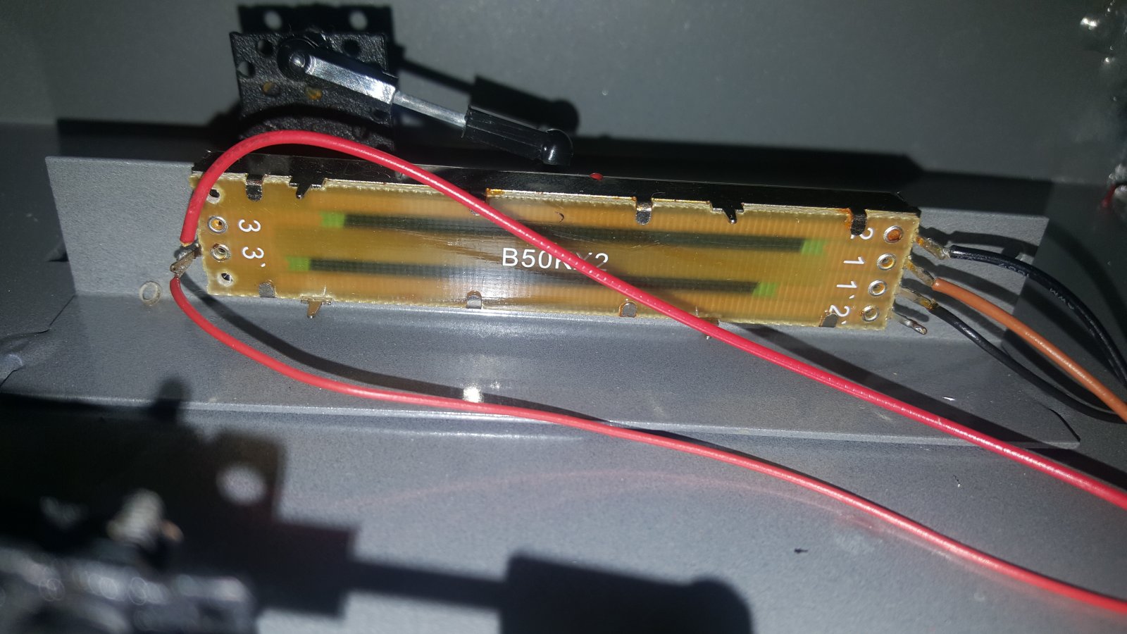

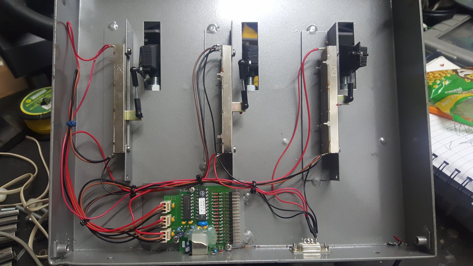

    i have been very busy with work.
    finally getting a break this week and will sit down and go through everthing again.
    also managed to get a 2nd hand VPP racing pedal set that i can mod.
    it uses a Joywarrior 24 chip. will gut it and hook up new pots.
    just wondering if 10k 360 degree will be fine for use with the stm32 ?
    awesome job with the app.
    looks straight forward.
    will post my progress.

  19. TOPMO3
    TOPMO3 Active Member
    May 12, 2015
    133
    Russia
    899Coins
    +201 / 0 / -0
    Hi @razzor13bt
    yes, 10K pot will be fine.
    According to pot's degrees - probably 360* is too much, how many degrees the pot makes when you move pedal from fully depressed to fully pressed state?
  20. razzor13bt
    razzor13bt Member
    Jan 10, 2017
    32
    automotive technician, sales manager.
    Durban, South Africa
    393Coins
    +8 / 0 / -0
    TOPMO3
    the pedals have dual sliding potentiometers hence i wont interfere with the original Joywarrior board with a usb plug.
    The pedals also have a DB9 plug that can connect to a Logitech Driving Force GT wheel.
    i am using this db9 plug to wire up to the Stm32.
    just to confirm/check. i see conflicting info online.
    for the analogue inputs must i use 3.3v from the stm 32 or 5v to supply the pedal pots ?
    from what i have read up on the stm32 analogue inputs i must only use 3.3v.
    thank you in advance.
