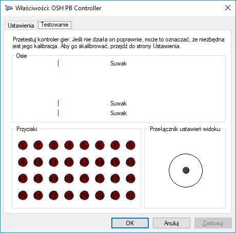

    THX, but now works only axis nr 4.

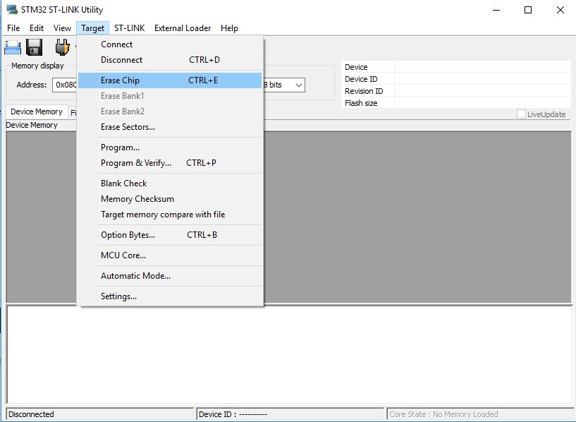

    Excuse me @TOPMO3 ,
    I don't understand what you mean when you write "make full chip erase". Isn't sufficient follow your guide to flash the firmware?

    @Giustino,
    yes, its Target->Erase Chip as @CorradoSKJ already pointed. And you are right I should add this to "how to flash firmware to stm32" post and I just did it! :)

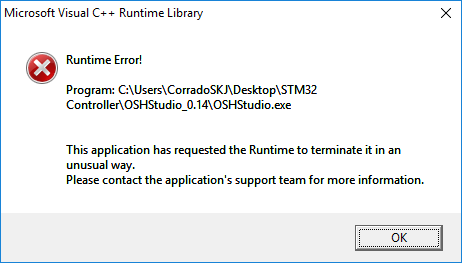

    When I Try run OSH Studio 0.14

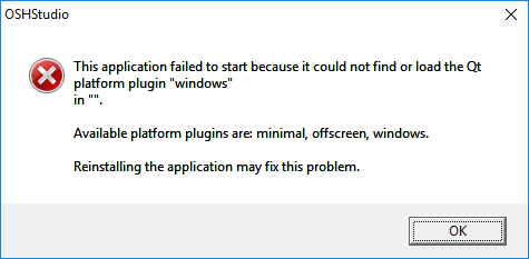

    Sorry, but I doubt about it. It seems windows takes care about serial number only when devices with the same VID/PID connected at the same time.
    Strange, it works for me. I'll take a look later, it requires few files which I didnt put in the archive

    I put missing files from OSH 0.13 but still doesn't work

    Now it's work, thank You again Dmitri
