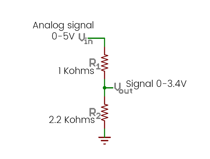

    please tell me is there any possibility that I would be able to choose the voltage of sensor supply ? I mean I have pressure sensors that need to be powered by 5V and your software works well with 3.3V power. When it gives a signal from a 5V powered sensor, it uses only about 65% of range :(
    I have very expensive sensors that I wanted to use for the hydraulic brake pedal and handbrake. Is it possible that they work in the full range??? unfortunately they do not work when I connect them to 3.3V :/

    I see what you mean, but currentlly its not possible to map encoder's value to an axis. Maybe later I can do this.
    The STM32F103 chip's ADC upper limit is 3.6V, so we can do nothing with your problem. Is it possible to tune your sensor output to 3.6V? Some sensors have separate Power and Reference Voltage pins

    My sensor do not have separate Power and Reference Voltage pins :( but I found the password "Voltage Divider" , it looked simple so I tried it :) and that solved my problem, I use resistors like on this scheme and changed 0-5V to 0-3.4V
    Is this a good solution ??

    You know, I think yes, its good - simple and effective :)

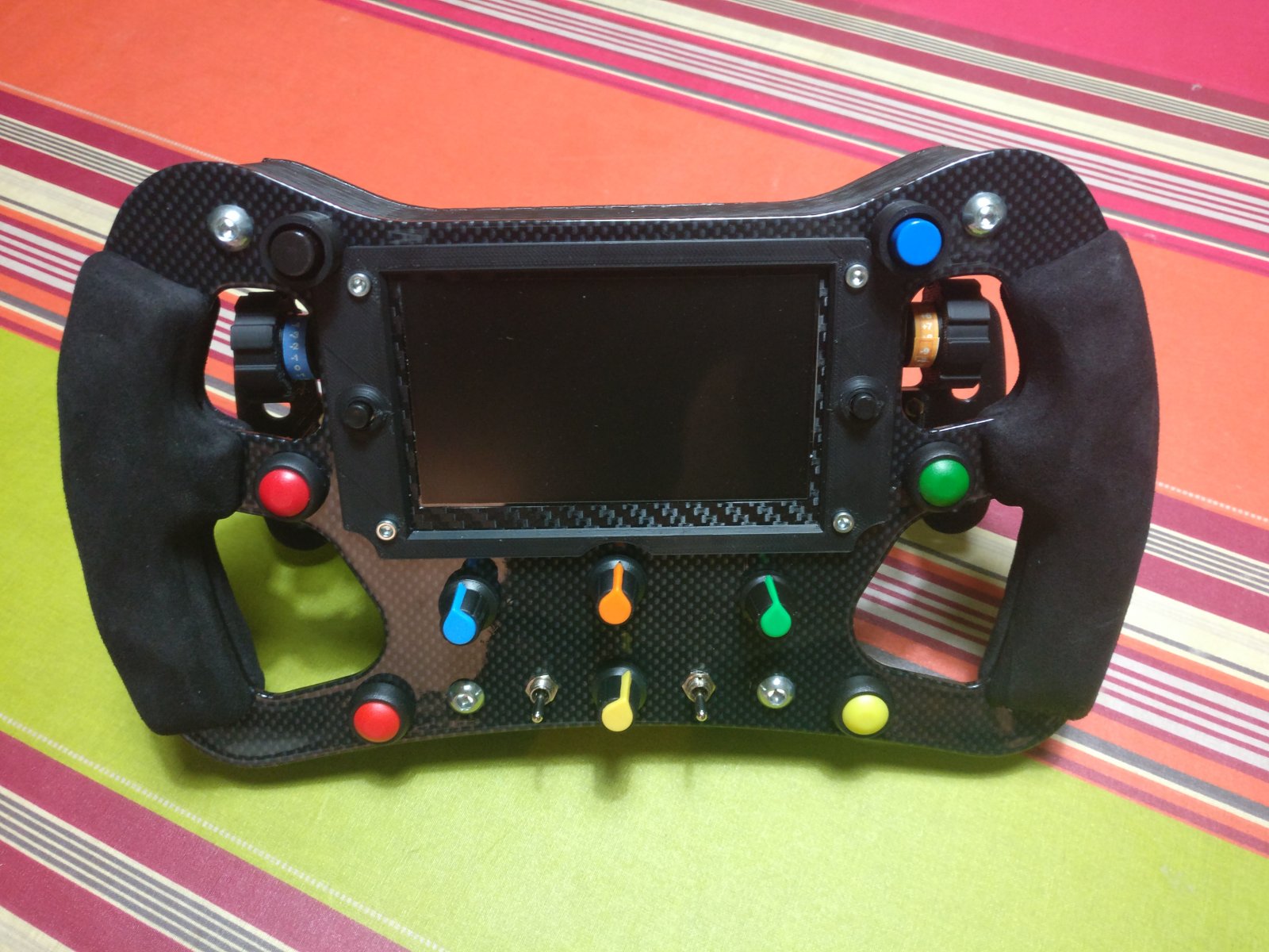

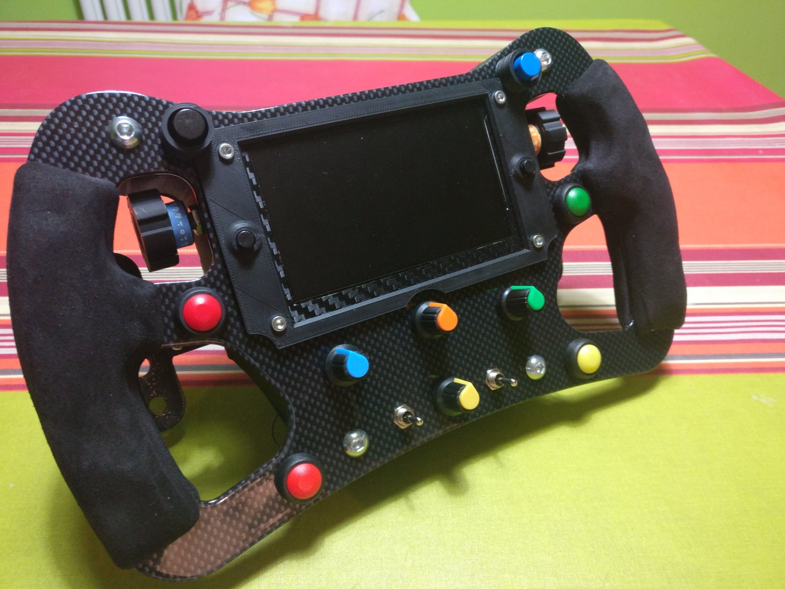

    Hi @TOPMO3 , Of sure I'm still going OT, but I want to show you the result of your work thanks to which I managed to make this jewel. Thanks again and merry Christmas
    • Optimistic Optimistic x 1
  8. TOPMO3
    TOPMO3 Active Member
    May 12, 2015
    133
    Russia
    899Coins
    +201 / 0 / -0
    Wow, very nice looking rim, @Giustino ! I really like it
    Merry Chrismas you too, mate! :cheers

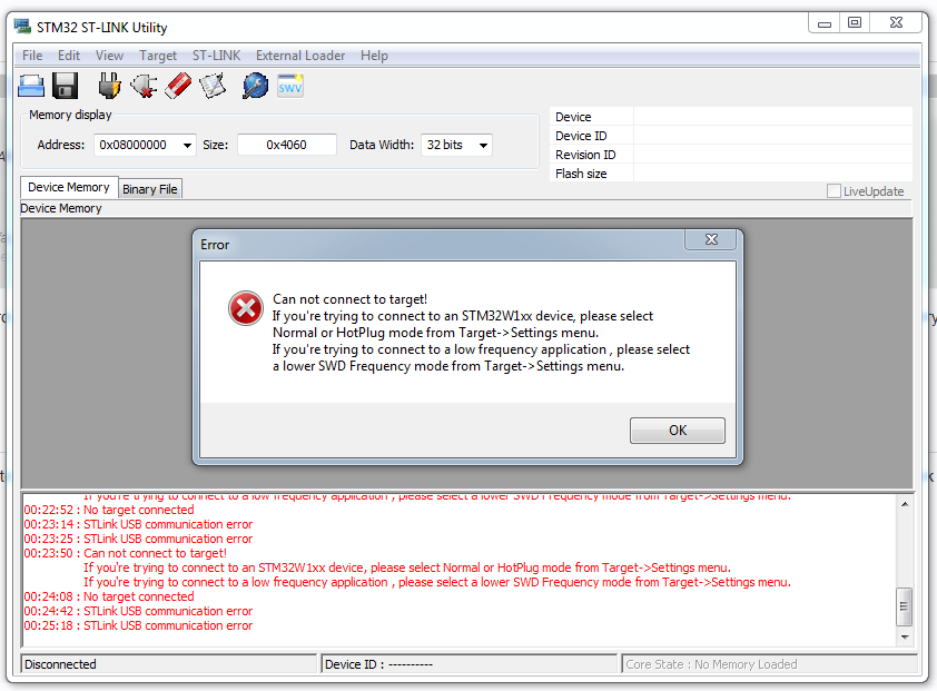

    Hello man, i want to try your software but i cant, any idea why the software always error when i connecting the board? Even i have 2 board to try..

    Hi @BS21
    In a case of such errors the most possible cause is bad config. At first, please be sure you are using fw and app of the same version - I.e. 0.14
    Can you please make these steps:
    - make full chip erase
    - reflash fw
    At this point your board should be identified as joystick (with default config) in windows.
    - launch OSH Studio. Once again ensure you are using the same versions of the app and few
    - click get config from device. Default config should be loaded and be shown in the app
    - make new config you needed and click save config to device.
    Try to make these steps and let me know if you have any error

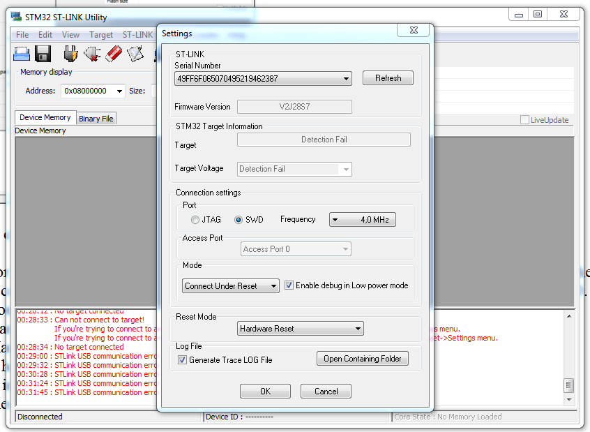

    Yesterday i got problem when reflashing it brother. Board getting lost connection and dont want to reconnect when i start pushing reset button and clicking "ok" in st link software. But i'll try again tonight. Will let u know for the next..

    insteed of making connect under reset you can just switch both jumpers - then stlink utility should connect to board without any issues. After reflashing dont forget to switch jumpers back

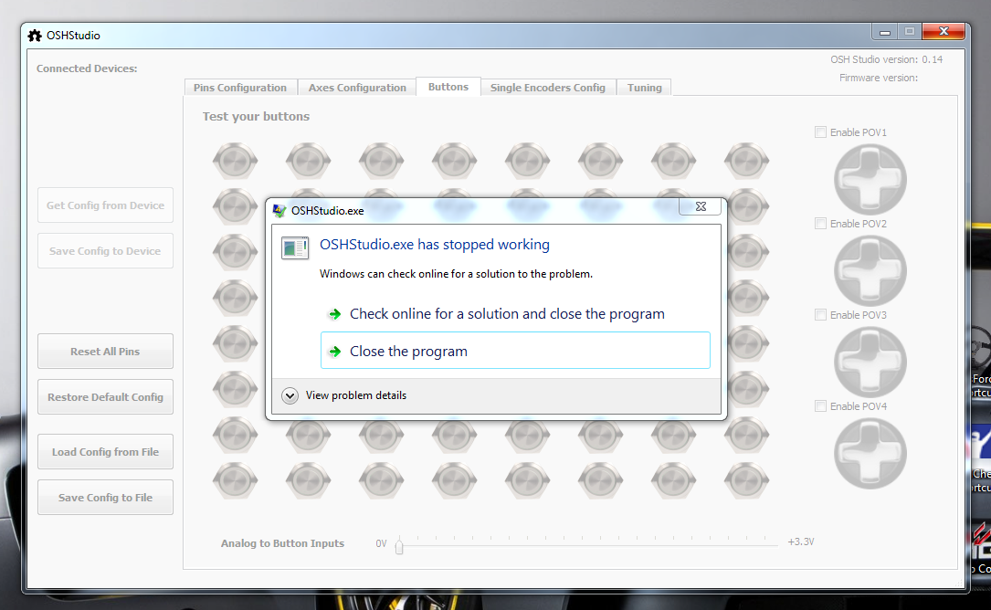

    I'm getting the same problem when I connect the usb in the computer with the OSHStudio running, or when I run the programm with the usb connected. I reflashed too many times and tried versions 0.14 and 0.13 and the result is the same.
    I'm using windows 7 64bits and it get me this error description (sorry because it's in spanish with my own translation):
    Nombre del evento de problema("Problem event name"): APPCRASH
    Nombre de la aplicación("App name"): OSHStudio.exe
    Versión de la aplicación("App version"): 0.0.0.0
    Marca de tiempo de la aplicación("App time mark"): 5a0dbec6
    Nombre del módulo con errores(" Error module name"): OSHStudio.exe
    Versión del módulo con errores("Error module version"): 0.0.0.0
    Marca de tiempo del módulo con errores ("Error module time mark"): 5a0dbec6
    Código de excepción ("Exception code"): c0000005
    Desplazamiento de excepción ("Exception slide"): 000019f6
    Versión del sistema operativo("S.O version"): 6.1.7601.2.1.0.256.48
    Id. de configuración regional ("Regional ID config"): 3082
    Información adicional 1 ("additional info"): 0a9e
    Información adicional 2: 0a9e372d3b4ad19135b953a78882e789
    Información adicional 3: 0a9e
    Información adicional 4: 0a9e372d3b4ad19135b953a78882e789

    Hi @xavi_trd
    You mean the app crashs even if you don't click any buttons? Hmm
    It seems like some local PC issue, hard to diagnose such errors
    Do you use USB-hub? If yes please try to connect right into MB USB port
    if you use USB3.0 port try to use USB2.0
    Try just to change USB port, for example from front to rear
    Do you have an option to try a different PC? as last resort

    1. Yes, as soon as I connect the usb the app crashs. Sometimes I can see that the board is linked with the app, but can't do anything before it crash.
    2. I'm not using a USB-Hub.
    3. I Used front/rear and 2.0/3.0 USB
    4. I tried to use it in my computer and in my laptop
    And the result is always the same....
    Someone have tested the app with a BlackPill board????
    If I can, tomorrow I will test it in my workplace computer to discard that it's Norton trying to kill me :confused:, because it's warning me about a infected file the first time I execute the app.

    Today I have tried in my workplace computer with W7 and it didn't work, but I tried in my GF laptop with W10 and it's WORKING!!! :cheers
    I don't know if it's the O.S or Antivirus who was crashing the app, but now I can start my little project. :D
    Again, thanks TOPMO3 for this great work.

    Hello..
    What u mean to switch the jumper is SWDIO and SWCLK? I've done to switch them but still no connection after reset. Or please can you post step by step how to reflashing or downgrade the firmware? Currently used 0.14 FW and OSH. Thank you
