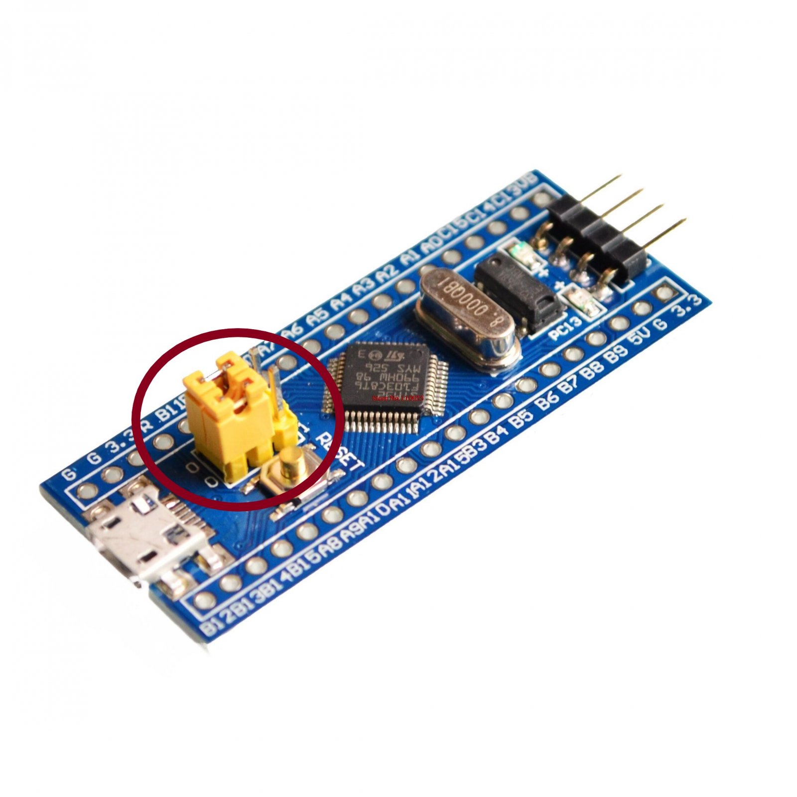

    No, I mean yellow jumpers
    you have 2 options:
    - you can make "connect after reset" - in this case you don't need to switch jumpers, just hold reset button and then choose connect from menu
    - you can switch yellow jumpers and then stlink utility can connect to the board with no problem. In this case you don't need to do "connect after reset"

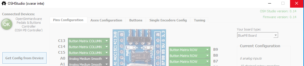

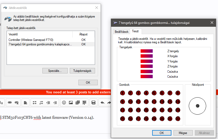

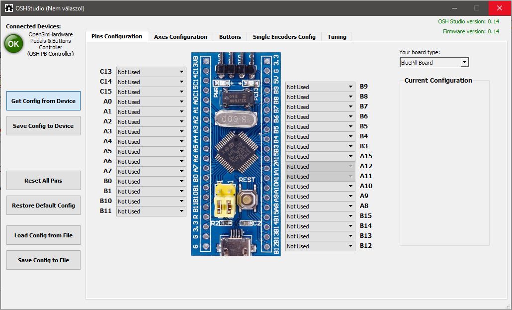

    I have ST-LINK V2 and STM32F103C8T6 (BluePill) with latest firmware (Version 0.14).
    The controller is work:
    But when I open the OSHStudio and "Get Config from device", the OSHStudio is freeze.
    Windows 10 64bit Pro.

    Testosteron default
    Restore default config->save config to device->load your config-> and now this option propably work.

    "Get Config from device" still dont work. OSH freeze.
    Two yellow jumper is 2-3?

    I also had this hang up issue, seems to like to hang when you press the "get config from device" there's a sequence of plugging the board in and getting one shot at that "get config from device"
    if it would hang up, you have to restart the process.
    Fire up the OSH software, Plug in the board. then ask for the config, Sometimes it worked. Sometimes is froze up.
    Win10 74 here also
    PS windows has been messing about with drivers this last update and they gone done Broke Shit....., there's a thread on AC forum about it.

    I have the same problem reading the configuration, it works in windows and OSH find the cards fw etc but hangs if I press get cfg from device
    Have tried reset to default and connect the board before and after the OSH has been started, also connected directly and not thru a usb hub.
    Any ideas?
    (w10 64bit)

    try to reset all pins from menu before read config from card...
