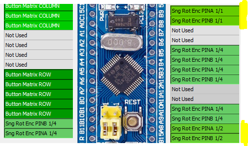

  16. Wergilius
    Wergilius New Member
    Sep 11, 2018
    43Coins
    I have a setup with 4pcs of 1/4 encoder and 2pcs of 1/2 encoders.
    If I configure 2pcs of 1/2 (or 1/1) I get no button presses.
    If I configure 1pcs of 1/2 and 1pcs 1/1 both work,
    The 4pcs of 1/4 always work.
    Works ok (either can be set to 1/2 or 1/1 but not same) but counting of 1/1 get a bit slower (as expected)
    Could I expect 0.15fix correct this (it will take me a while to dismount the wheel to attach the cables to load the fw)?

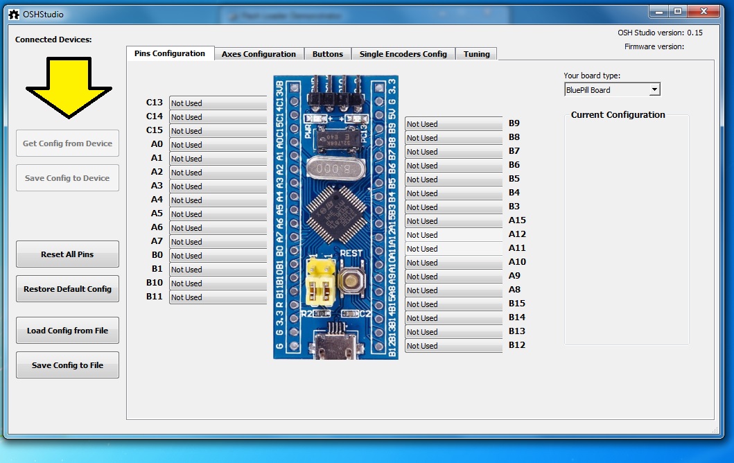

  17. thecure
    thecure New Member
    Aug 21, 2011
    15
    - 91Coins
    +2 / 1 / -0
    hi ..i want to try this software but he does not see the card ....i use a version 0.15

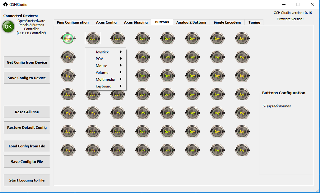

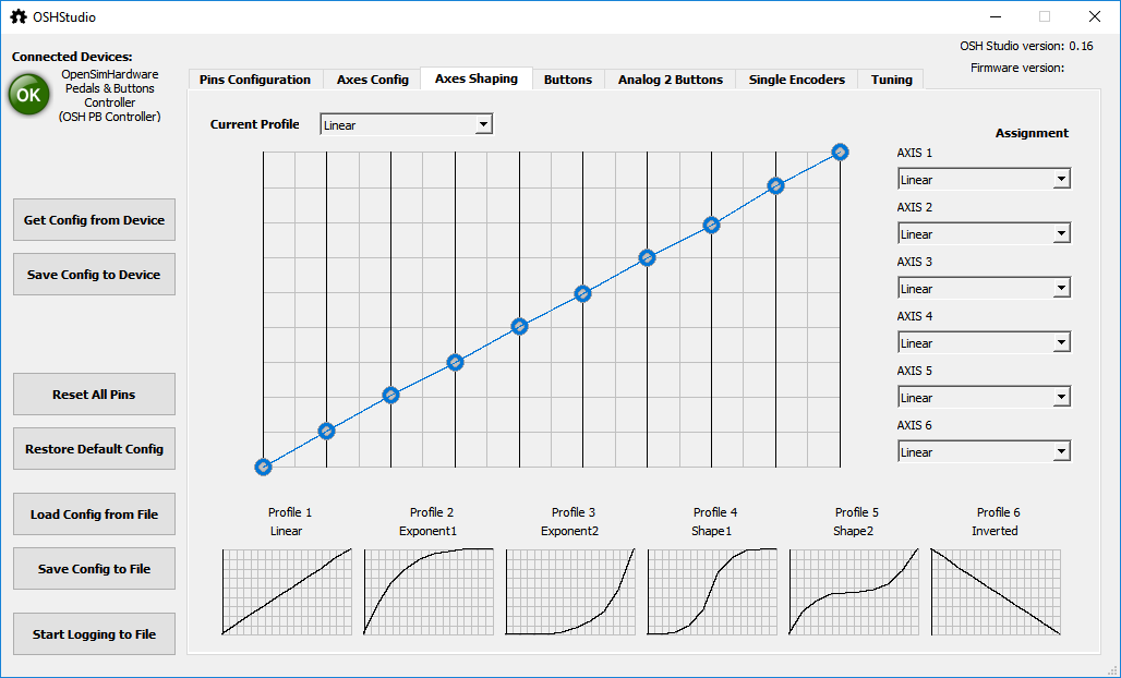

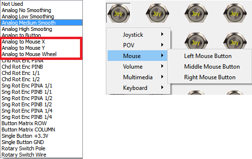

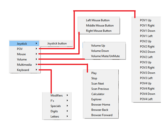

    Hi all
    0.16 version is ready
    new features:
    • Keyboard/Mouse emulation is added. With keyboard emulation you can configure some of your buttons/encoders for example as Volume Up/Down regulators, Browser Launch/Navigation, Music Player track switching, etc. With Mouse emulation you can for example mount small analog joystick on your wheel and use it as mouse
    • Now the app show not only axes value but raw sensor value as well, so during calibration you can see both values. I believe it'll lead to less confusion how calibration process is done
    • Axes shaping added, you can choose one of 6 predefined presets or make completely your own shape
    • Winner Winner x 4
