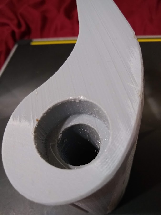

    I printed up the left pedal and some spacers.
    I use Pet-g plastic also.
    They turned out very nice.
    I mirrored the left pedal to make a right pedal and started the 13hour print.

    It looks like it has a bearing pocket

    What was the orientation of your print? Was it laying flat with a raft (support) under the thick end?

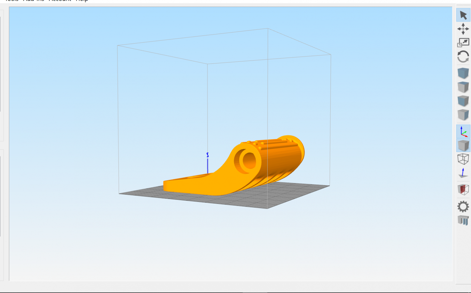

  12. T R Para
    T R Para i make stuff up
    Oct 18, 2018
    385
    Cincinnati, Oh
    2,447Coins
    +358 / 3 / -0
    AC motor, 6DOF
    I just let the program calculate the supports. (I use simplify 3d)
    I set the orientation as in the pic.
    Yes all the supports were on the right side.

    What fill rate did you use?
  14. T R Para
    Oct 18, 2018
    385
    Cincinnati, Oh
    2,447Coins
    +358 / 3 / -0
    AC motor, 6DOF
    25%fill 3tops 3bottoms 2 shells

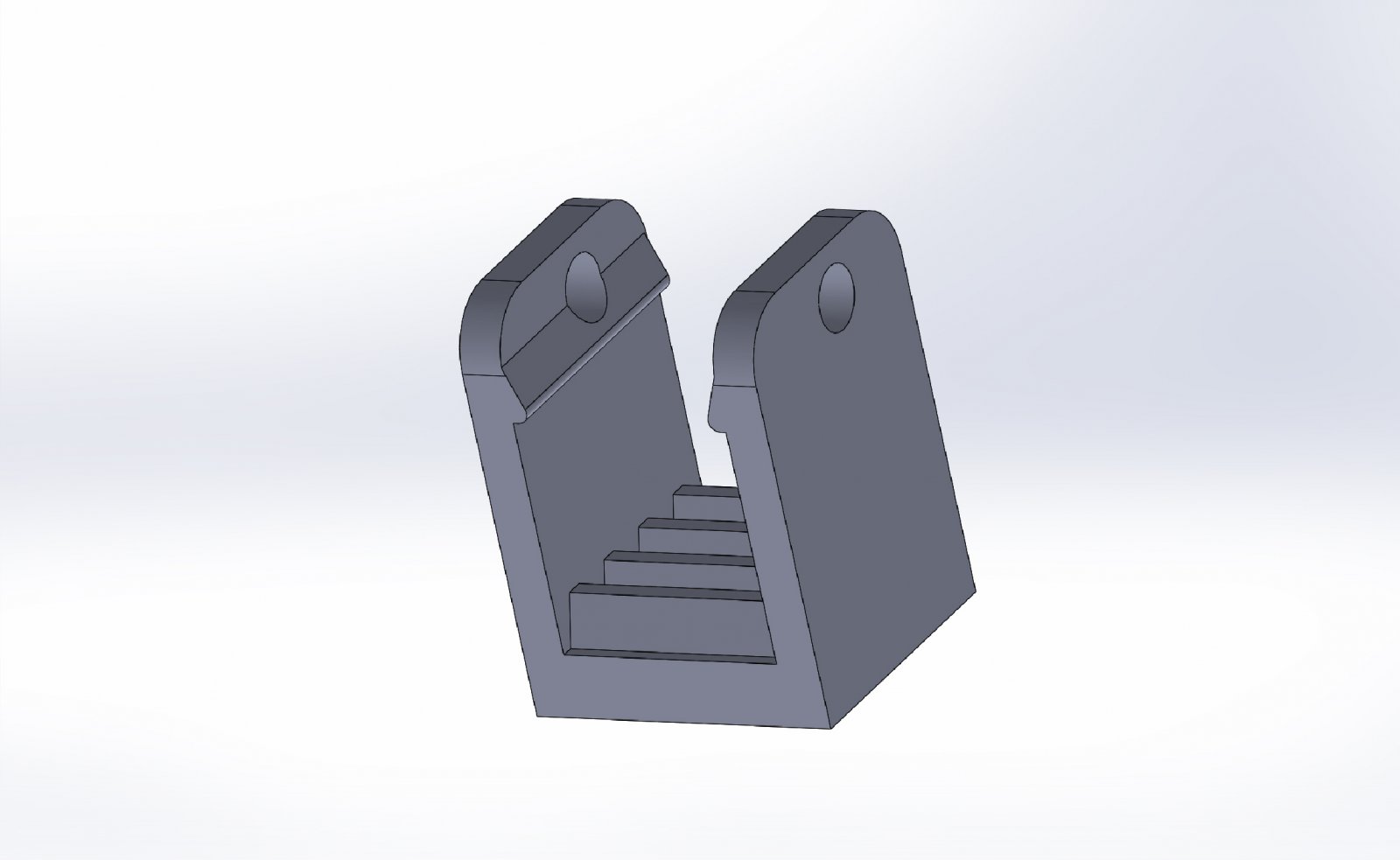

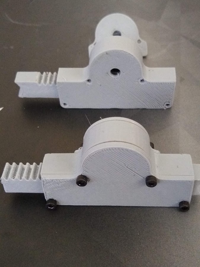

    I identified a problem with my linear hall effect potentiometer design. If you roll the pedals back toward you too far accidentally the pot will actually start increasing again. Probably not an issue for toe brakes but I still wanted to keep this from happening. I will update the original post to add this STL file.
    I created a bolt on stop for the rack gear.
    Before:
    After:

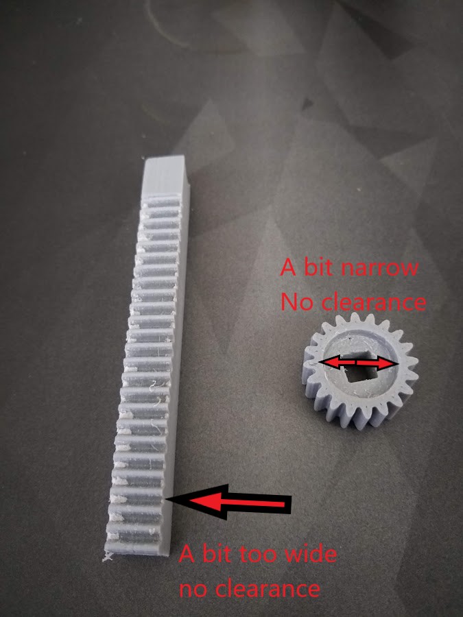

    I found 2 things you might want to look at..
    The rack is a bit wide and I had to sand it down on the disk sander. (easy)
    The clearance on the inside of the gear was too small and I had to widen it out a bit to allow it to rotate freely. ( A bit more involved as it has to chucked up in a lathe type configuration..

  19. Historiker
    2,163
    9,212Coins
    +2,177 / 19 / -1
    I did sand the sides of the rack gears due to spread on the 3d printer but I had no issues with the gear at all.

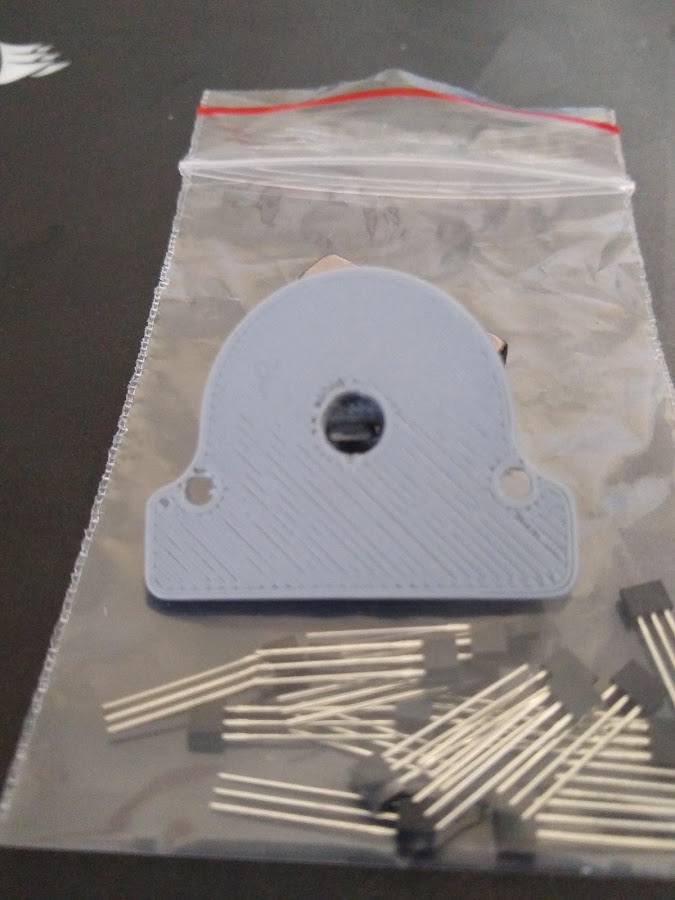

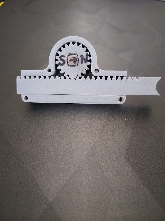

    Here are some pictures of the Hall/ Potentiometer assembly.
    The Hall sensors themselves are very tiny.
    The 1/4" cube magnet is configured so that N pole and the S pole runs left to right not front to back.
