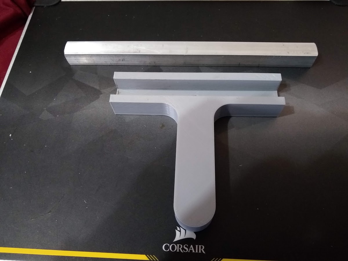

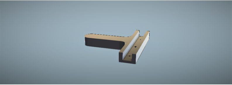

    The T-bar spring levers wide/narrow look nice.

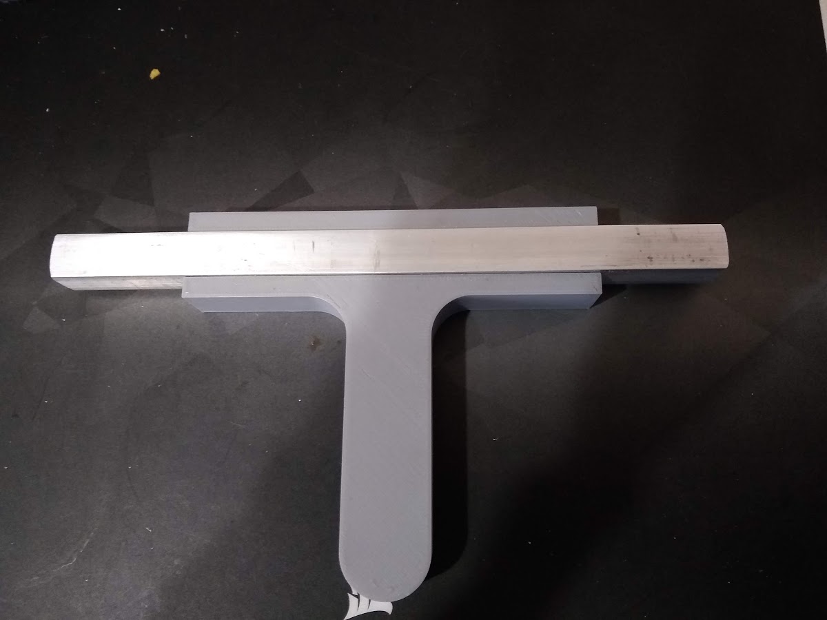

    What do you think about this t-bar. Its mostly 3d printed with an 16mm sq aluminum bar running through it. My 3d printer would not do the full length of the Tee so I cut the ends off to fit..
  5. Historiker
    2,163
    9,212Coins
    +2,177 / 19 / -1
    That is a good idea, especially if the aluminum is taking most of the force from the L levers.

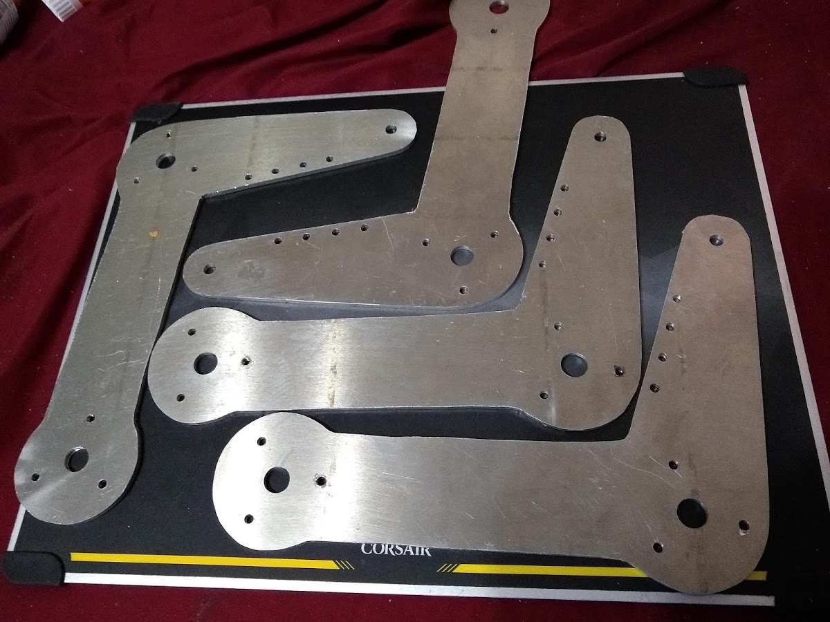

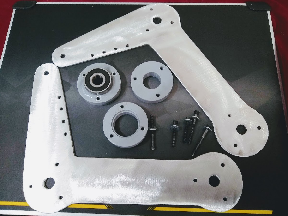

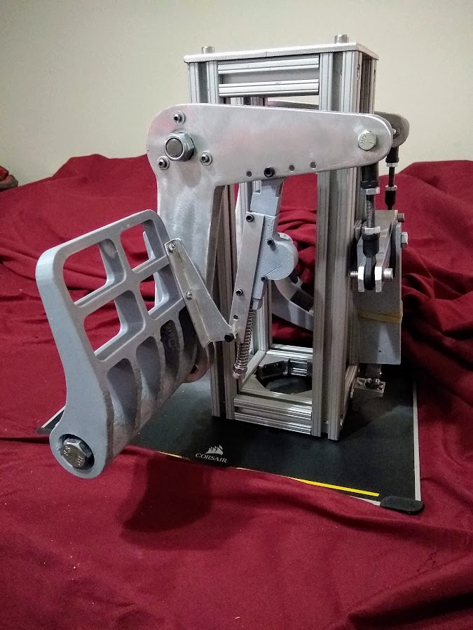

    Got my shipment of aluminum sheet and the 16mm sq bar.
    Levers are done and the T bar assy looks good too.
    Hopefully I can start putting things together.
    It was a beautiful day and I got to fly my new Grand Tundra!

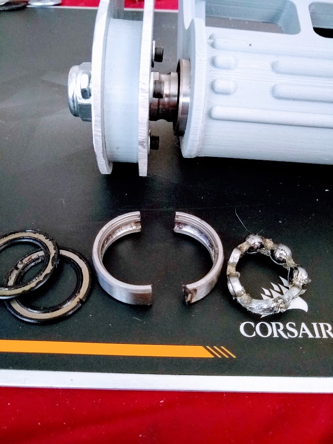

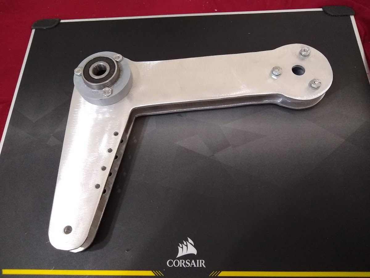

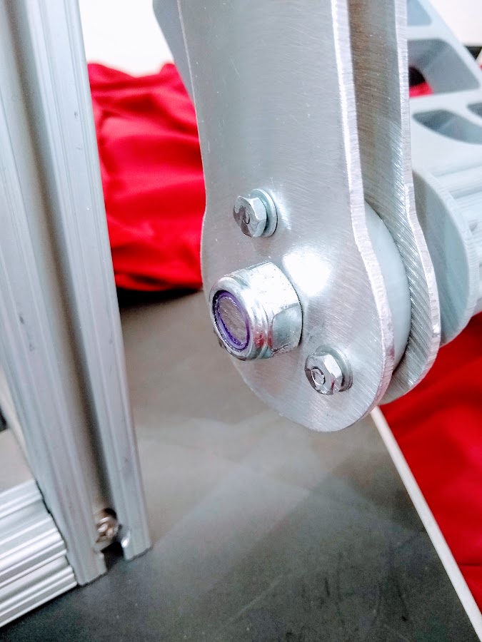

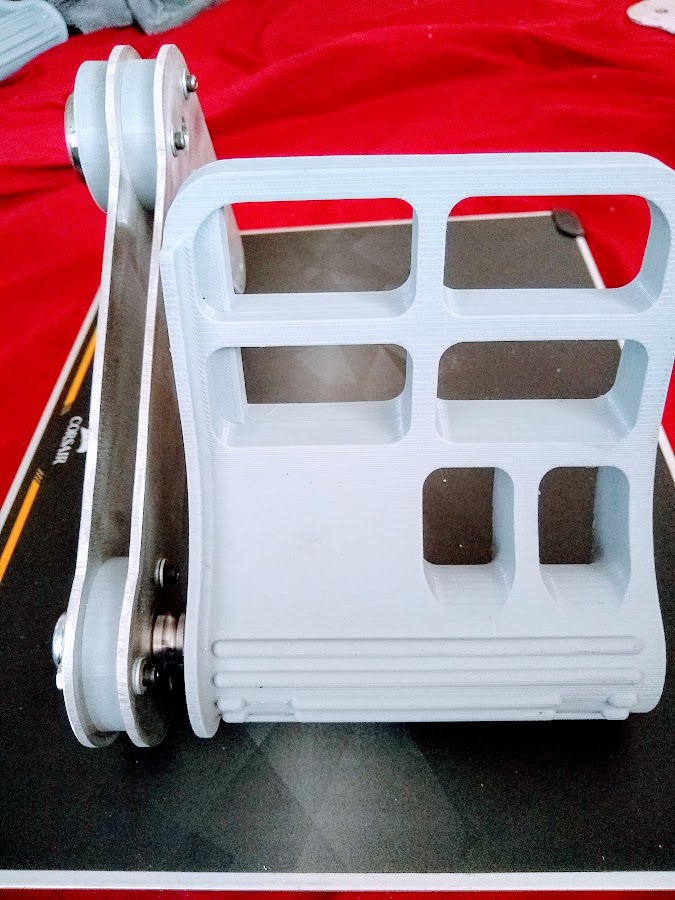

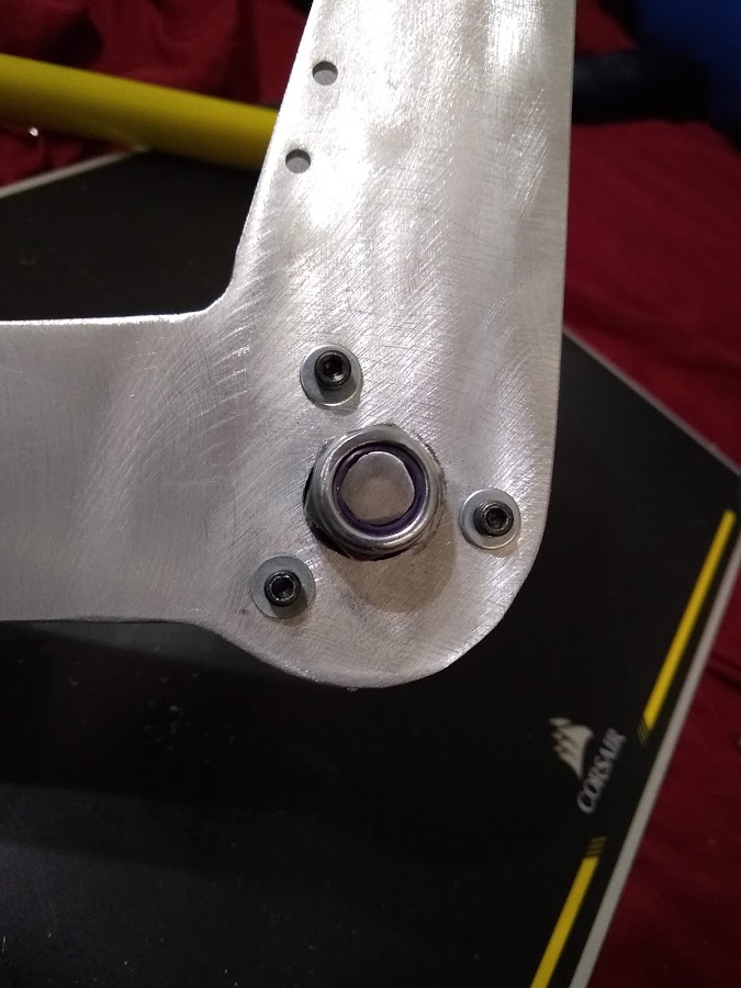

    Some detail pictures of the levers.
  8. Historiker
    2,163
    9,212Coins
    +2,177 / 19 / -1
    Really nice, mine do not look that nice.

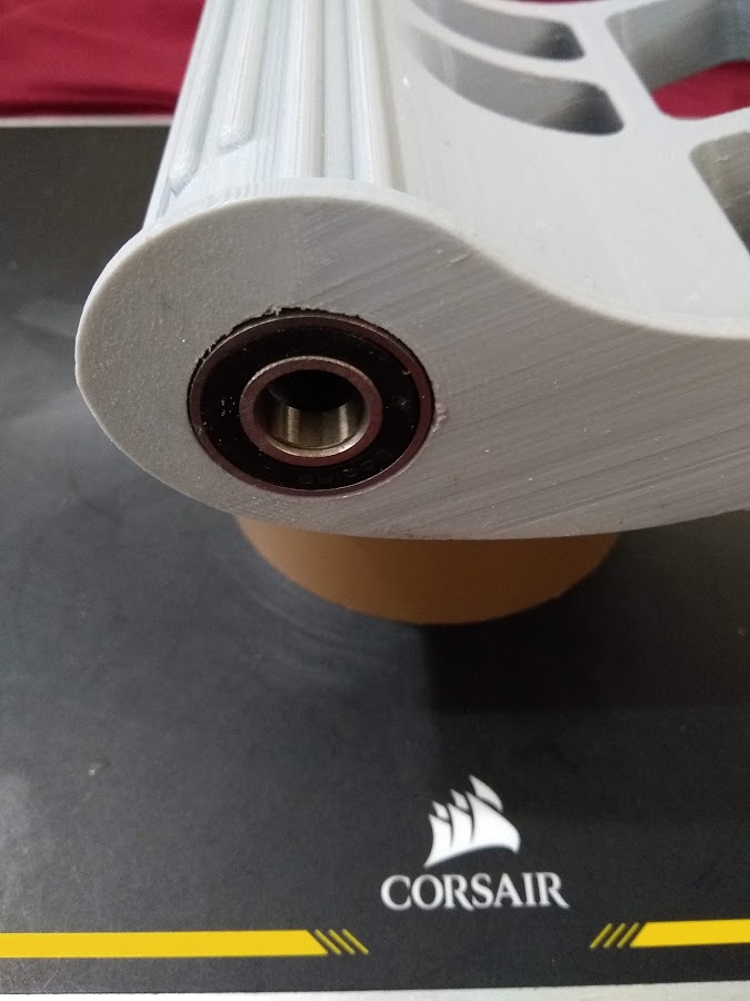

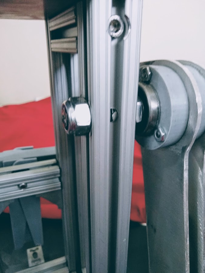

    Something that I might have done instead with my own set: enlarge the hole for the 1/2" bolt to allow the nut to seat against the bearing. Not really needed as I never did it to mine but my nuts do rub against the aluminum (ok, thinking about how that sounds....not good) :)
    I have thought about making metal washers that would allow a the bearings and nuts to be tightened together.
  9. Historiker
    2,163
    9,212Coins
    +2,177 / 19 / -1
    I might still make some washers that have a small outside diameter and 1/2" inside diameter to use as spacers.

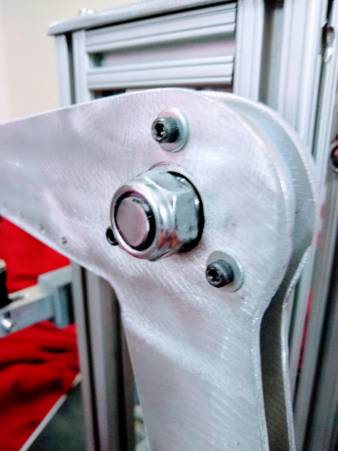

    Yea
    Well the drawings you published were pretty easy to work off of.
    It made construction possible for me. So a big thumbs up.:thumbs
    I paid a little over a $1 apeice for the bearings and they come 10 to a box so I had left overs.
    I cut some apart for spacers and they work well. You can see one on the lower pedal bolt..
    I hope to start on the frame next..

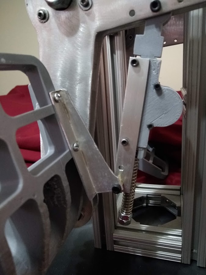

    I am going to use flanged bearings on the upper lever pivot.
    It needs 2 bearings per side.
    No need to change the printed spacers. Just increase the spec'd 12mm hole to 21mm.
    Since I am using 12mm x 1.75mm pitch bolts and rods I am going to stick with 12mm id bearings.
    Here are the bearing specs Flanged Bearings Pn F6800ZZ
    12 mm id x 21 mm od x 5mm x 23mm flange od..

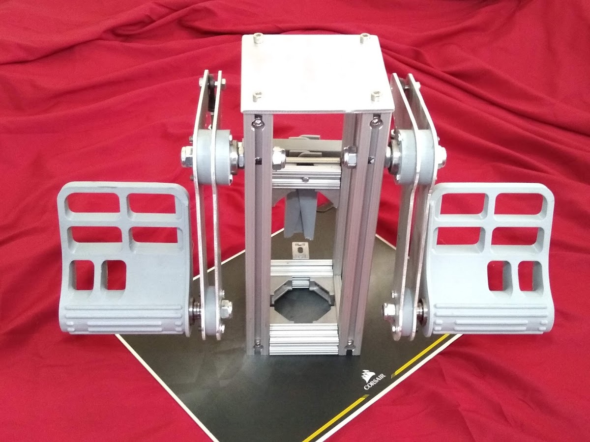

  12. T R Para
    T R Para i make stuff up
    Oct 18, 2018
    385
    Cincinnati, Oh
    2,447Coins
    +358 / 3 / -0
    AC motor, 6DOF

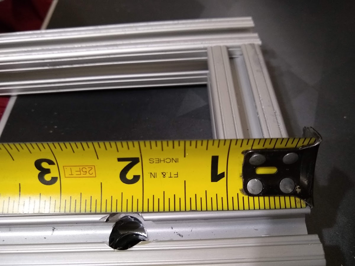

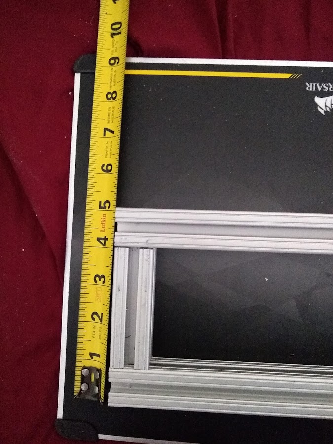

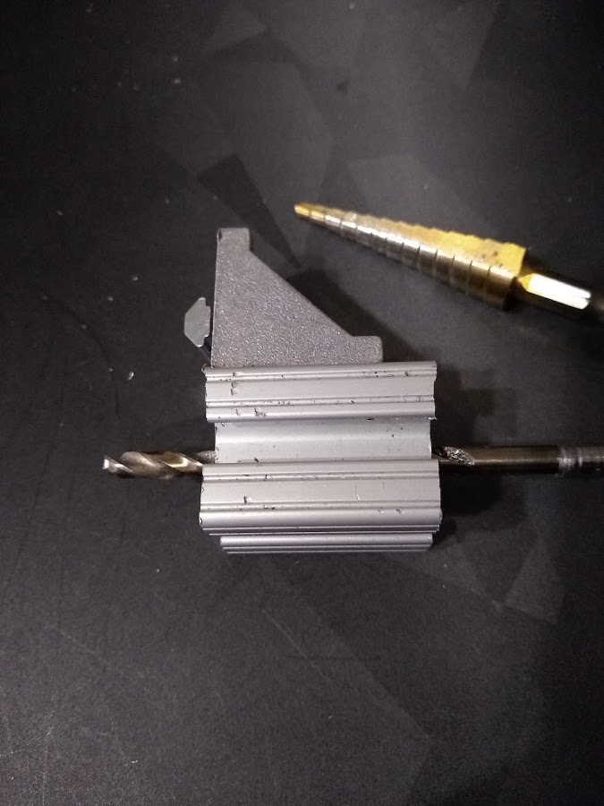

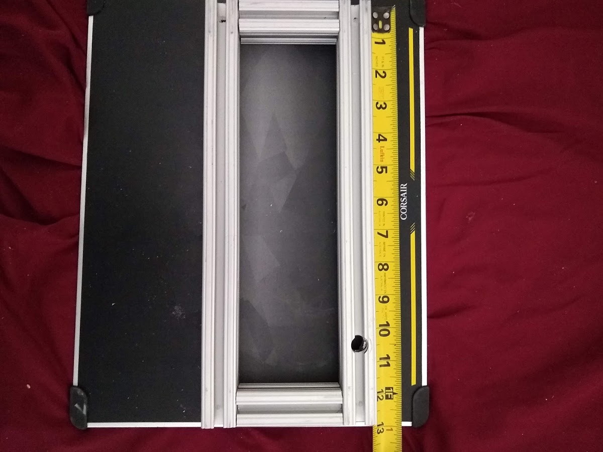

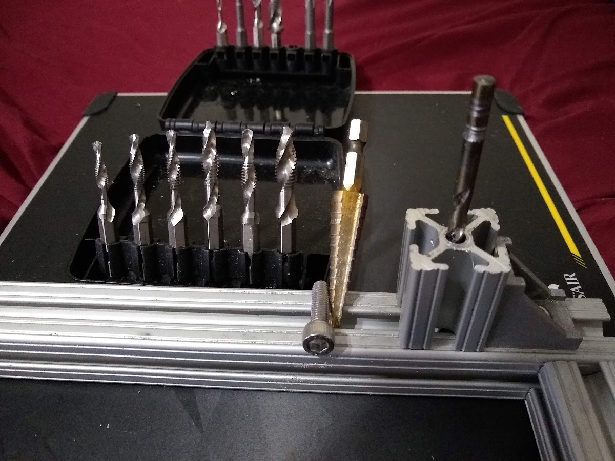

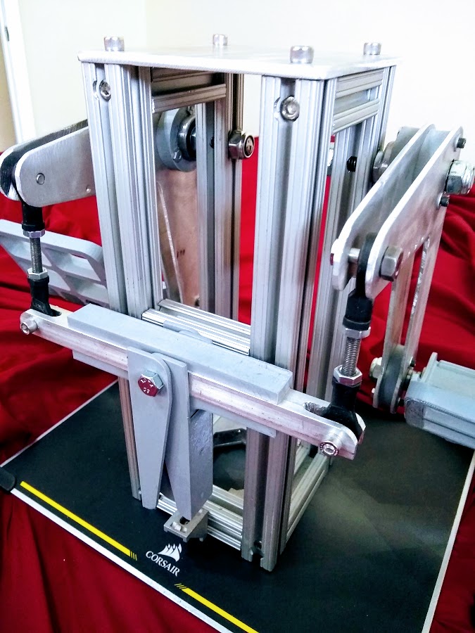

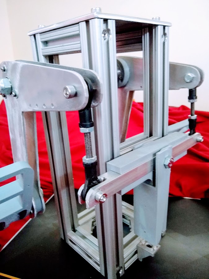

    I have started on the frame .
    The frame height is 12.5" or 320 mm
    The width is 5" or 127 mm
    These dimensions are not critical..
    The frame is made from extruded aluminum commonly called 80/20.
    (T-Slotted Extrusion, 10S, 97"Lx1"H)..
    The lever pivot hole is 2 1/4" or 57 mm from the top.
    I made a simple drilling jig for the extrusion that gets me very straight and aligned holes. (it does require one corner brace)
    Bolting the frame together also saves the cost of the somewhat expensive corner fittings.
    And the best thing since sliced bread are the Drill/Tap combo bits:o:

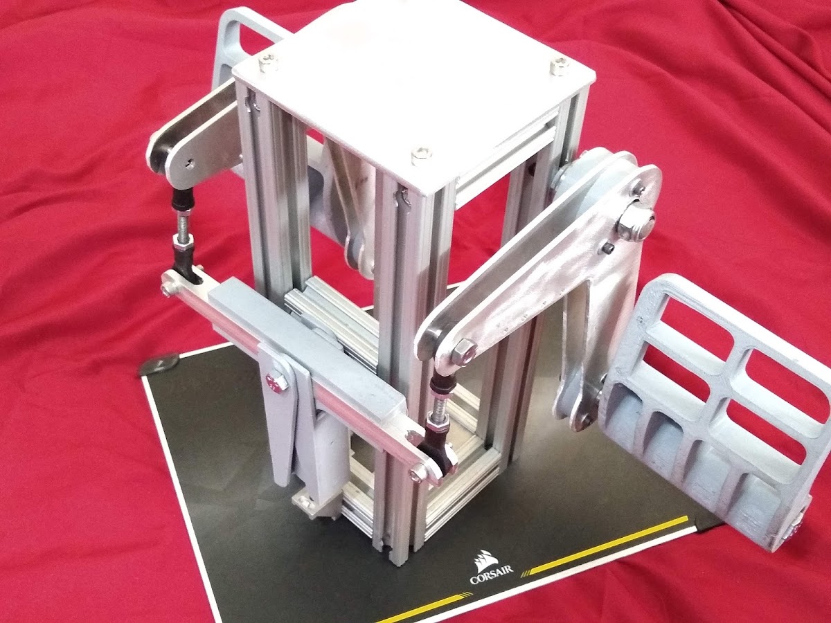

    It is coming together..
    I still have to figure out how I am going to mount the springs.
    And mount the brake sensors.
    And add the Arduino Micro Pro board.
    More pics...

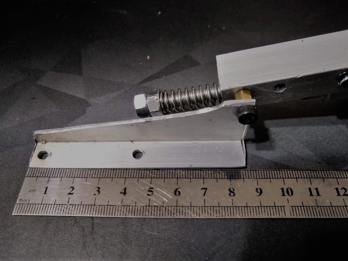

    I added a thick pad to the inside back of the pedal model to bolt an angle bracket to for the linear potentiometers to mount to. That is why there are holes.
    I used angle aluminum mounted to the two flaps hanging down from the T bracket and then two bolts in that to mount the tension springs.

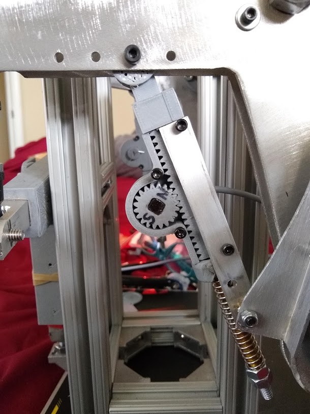

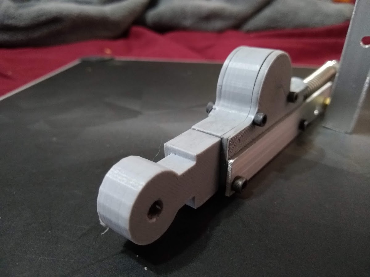

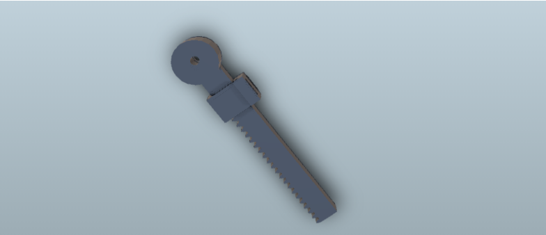

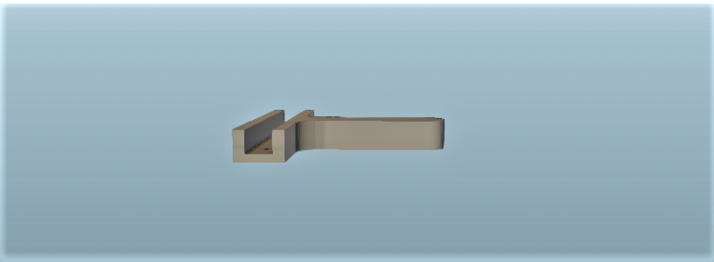

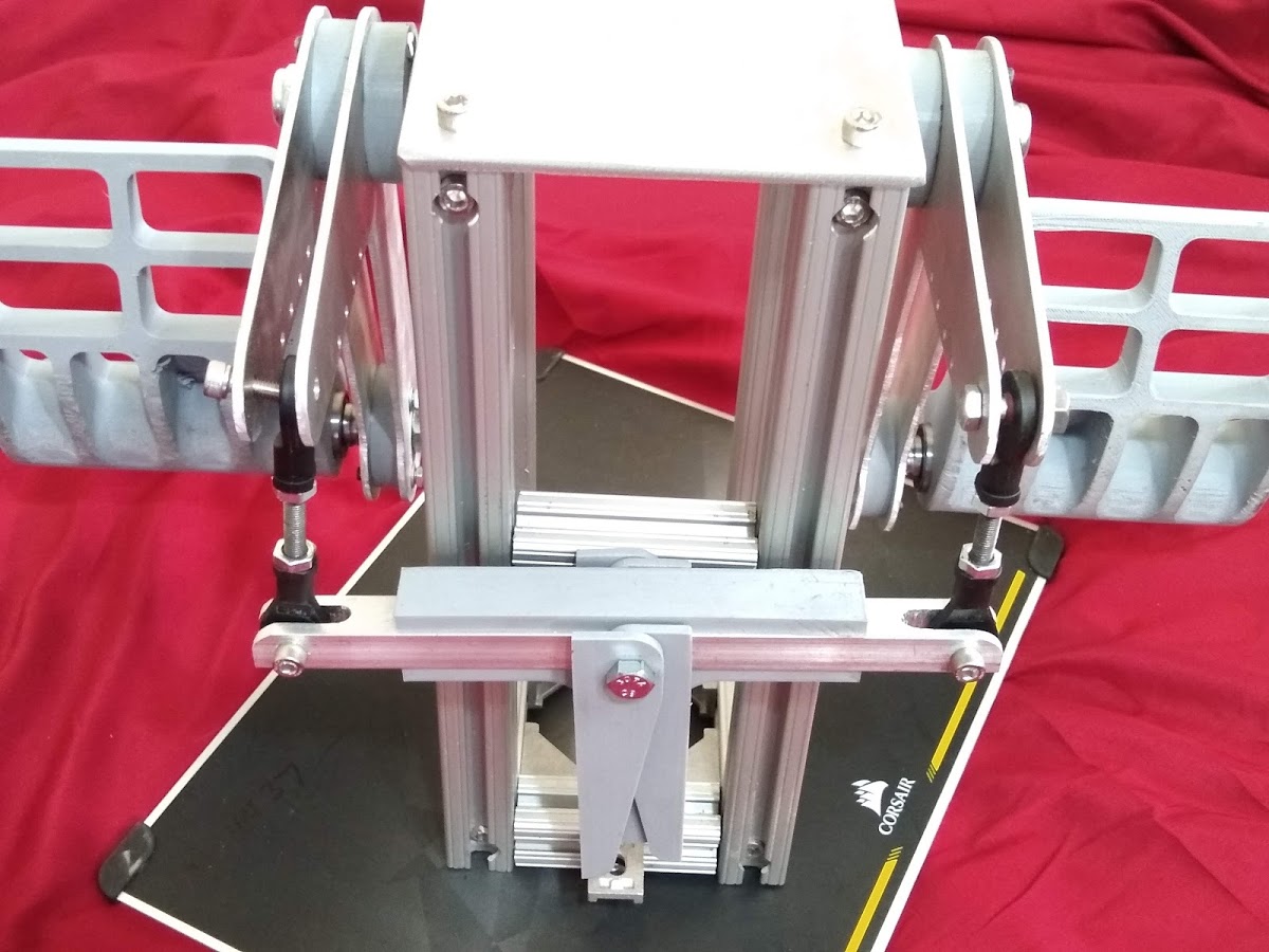

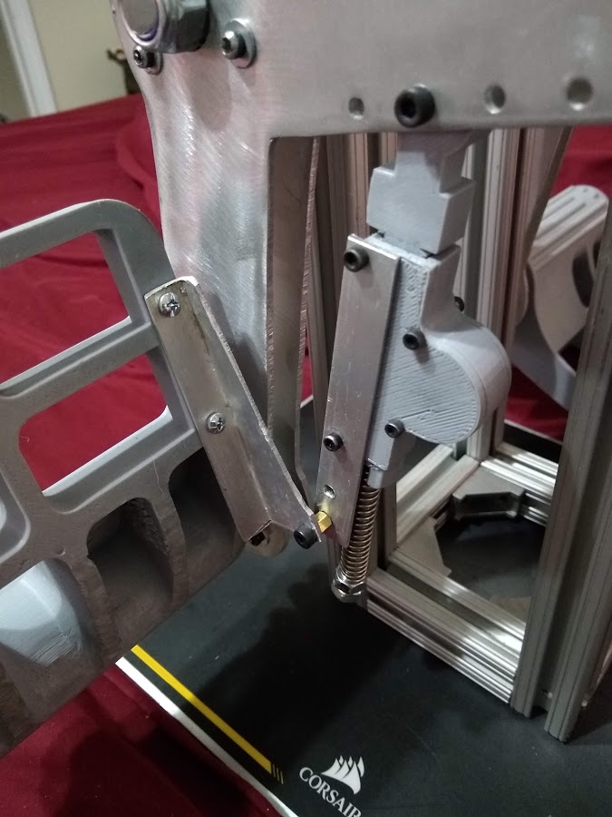

    The brake sensor assembly is done.
    I redid the rack stl. It includes the top disk.
    Thinned down the width a bit.
    To run the 1/4-20 rod throughout the rack you will still have to carefully drill out the hole.
    Keep in mind the drill bit will melt the plastic as it is drilling.
    Keep it cool with water or a WD-40 type oil.
    Most likely after adding the threaded rod the sides of the rack will bulge.
    Steel vs Plastic .. Steel wins every time.
    You will have to shave more plastic off the sides of the rack.
    Take off as little as possible for a smooth fit.
    You should be able to sight down the rack and see the bulge.
    Rack.zip is the stl file.
    Picture time :popcorn:popcorn

    Yea its an experiment. I upped the perimeter shell by one and went with 50% infill for strength.
    Pet-g is pretty strong we will see if it holds up.
    I rarely even use the brakes except to turn in taxing.
    I was playing around in Tinkercad so I figured what the heck...

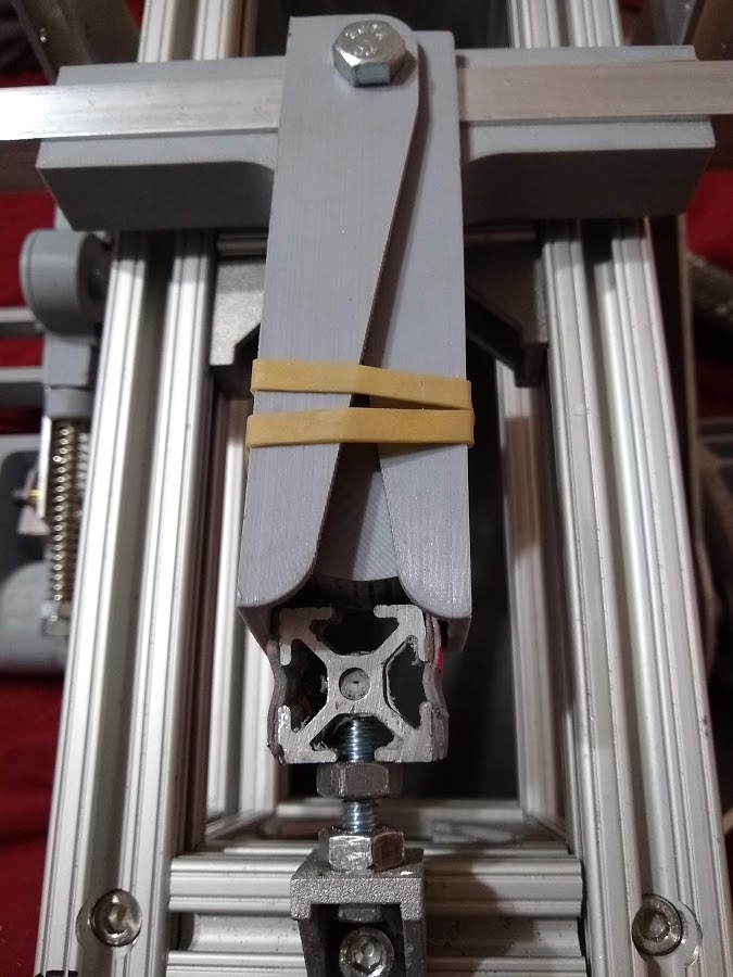

    I made the lever stop out of a scrap piece on the 80/20.
    I added 2 layers of foam tape to each side to space it out a little.
    The rubberband (#64 of course) works pretty good:).
    Sliding it up and down changes the pedal tension...
    I will most likely go with springs later.
  18. T R Para
    Oct 18, 2018
    385
    Cincinnati, Oh
    2,447Coins
    +358 / 3 / -0
    AC motor, 6DOF

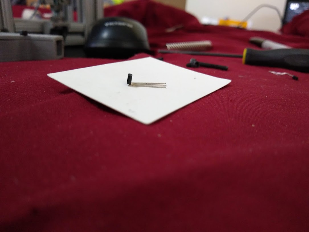

    Finished up the brakes today.
    Picture shows how I left the cover off the sensor assembly to calibrate the hall sensor.
    Next picture shows how the hall sensor leads are bent to allow the front of the hall sensor to face the magnet.
    I did open up the slot in the hall sensor cover to allow the leads to exit more easily.
    The Interface board I am using is an Arduino ProMicro.
    An Arduino Leonardo could also be used.
    The sketch is below.
    I also have included the Joystick Library which is needed.
    And the beat goes on..

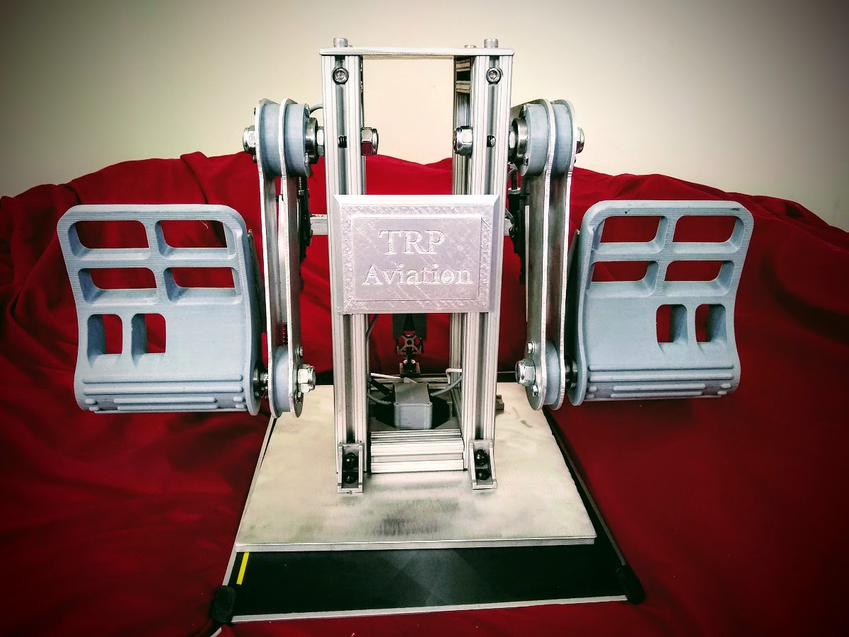

  20. T R Para
    Oct 18, 2018
    385
    Cincinnati, Oh
    2,447Coins
    +358 / 3 / -0
    AC motor, 6DOF
    Everything is done and working.
    Thanks again out to Historiker for the awesome project.
