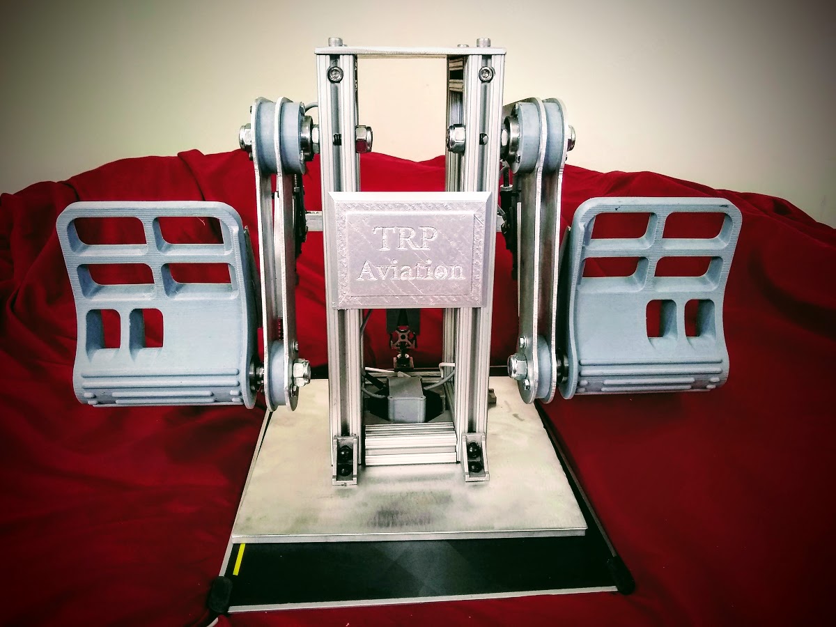

  8. erocfx
    erocfx New Member
    Aug 25, 2020
    11
    87Coins
    This is a great project! I think I might try to build a set. I think I have all the info from this thread. Is there a BOM for all the mechanical parts?
  9. T R Para
    T R Para i make stuff up
    Oct 18, 2018
    385
    Cincinnati, Oh
    2,447Coins
    +358 / 3 / -0
    AC motor, 6DOF
    I do not have a BOM.. A majority of the metal materials are listed on page 2 and 3. The levers are cut from a single piece of 12"x 24" x .125" aluminum plate. The Base plate is made from 10" x 10" x .25" aluminum plate. The frame is made from 2020 T Slot Aluminum Extrusion. A list of some of the bearings are...
    4 total 12mm x 28mm x 8mm Bearings for pedals
    2 total 12mm x 32mm x 10mm bearing upper L arm
    2 total 8mm x 22mm x 7 mm Skate Board bearings .
    As Historiker mentioned to me it is not a step by step construction thread but there is enough information here to build the project. And we are both here to help answer any questions. I would start by cutting the levers out of .125" or 3mm aluminum,start printing the necessary plastic parts and you should start seeing exactly how the build goes..
    Hope this helps..:)

  12. erocfx
    erocfx New Member
    Aug 25, 2020
    11
    87Coins
    What size are the bolts for the pedals and the L levers?
  13. T R Para
    Oct 18, 2018
    385
    Cincinnati, Oh
    2,447Coins
    +358 / 3 / -0
    AC motor, 6DOF
    Pedal bolts are approximately 150mm long and are 12mm bolts. I used nuts that have the nylon shakeproof ends...
    on the L levers I used 12mm threaded rod with again shake proof nuts on each side. The rod looks to be 94mm long. Cut to length with a dremel cutoff wheel. I most likely did not have the proper length of bolt.

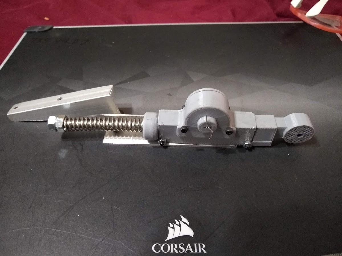

  16. erocfx
    erocfx New Member
    Aug 25, 2020
    11
    87Coins
    How does the bolt or rod that holds the spring on attach?[​IMG]
  17. T R Para
    Oct 18, 2018
    385
    Cincinnati, Oh
    2,447Coins
    +358 / 3 / -0
    AC motor, 6DOF
    There is a hole in the end of the rack.. Tap it for 1/4 - 20 threaded rod. Two jam nuts adjust for spring tension ..the 1/4-20 rod is about 3.75" long.. But cut to suit.... The spring is a compression type. I got them at a hardware store.
