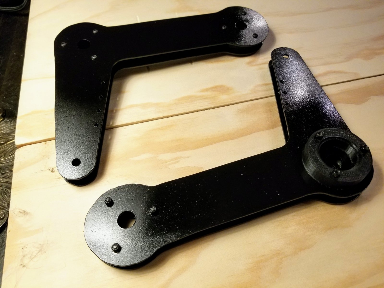

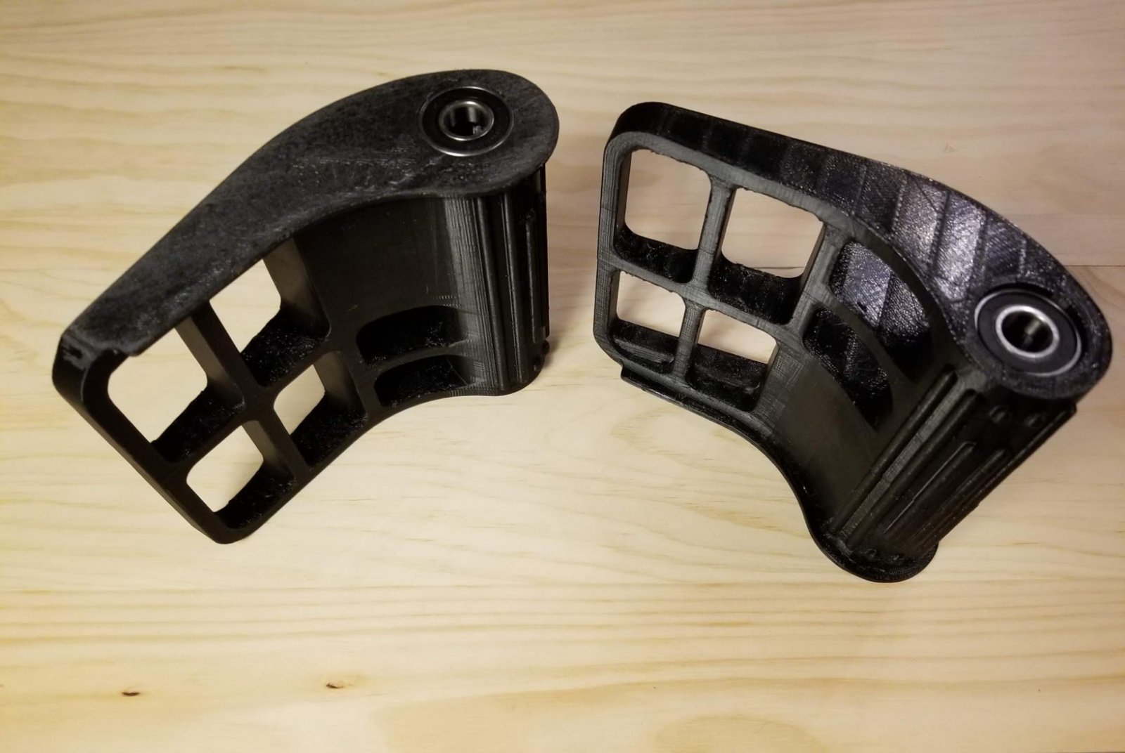

    20200912_163229.jpg These are the L-levers I built. Held together with M3-20mm and M3-30mm bolts.

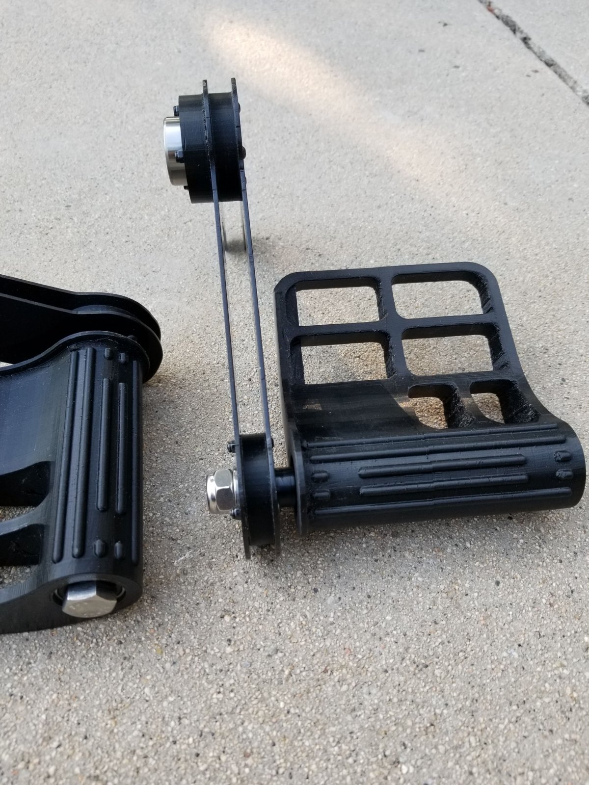

    Pedals with 12mm x 28mm x 8mm bearings. Printed PLA on Dremel 3D20 printer. Sliced with Dremel Digilab v1.2.3 Pedals 01.jpg software (CURA).

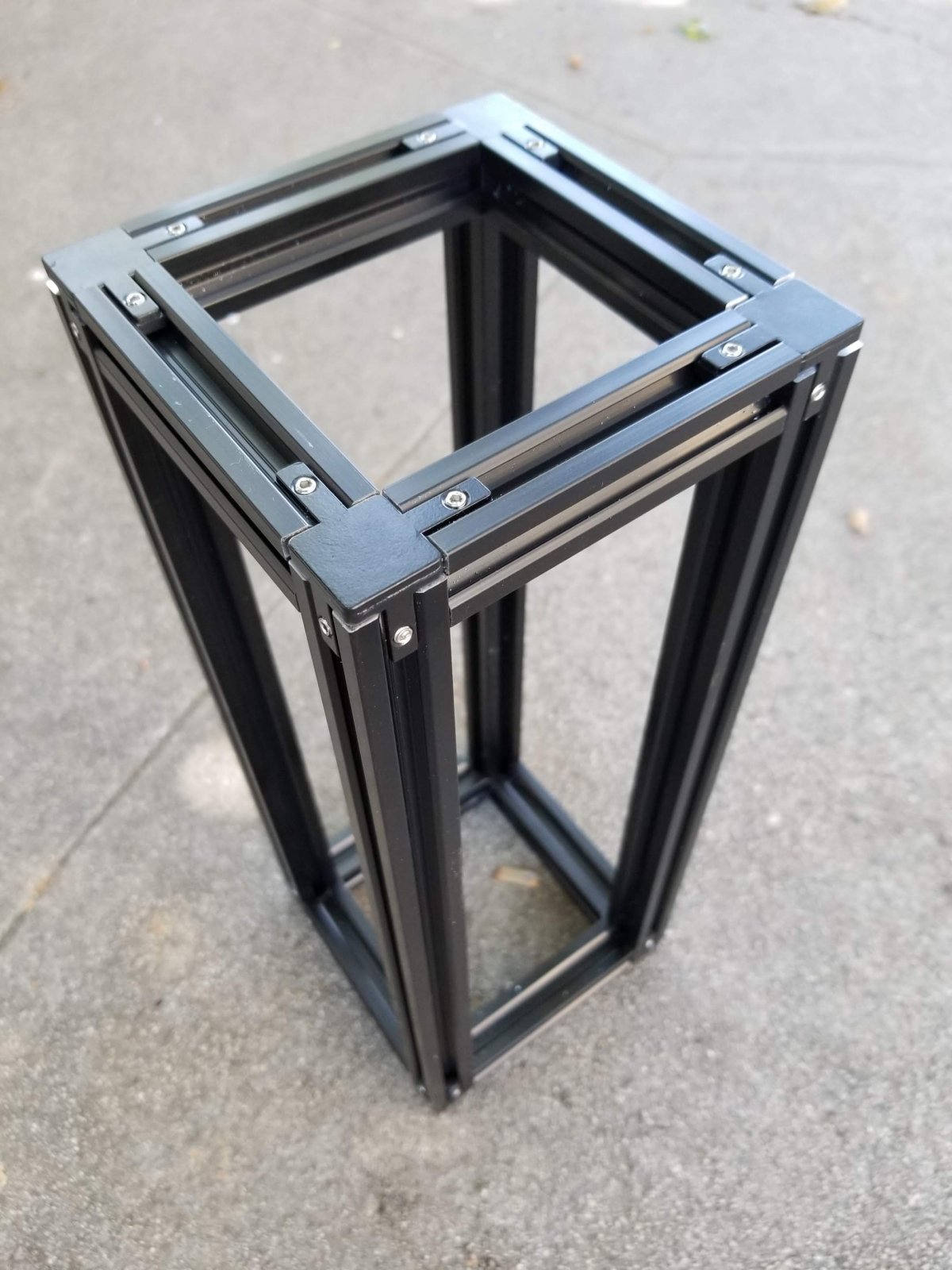

    Basic frame made with black anodize 2020 extruded aluminum. Black end corner brackets.
    Vertical pieces are 320mm. Horizontal pieces are 85mm.

    Pedal bolted to L-levers.
    (2) 160mm 12mm x 1.75mm stainless steel Axel bolts.
    (2) 12mm x 10mm nylon spacers.
    (2) 12mm x 1.75mm stainless steel locking nuts.
    (2) 12mm stainless steel washers.
    (2) 12mm x 32mm x 10mm bearings
