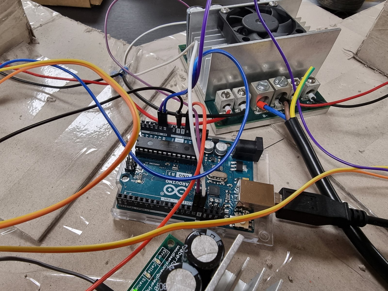

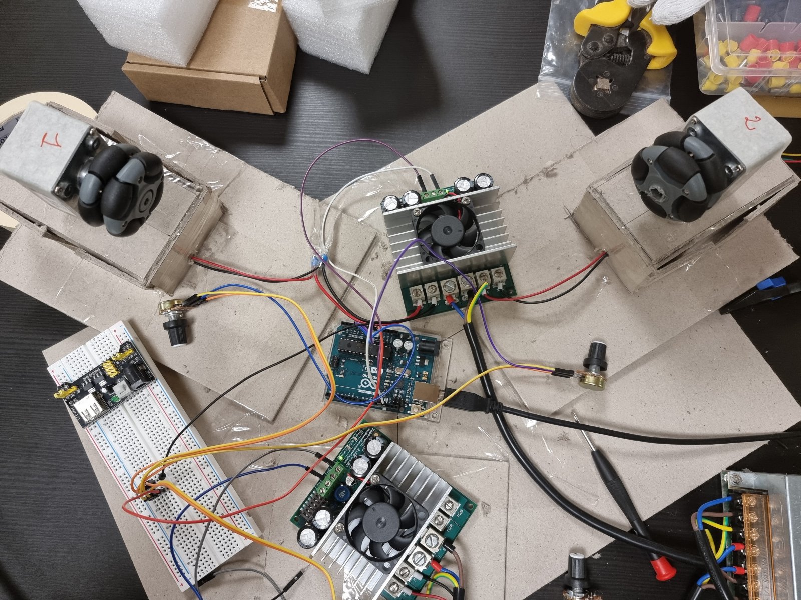

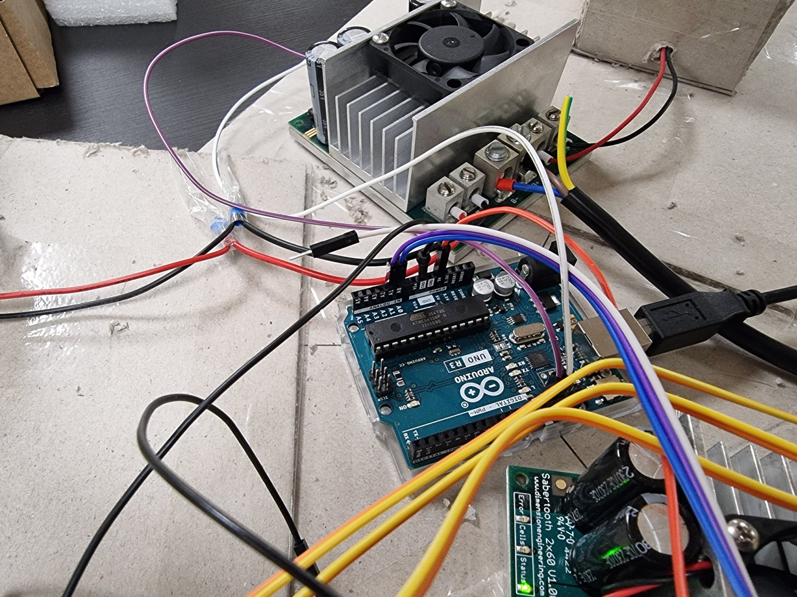

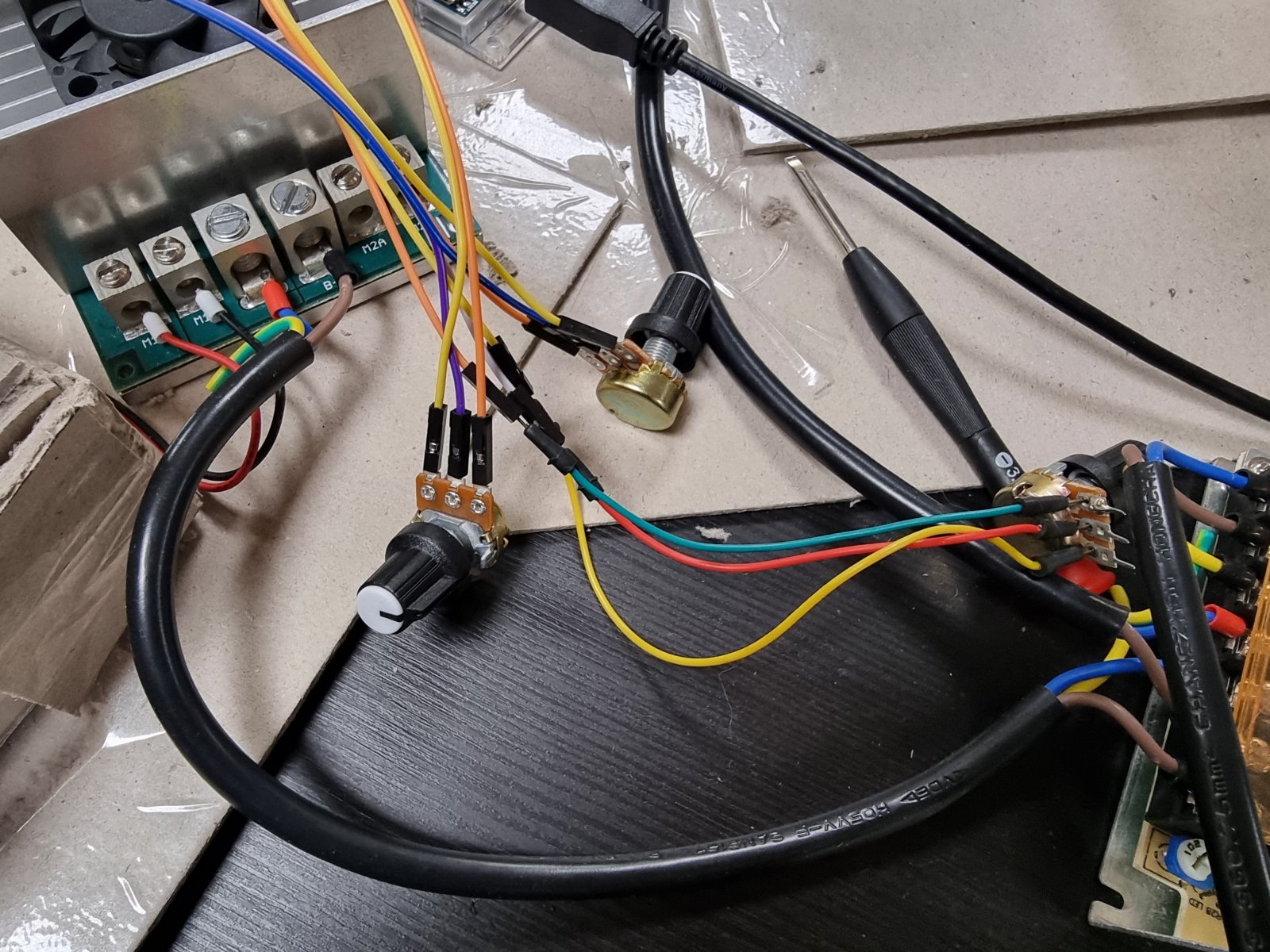

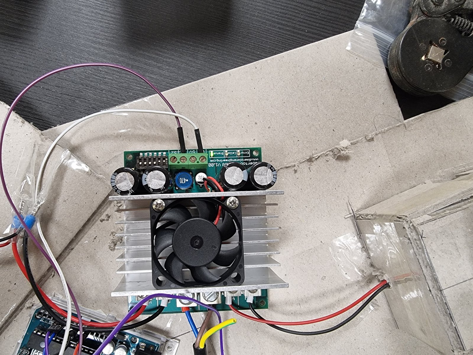

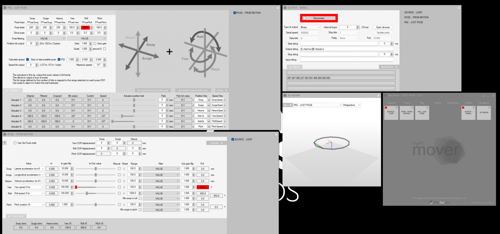

    Hi, here a quick update. So I changed a bit the configuration and I managed to make flypt and my system to talk. I can kind of control on single motor per time but I cannot control 2 a the same time. I tried various settings and the way they activate it is weird. Not sure if I am doing something wrong in the wiring or somewhere else. SMC3 runs perfectly though. I get perfect response from both the motors and the POT.
    I think I need some help from @pmvcda
    Here some pics of the setup and screenshot of the settings for FLYPT. I try different keys metod in the output string. No luck of using 2 motors in parallel. Only one.

    I tried to see a bad connection in your set up but I could not find one.
    Make sure that when turning your pot, you don't reach the max limits that will stops your motor.
    Nothing else to say as the pots are not controlled by the wheels' position. It is an unusual setup.

    I found some code online regarding it. That is going to be add later on to the setup. Now the first steps is to make all the connection working properly and understand how generally all the system is working with flypt or with simtools. So far i am not getting much luck. I have problem already connecting 2 motors with one 2x60 sabertooth and i am not sure why since i followed the instruction found here on this forum.
    Not sure what to do now.

    Yes. Also I discorvered in my system i had a major issue. My pot were not connected mechanically to the motors. It was actually very logical as solution. So that is why they were keep spinning without control.
