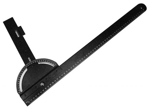

    The way I mount my diy shaker to the chair is very simple and effective. I'll use an office chair as an example to explain what I do. I use a metal plate/ bar approx 400 mm x 40 mm x 4mm, (in fact its an old angle finder I had lying around) , which is just sandwiched tightly between the base of the chair and the um, gas lift mounting plate. Drilled a suitable hole and fixed the transducer to it. Due to the size of my diy (12" 300 watt sony sub woofer") shaker it sticks out from the back of the chair but I think this helps a lot with sending the vibration to the seat. Hope that makes sense.
