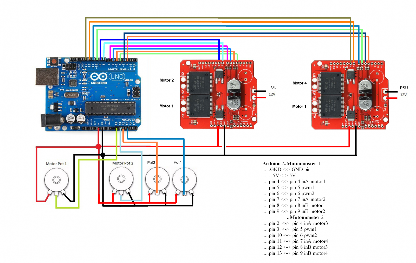

    but if i also wanted to add the third motor for the traction loss can i use this scheme by connecting only the 3 motor? thanks

    I would like to do something like this because it is a great job

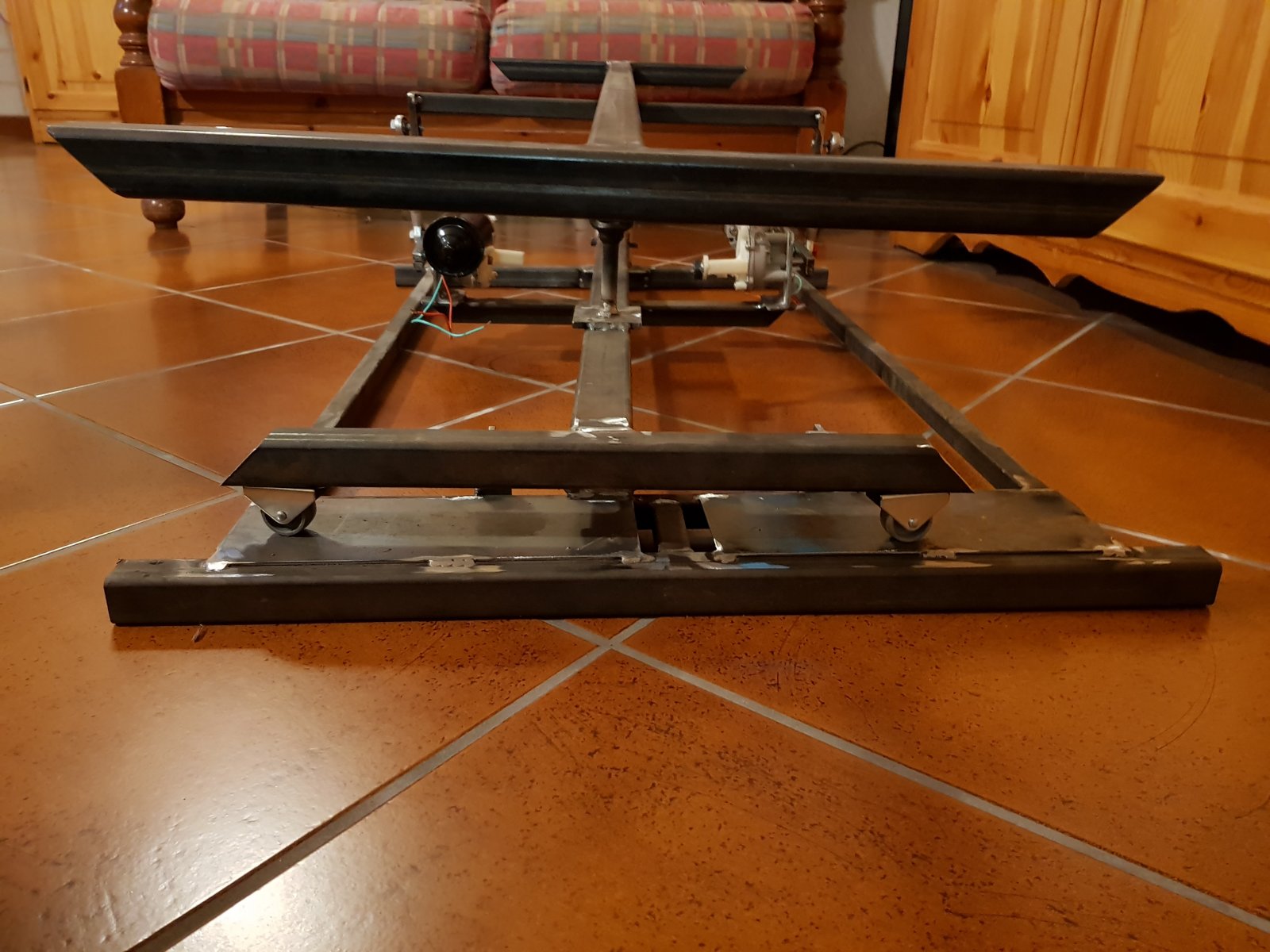

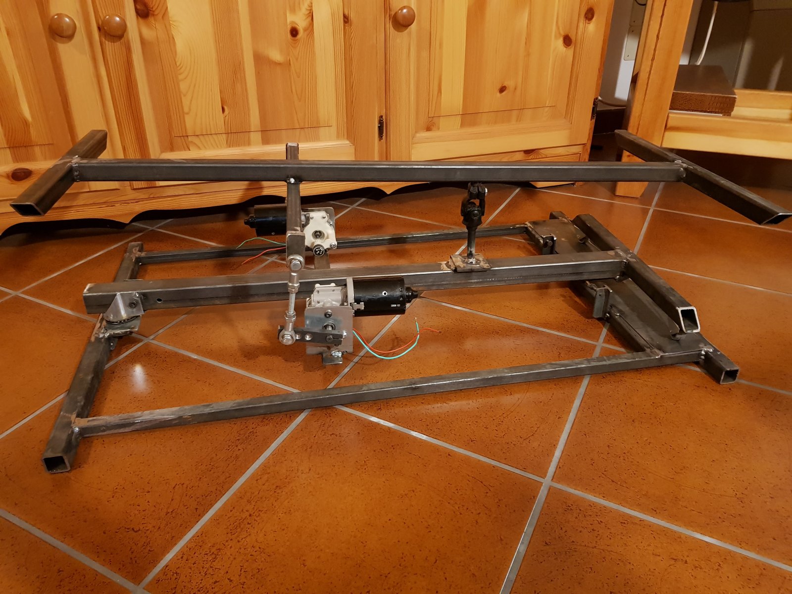

    somebody help me. I have problems with the motors or when I try to push them down they deactivate and do not return to the central position. making the motors move in hand with Smc3 do their job. also in the central position they jump a bit. who gives me some indication to solve? in fact when seated, if you lean too far forward with your body weight, they do not return to the center. I am attaching the videos to better understand

    this is my 3dof with traction loss. help me fof my problem. thanks

    when I press hard on the engine he disconnects and doesn't return to the position anyways. I see the yellow line which should be the engine. come posso risolvere

    Are you pushing past the SMC3 boundary limits, as it will disable if you do that.

    but you say it's normal? i also tried without opening smc3 and it does the same thing. I'm afraid what happens when I put on the seat and sit on it.

    nothing to do I tried with the seat on and as soon as the weight of the body shifts and I risk falling and the kotori do not manage to rest in the center position. maybe the distance of the motors from the center is wrong and they don't make it?

    I suspect part of the issue is that you look to have a compact design with limited design leverage, which requires lots of torque, but are using what looks to be very long CTC levers.
    What is the gear ratio?
