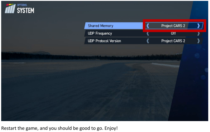

    In Project Cars 2 there is a setting that needs to be turned on for the simulator to get information from the
    game. The setting is called “Shared Memory” and it needs to be set to “Project CARS 2”.

    Thank you, is it for 3DOF or 2DOF? I wonder why my sim wont move at all.

    This should work for both 2DOF and 3DOF. There are a few ED plugin profiles. Make sure you use the one dated Apr 17th 2018 and re-patch the game, the other older versions from 2017 wont work.

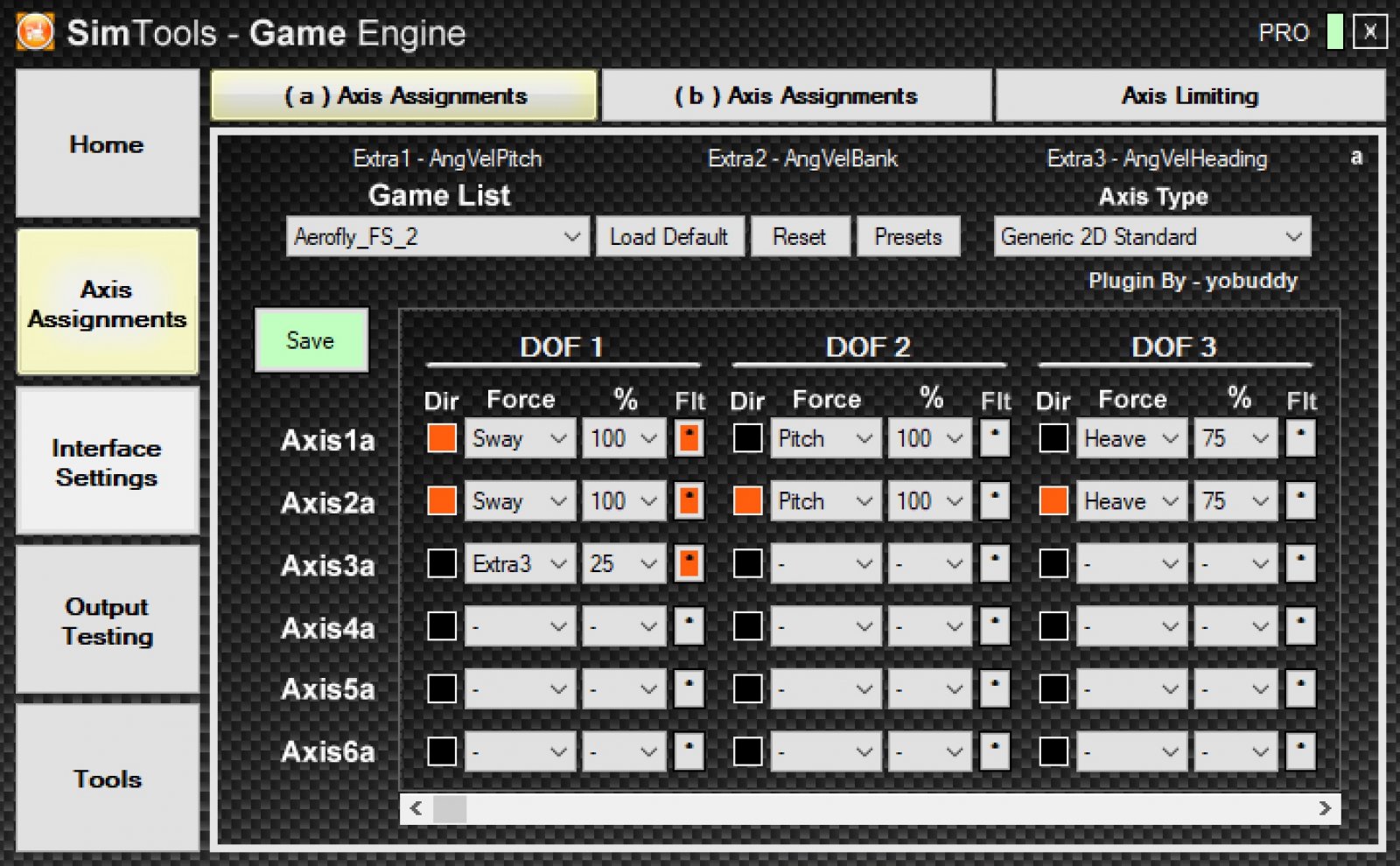

    Adding axis and tuning profiles for Aerofly FS2. Please note that I've attached two separate axis profiles. One is for passenger planes, and the other is for fighters and acrobat planes. I'm listing some details below:
    -Passenger profile: (uses Sway DOF for roll)
    Axis filters: DOF1, axis1a & 2a=smoothing 25%; axis3a=smoothing 100%
    pros: maintains roll angle, better for simulation
    cons: rudder input generate too much Sway output, highly recommend using rudder pedals and avoid rudder controls on joysticks/throttles. A yoke is also recommended.
    -Fighter/Acrobat plane profile: (uses Extra 2 DOF for roll)
    Axis filters: DOF1, axis1a & 2a=smoothing 100%, gain=75%, return 60%; axis3a=smoothing 100%
    pros: less issue with using the rudder.
    cons: more of an arcade feel, roll angle will always reset back to zero and the seat becomes leveled even if you fly your plane at an angle.

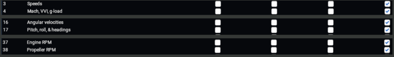

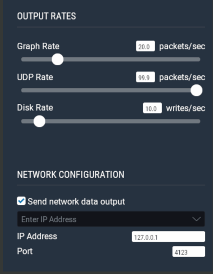

    To enable motion in X-Plane you need to tell the game what to output to SimTools. It only takes a few
    steps and a few minutes of your time. To enable it please go to Settings -> Data Output. In the row called
    Network via UDP tick row 3,4,16,17,37,38. See picture below.
    Then go to the right of the same window under Output Rates and Change UDP Rate to 99.9 and IP Address
    to 127.0.0.1 Just like the picture below.
    Click Done and restart the game.
    Now you have configured X-Plane to work with the simulator and you should be good to go. Remember to
    patch the game in SimTools also and configure your HOTAS. Thrustmaster Warthog works by default.

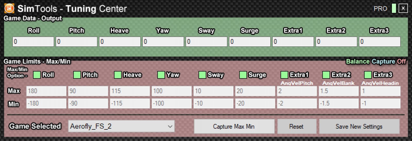

  11. IntrudR
    IntrudR New Member Gold Contributor
    Jun 13, 2018
    9
    124Coins

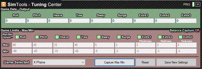

    Hi all
    I did some upgrade on my X-Plane 11 profile. It is much more better now because I learned how to use the tuning center ;-) So please check the tuning center for the same configuration as in the screenshot.
    Enjoy
    IntrudR

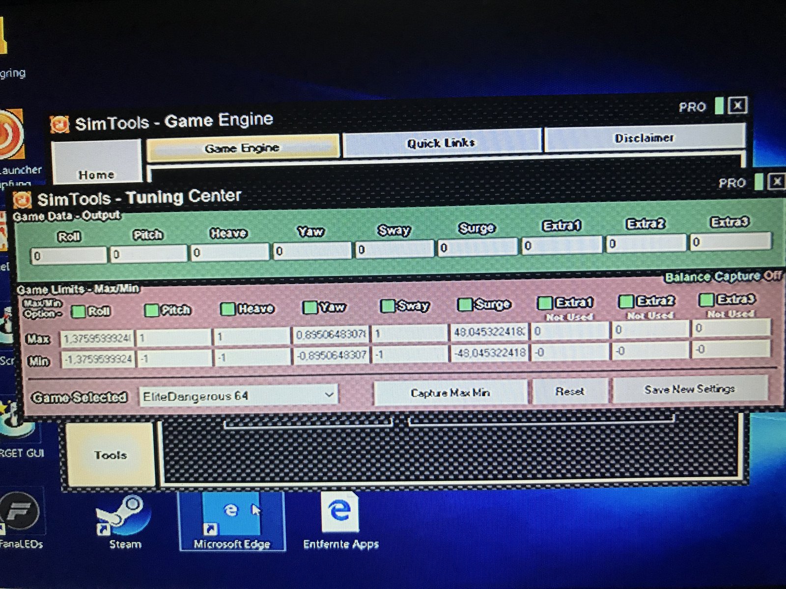

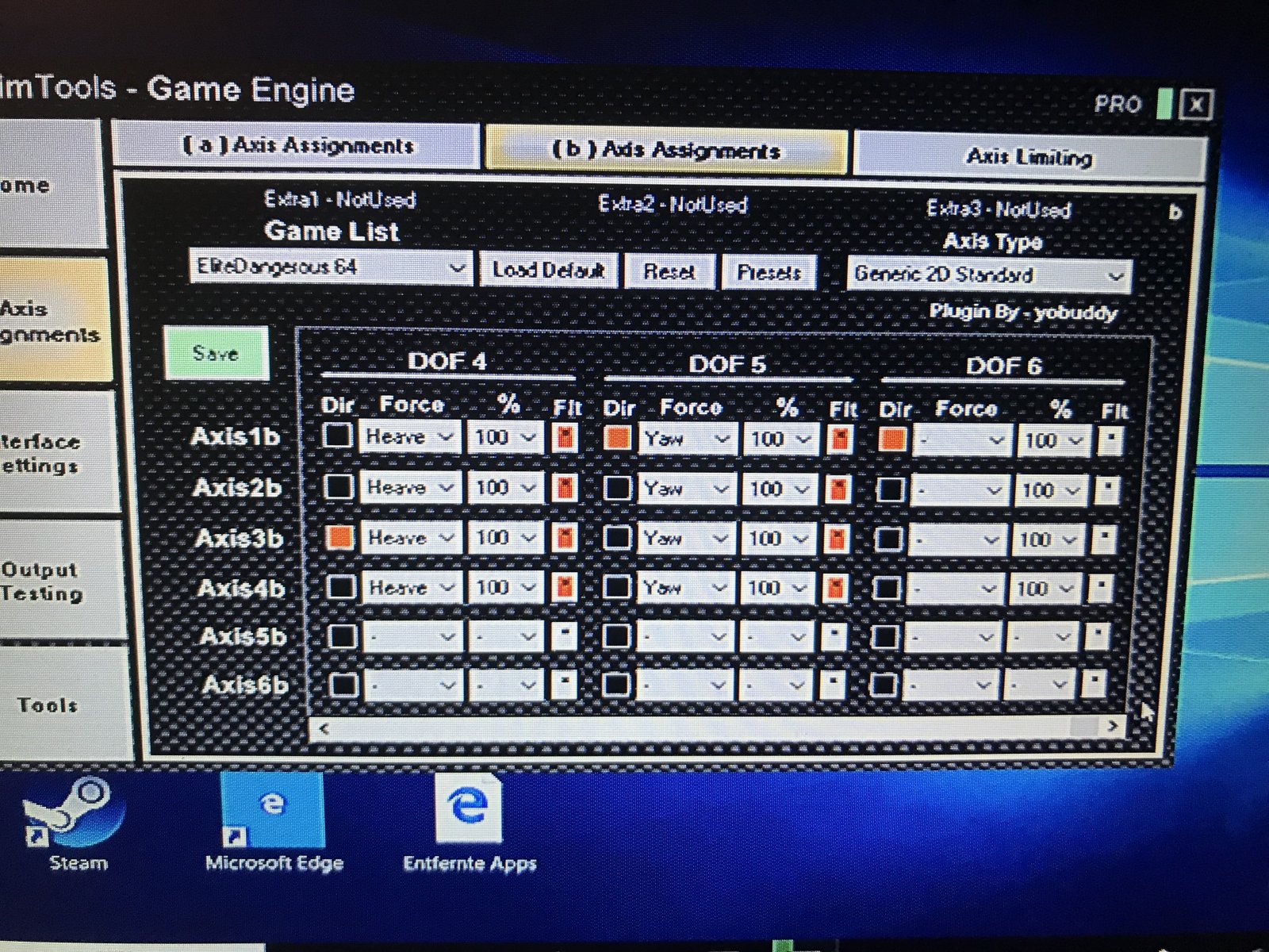

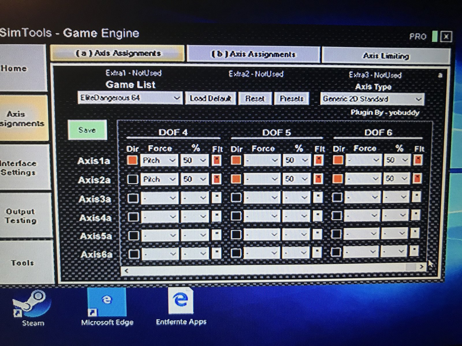

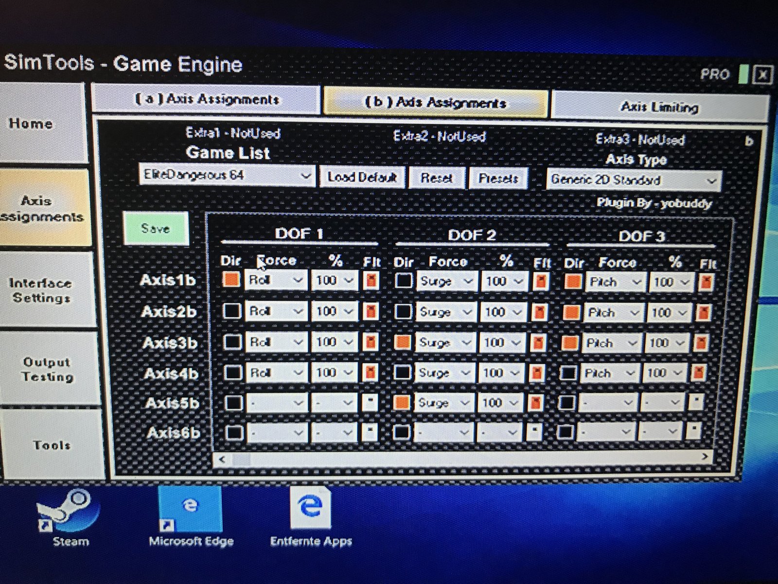

    ED
    [​IMG] [​IMG] [​IMG]
  18. splendiddd
    splendiddd Active Member
    Jun 13, 2009
    358
    CCTV security
    Netherlands
    813Coins
    +62 / 2 / -0
    ED, what filtering? smooth?

    Can you please share the file instead of screenshots?
    Thanks!

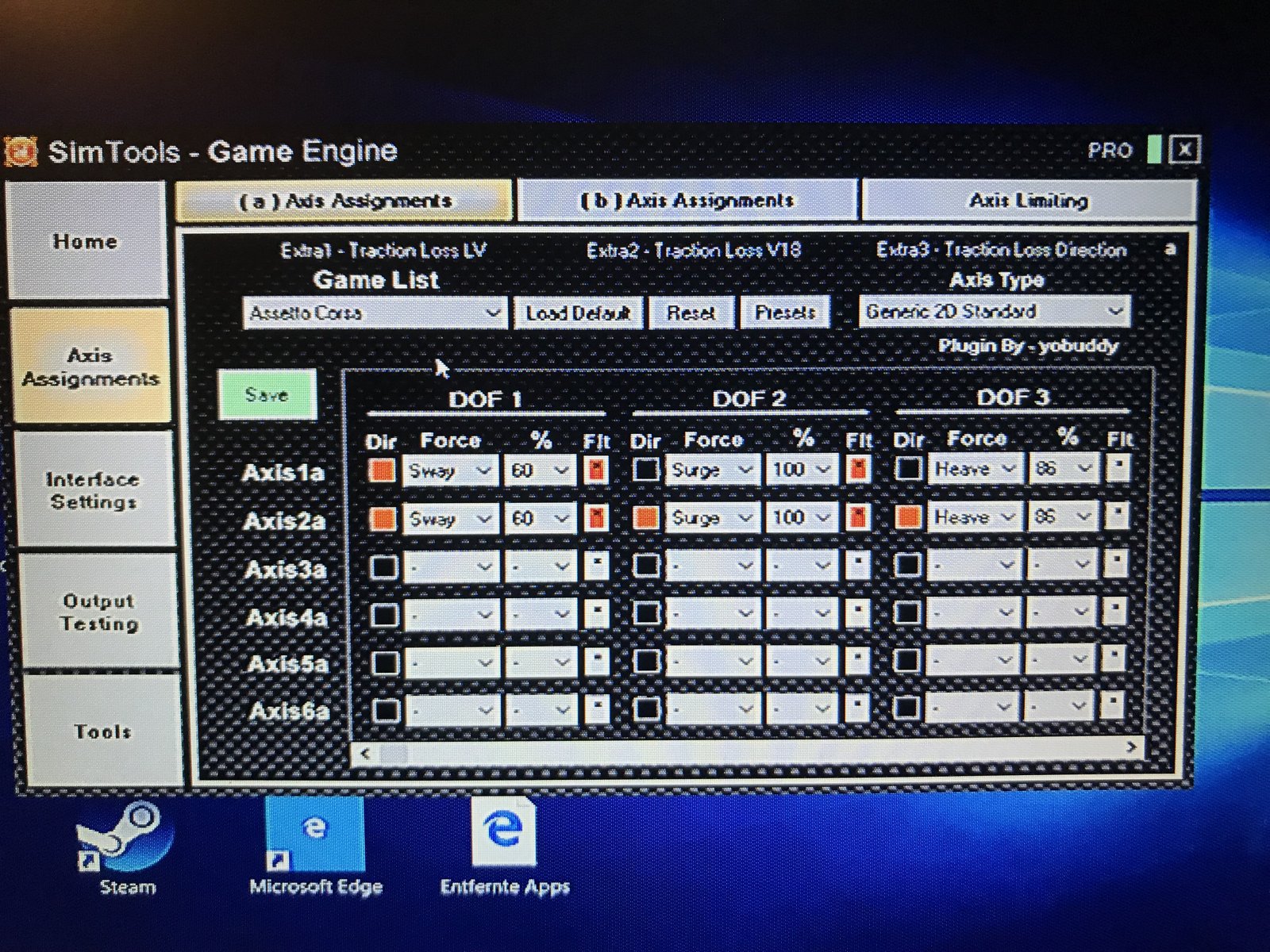

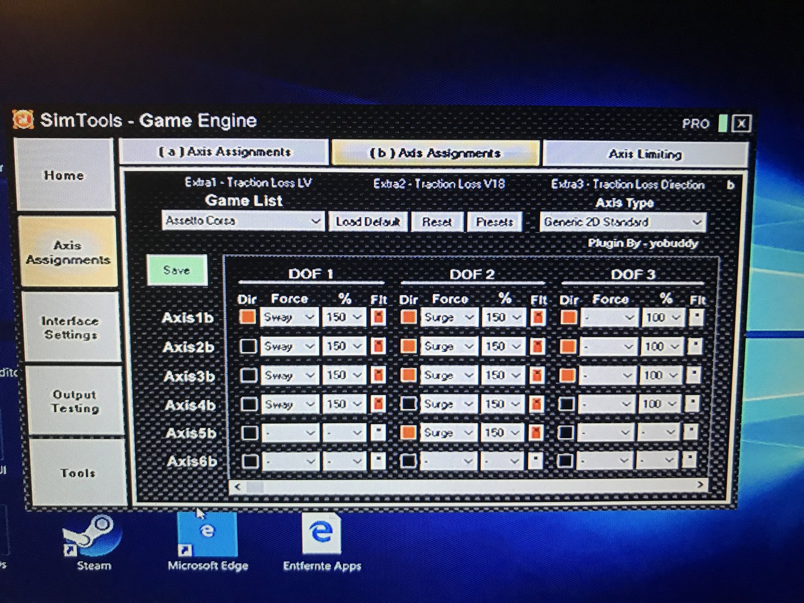

    My ED Tuning
